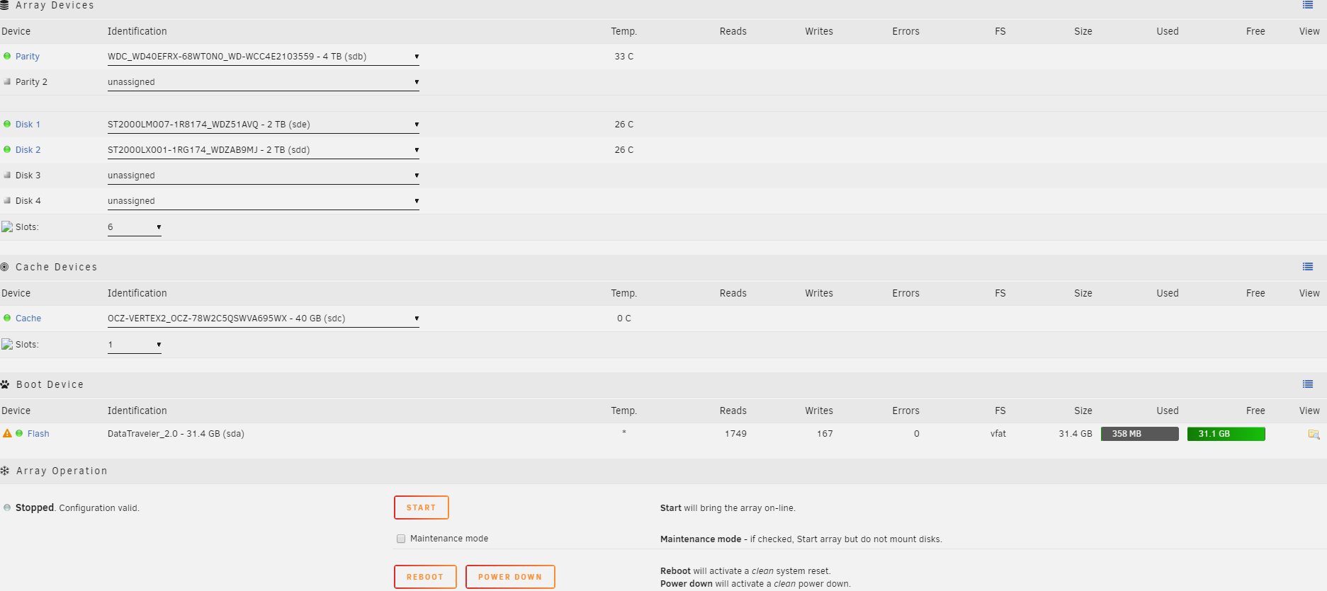

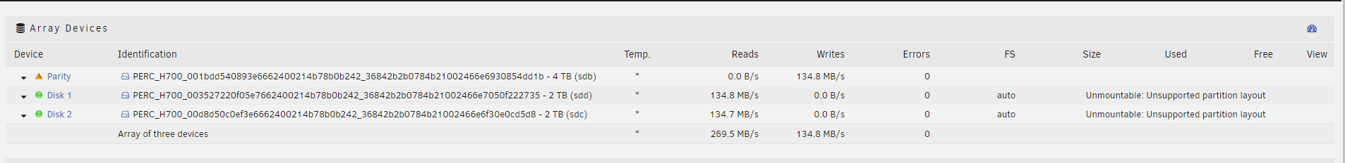

Essentially my drives had to be created into virtual disks (raid controller) which were fine and then when in the unraid OS I had to create a new config in order for the original array to be recognised. The drives were then recognised, however, two of the data drives (which still have data on them) have an issue where they are Unmountable due to "Unsupported partition layout" with a file system type of auto.
Attached are my diagnostics where a use option for smartctl is quoted. And images of my before and after disk layout.

That's one of the reason RAID controllers are not recommended, only option is to reformat the disks, you can copy the data before mounting them with UD.

So another issue now, it is saying the superblock is invalid. That is when trying to mount the drive using UD.
Edited by edmoisaa
That's more serious, you should try them on the same controller they were.
