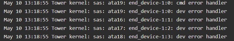

I'm not an expert in this diag stuff, do you see if my other disks (of the array) get issues with my disk controller?
I saw ata15.00 get a recurent problem
I saw too
What does it mean?
5 minutes ago, Florent73 said:
What does it mean?
That's normal and not a problem.
