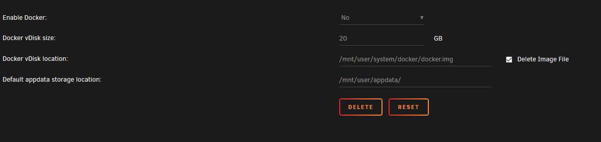

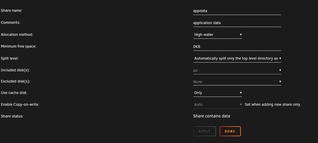

Anyways, on to the steps you provided.  I did a clean reboot. Docker services stopped and image deleted.
VMs Disabled
Appdata was "prefer" now "Only"
image.thumb.png.f5e7816557bf81fce356742bda445d6b.pngimage.thumb.png.f0dae47d0d6d3ab7f6739942bcb0d7a8.png
Mover is running now -- will report with fresh diagnostics when it finishes :)

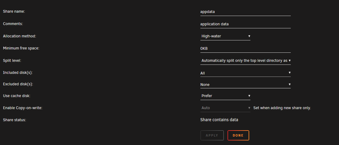

We can go ahead with the next part though, which is to get appdata moved to cache where it belongs.
Set appdata to cache-prefer then run mover. Wait for it to complete, check the user shares to see which disks they are using, and post new diagnostics.

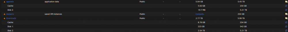

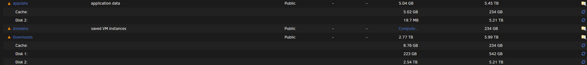

2 hours ago, trurl said:
These new diagnostics show you still have some of Downloads share on cache, but cache has a lot of room now. The last thing in the syslog is mover starting. Are you sure it completed?
You can see which disks are used by each share by going to User Shares and clicking on Compute... or use the Compute All button. It may take a while to get a result. If you don't get any results after a while try refreshing the screen.
Here is a quick screenshot of that.  I have to head off to work, but I have appdata cache-prefer and mover is running.  Will report back when I get home.
appdata is all on cache now, but Downloads still has some on cache. Possibly these are duplicates of files on the array. You might turn on Mover Logging and try to move again so we can see what it says about that stuff that won't move.
