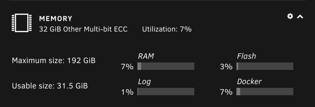

I noticed a small annoyance with 6.7; It says Other when it should say DDR3.
Looks to be a problem with how it is reading your hardware:
1443533792_ScreenShot2019-05-19at11_28_21AM.png.64309bbb704731a483aa6a2bb6fa89aa.png103205653_ScreenShot2019-05-19at11_27_41AM.png.d81a6975eb198a275c63ac5ac92af5aa.png
