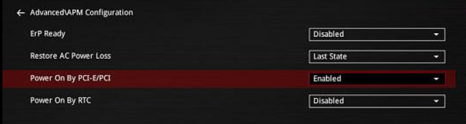

So I did add "ethtool -s eth0 wol g" (without quotes) to my go file however it does not work :-( Maybe I am doing something wrong.
As to my BIOS settings being incorrect, I really doubt it - see attached image, there really isn't that much to configure and again this started to happen once i upgraded to 6.7
