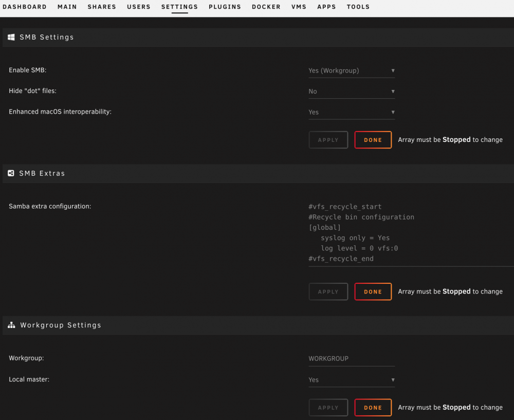

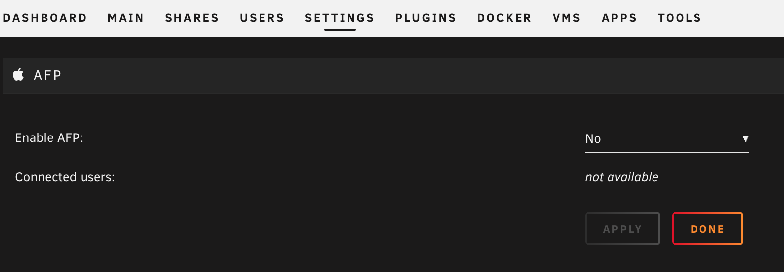

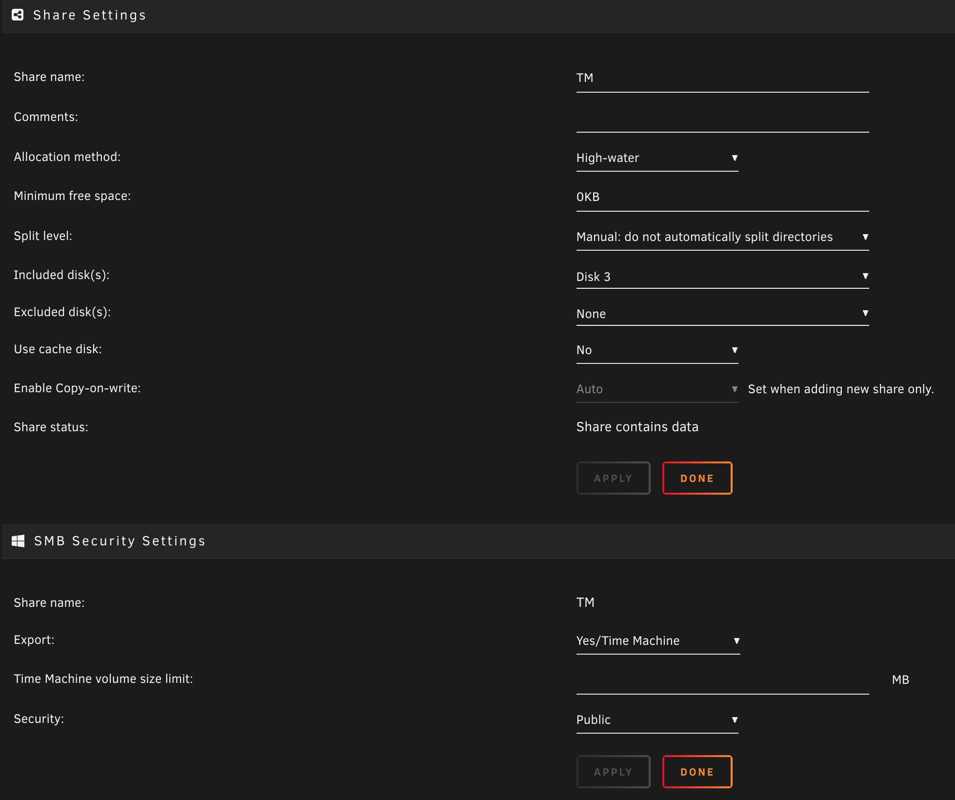

UPDATE: I was able to backup my Macbook Pro. See below on how I have it setup in case someone needs help to get theirs fix. Make sure you connect to the server before the backup shows up available under Time Machine. Click on Go and then go to Connect To Server. Once you have done that successfully you will see the name of the share come up and you can select it and walah. If it does not finish or it stops. It could be a corrupter file or program. What i used to resolve this issue was CleanMyMac X and it worked like a charm for me. If you know of any other software that works please post them for others to try. Hope the way i did it works for anyone else.
Thank you for the update and screen shots!  And for your patience as we worked through this.

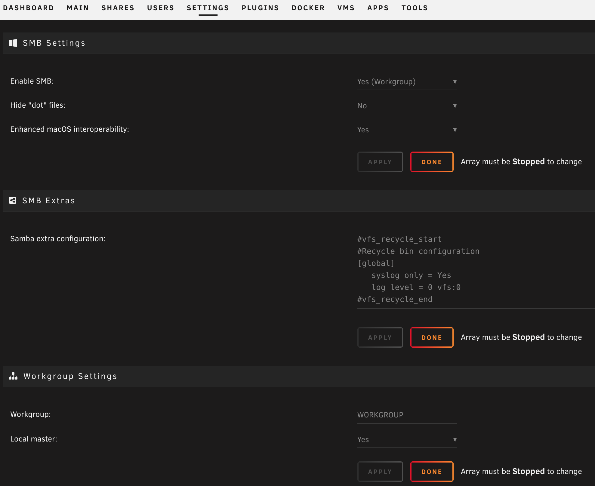

Not really related to Time Machine but I would recommend setting the "Hide "dot" files" to "yes". Otherwise you'll see the ".DS_Store" files that macOS likes to put all over the place. I used to compulsively delete them since my home is a mixed environment.  This option keeps me from feeling the need to do that.
You can stop macOS devices from creating those things:
https://www.tekrevue.com/tip/stop-ds-store-files-mac-network/
