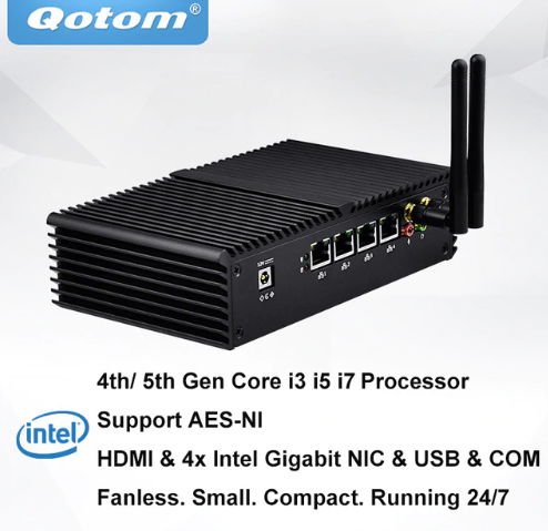

If you plan on making an all-in-one router device with pfSense with something like that you have to keep in mind that because it's based on FreeBSD you're limited to 802.11n. No support for 802.11ac and from the looks of it no plans for it. Still an interesting looking computer.
Availability of radios for this specific box not withstanding, I abide by my recommendation here.
