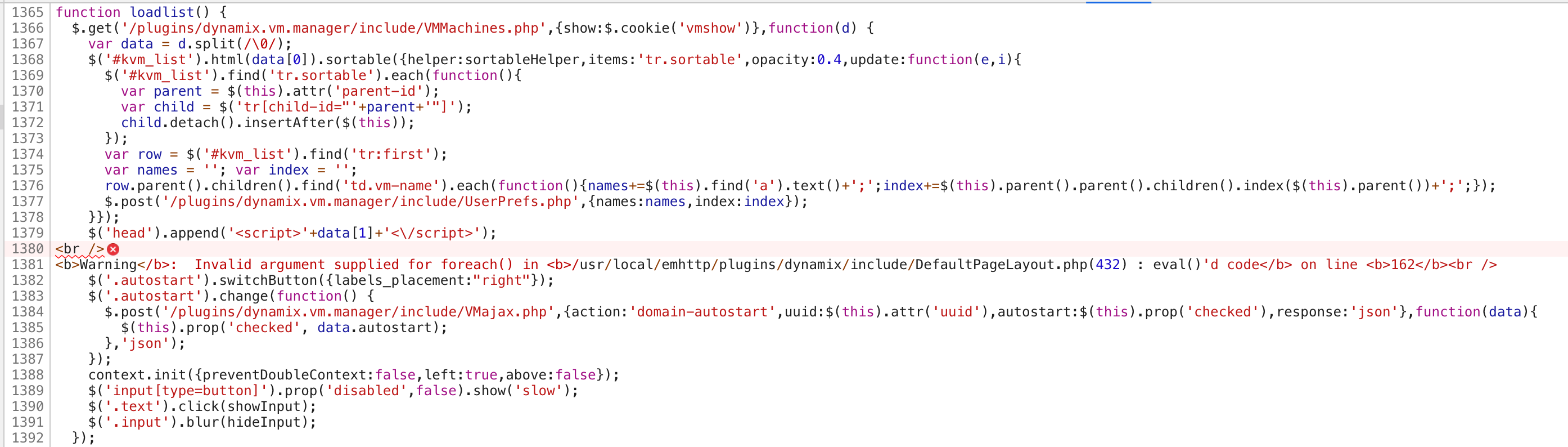

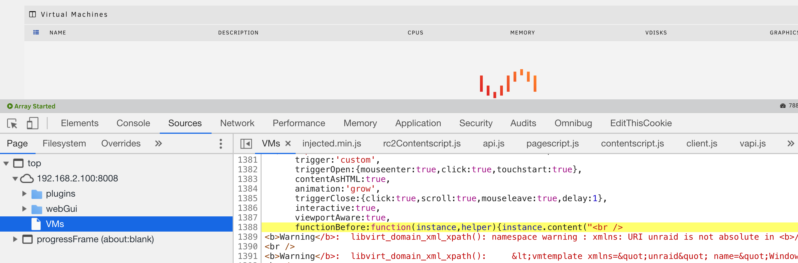

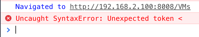

I get an unhandled exception error in the console:

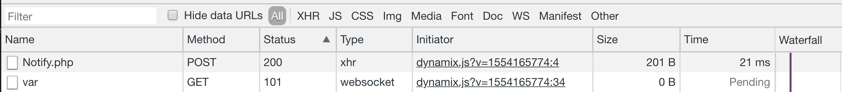

I also see that the /sub/var call is permanently pending... but I think that is intended for websockets:

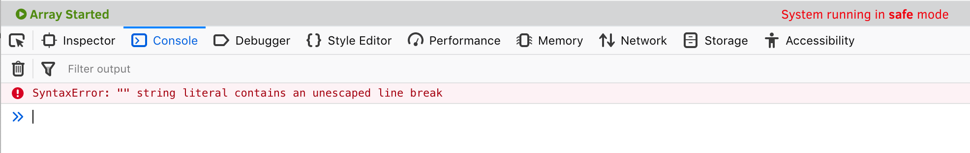

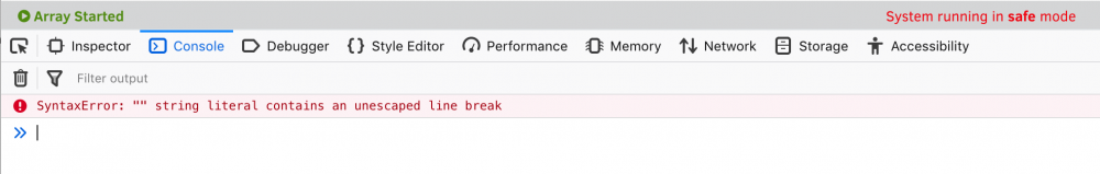

Same issue across all browsers and devices in safe mode. I did notice that Firefox gives a slightly more descriptive console error:

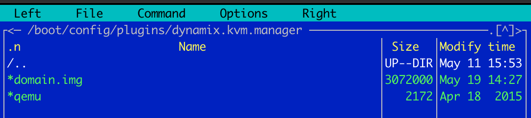

I think I may have found the cuprit... I noticed this in the dynamix.kvm.manager plugin. Is this an old img file that is being restored automatically perhaps? I cracked open the domain.img directly and I do see references to those old paths that are no longer used.
Is this plugin deprecated? Should I just remove it from the plugins folder? I see another one called dynamix.vm.manager but theres nothing in it.
Edited by johnsanc

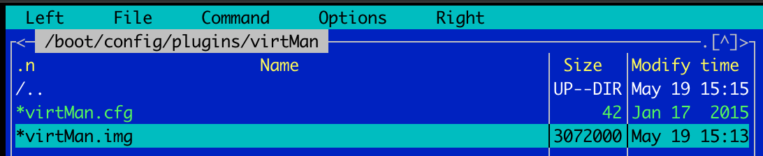

Done... but now its auto-creating and pulling something even OLDER from when I had a windows 8.1 VM. Looks like this one is coming from the virtMan plugin... I assume this can be deleted too?
(It would be really nice if Fix Common Problems flagged stuff like this)

Unraid 6 uses "dynamix.vm.manager"
