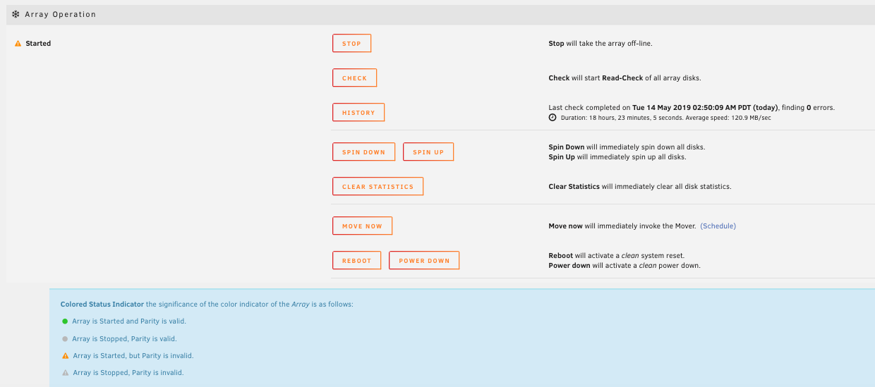

Looking for some guidence on why my parity is showing as invalid.  Been running unraid for 2 years now, no real issues.  just noticed that I got the orange triangle.  Did a manual scan last night and it has 0 errors.
Only thing I can think of is that I put an old drive in a while back and it failed, (no data on it) I was just adding it to the system for eventual use.  IF that's the reason, can I not simply remove the drive from the array since there's no data on it with out blowing everything up?  Never removed a drive in unraid before.

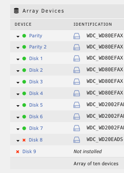

Parity isn't invalid, the triangle is warning you about disks 8 and 9 being disabled.

got it, thank you.  There's no easy way to remove that correct?
You'll need to rebuild both disks (or remove them from the array with a new config, losing all data still there)
I never added any data to those disks.  I installed them, forgot about them and when SMART ran it found they were bad.  so I disabled them.
Doing a new config would be wiping everything?  I remember reading about it, but not fulling understanding if I was going to lose everything.  I'm guessing based on what I remember, and your comment.  That doing so would allow me to remove the disks, but the whole thing would need to rebuild from parity less the disks I removed, and would take what ever amount of time unraid does for my data set (30hrs).
No, data will remain on the re-assigned disks, will lose just any data on the disks removed from the array.
