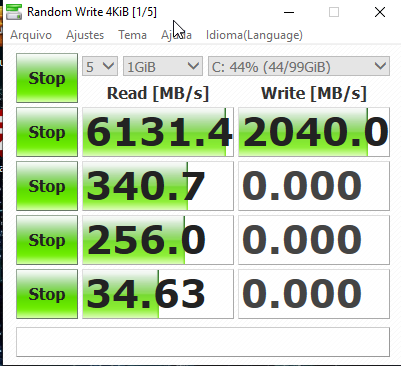

I have an OSX Sierra VM and I installed on a unassigned device with raw .img and Im having VERY slow write speeds.
I start the disk speed test and the speeds are great like 500mb/s but in seconds it drops to 80mb/s and 60mb/s and going down until get read at 8mb/s and writes at 6.2mb/s.
I already tried to chance cache from writeback to none and unsafe and native IO the start perfomance is the best with io='native'  on the disk but it get slow after during the test.

I'm performing a disk speed test in my VM
