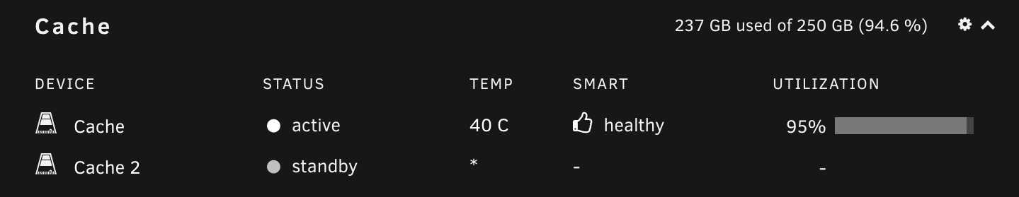

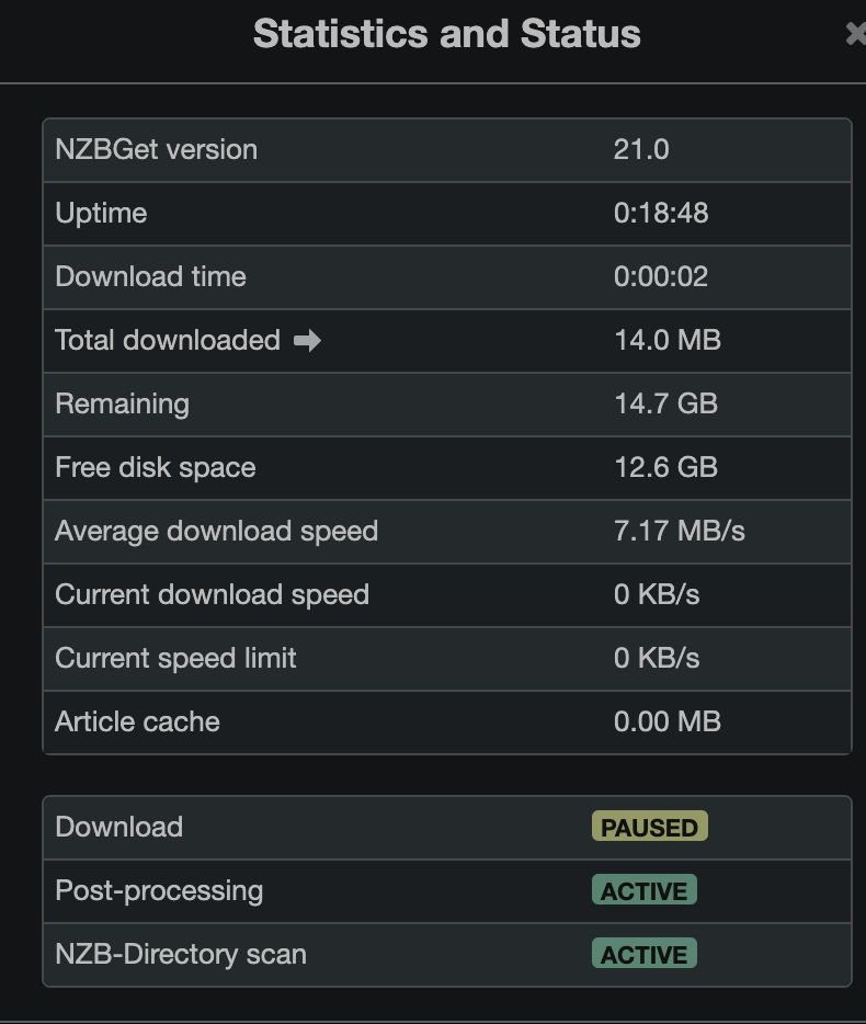

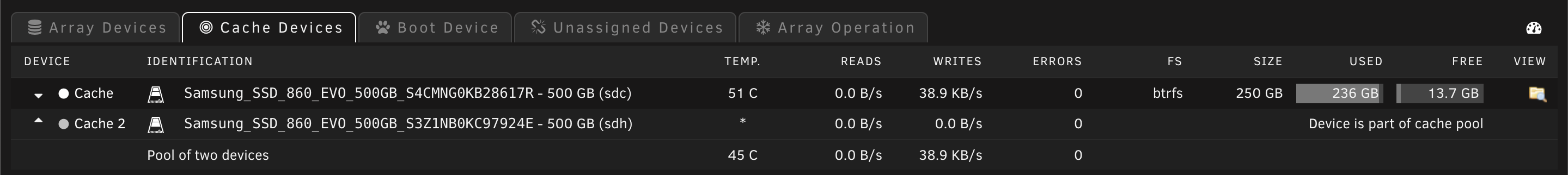

Can you post a screenshot of the main GUI page?
main gui of cache and nzbget stats are attached both showing 250GB with 13gb left
also dashboard shows cache 2 in pool is in stand by

Looks like you posted old diags.
Currently only one device is part of the pool, despite two being assigned, and it's using the DUP profile, hence the half space.
Stop the array, unassign cache2, start the array, stop the array, re-assign cache2 and start the array.
After Unraid finishes balancing convert pool to raid1:
btrfs balance start -dconvert=raid1 -mconvert=raid /mnt/cache
