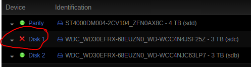

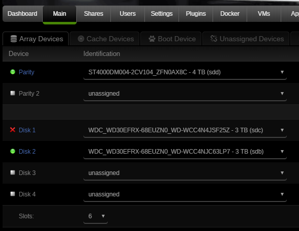

Disk 1 has filesystem corruption, it is disabled, and it isn't giving us any SMART information. Even worse, your parity disk needs to be replaced.

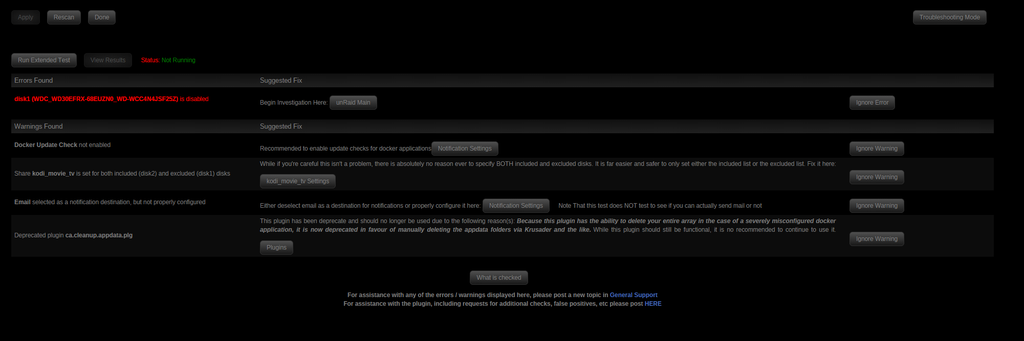

I notice warnings from Fix Common Problems, in particular, one saying you haven't got email notifications setup. So you probably didn't know you had a problem until it became multiple problems. And you are running a year-old version of Unraid.

Disk1 looks OK. Unfortunately, your parity disk doesn't, and you will have to rebuild disk1, either before or after fixing the filesystem.
So, you have 3 serious problems. 1) Disk1 is corrupt, 2) disk1 is disabled and needs to be rebuilt, and 3) parity needs to be replaced.

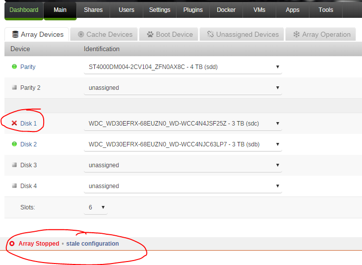

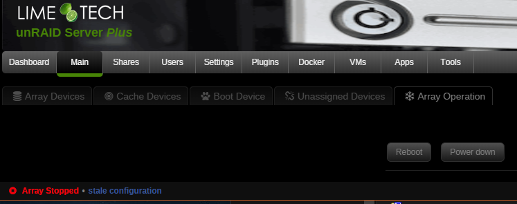

Array started but tells Array stopped - stale configuration, cant access any shares
Edited by Nebula
Just now, Nebula said:
I'm new to unraid
Should I do something here under settings again?

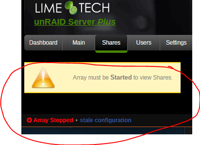

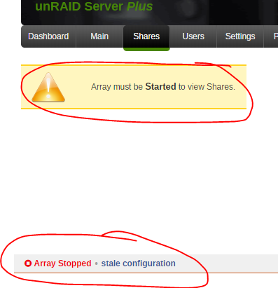

Look here under "shares"    It says array must be started to view shares  and text below says: array stopped - stale configuration

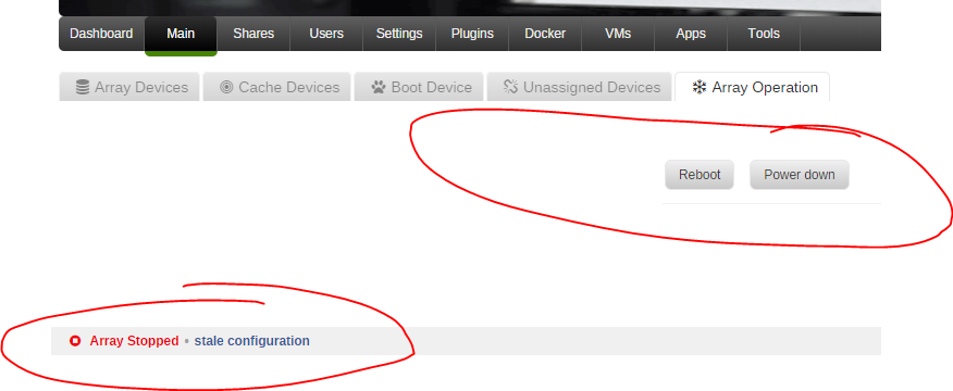

Under Array options there is not even an stop bottom /take array offline - only reboot and power down
Under array devices it still not active

Shares should still be accessible on the lan, but there's a problem with the GUI, upgrade to latest Unraid and/or start in safe mode.
