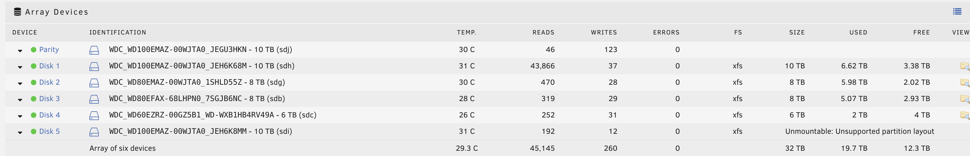

I am trying to add a brand new 10tb drive to my array and am getting the above error when I start the array (see image). When I try to format the drive I get the error:

May 16 21:50:04 unRAID emhttpd: /mnt/disk5 mount error: Unsupported partition layout

Reboot and you should be able to format it.
Wow that actually worked! What was the logic behind that suggestion?
On 5/17/2019 at 5:54 AM, tone said:
May 16 21:50:04 unRAID root: Warning: The kernel is still using the old partition table.
May 16 21:50:04 unRAID root: The new table will be used at the next reboot or after you
