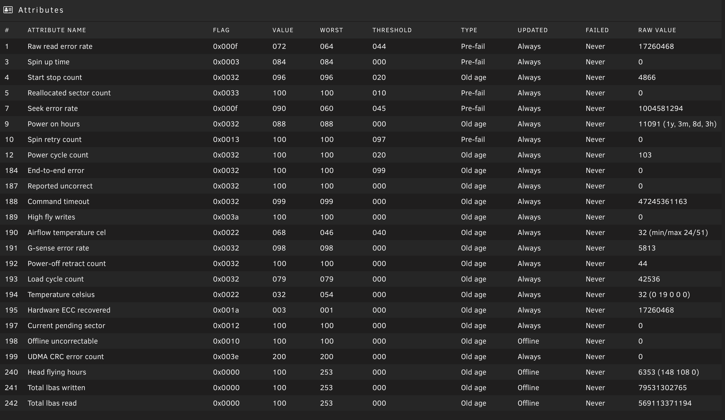

Hi all, just out of interest what would you say major issue with this drive is?  I got the red x, drive is disabled, contents emulated etc.....
Going to try a restart but...
Thankfully it's under warranty :D
Screenshot and logs attached (pre reboot).
721881732_ScreenShot2019-05-18at17_59_11.thumb.png.7ba61a17d302c9a1f754cbaaaf9e1057.png
obi-wan-diagnostics-20190518-0556.zip
SMART looks fine, and since there are several timeout errors with different drives before that one getting disable it suggest the disk isn't the problem, e.g:

First thing would be to see if these disks plus disk2 share anything in common, like a power splitter, miniSAS cable, etc.
It's hard to overlook coincidences, but I can't see why it would happen at exactly the same time I stopped the docker service lol.
After the reboot those errors have not come back from the log.  I have backups so, I've just deleted the partition from the disk and re added to the array.  It's running in emulated mode anyway, so may as well give it a go and in the mean while figure out if all those disks are on the same perc cable or what. I did get a new cable about a month ago (have a Dell Perc 310 running in IT mode).  The new thread ripper board took me down to only 6 onboard SATA ports so was quite grateful for it!
