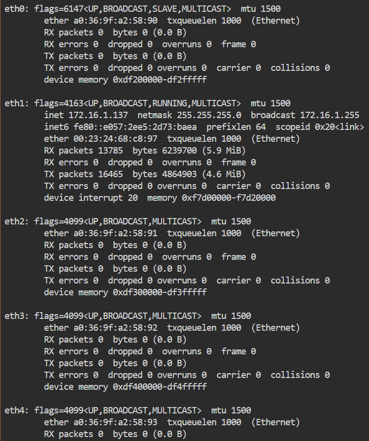

I'm way confused right now. I have access now, I got IP.
But I had to manually connect a screen to the server, login and then run this file that I guess it has to do with dhcp
/etc/dhcpcd.conf
tower-diagnostics-20190525-1601.zip
I think it has to do with this. But I'm still don't get it.
My card is now showing as eth1

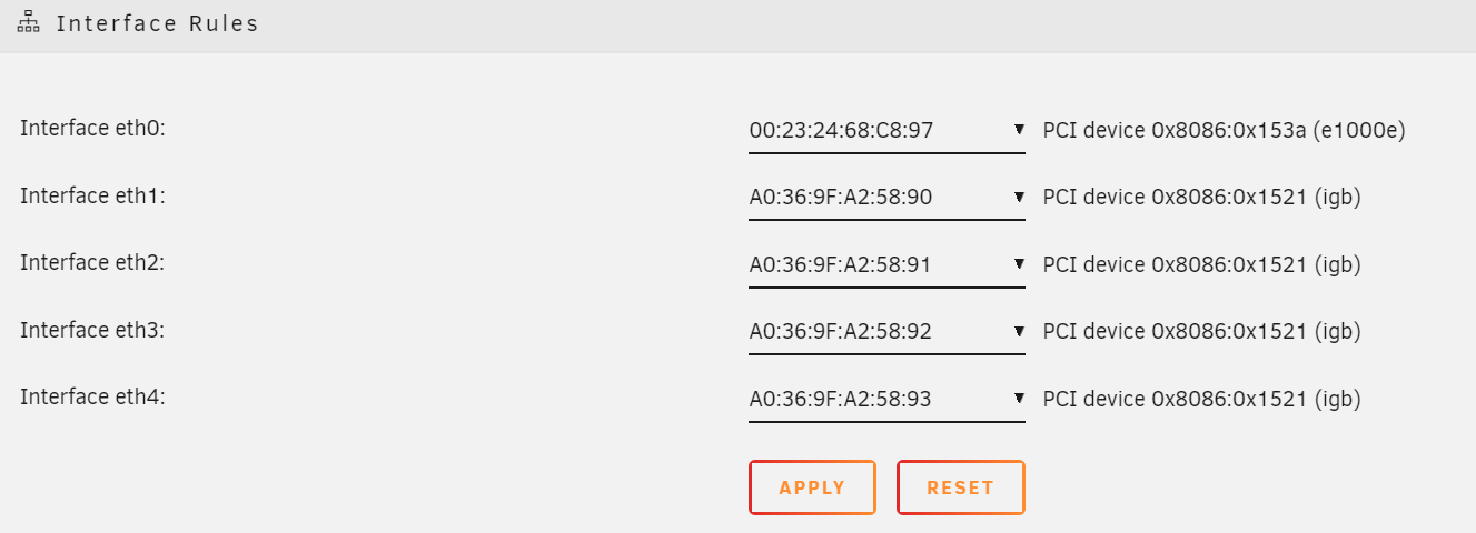

The Unraid GUI works on eth0 so you network configuration has to be altered so that the port you want to use is treated as eth0.
Enlight me please T.T how do I do this.
I think I got it.
27 minutes ago, gacpac said:
I think I got it.
Correct, change assignments here and reboot your server afterwards.

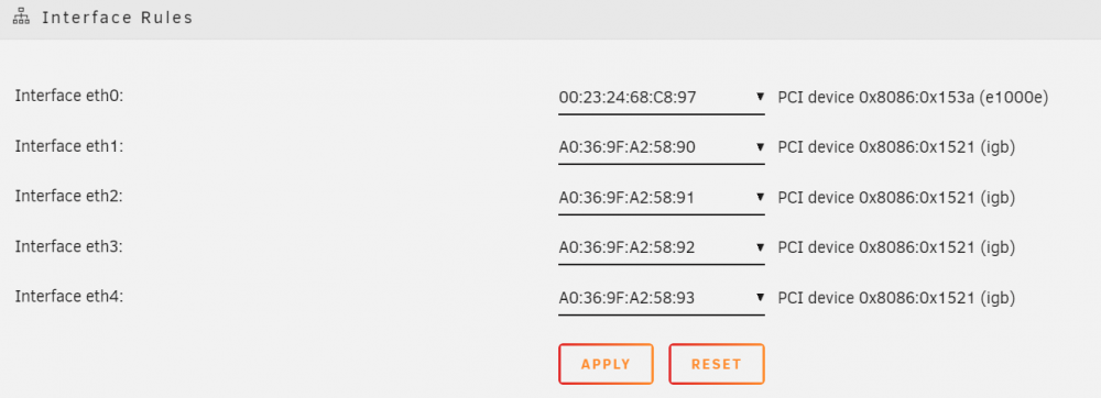

Thanks. I see it works but I'm getting this message I don't know why.
