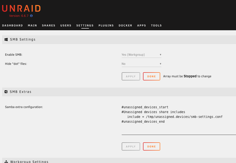

Let me start by saying I appreciate your tutorials.  I have a question on this one.  I don't have the option for 'Enhanced MacOS interoperability'.  Any suggestions?1045478600_ScreenShot2019-06-16at5_13_36PM.png.118a46940d86d6b29b76f0a2fba4eb78.png
You need to be running unRAID 6.7+.
Thanks. I'll upgrade
