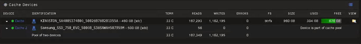

I have 2 ssds in my cache pool, they are setup as RAID1 (mirror)
The available size should be the size of the smallest ssd .right?
After installing the second ssd, the available size was set correct to 480 GB, but I 've noticed that after the second ssd spins down, the cache size increases to the sum of the 2 ssds. is this normal?

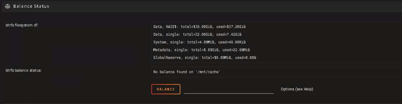

At some point cache2 dropped offline, and now pool is a mix of single and raid1 profiles, if you had system notifications enable you'd have been warned about it.
You'll need to rebuild and rebalance the pool, easiest way should be:
This should be relatively safe to do, but if there's any important cache on data backup before starting.
stop array
unassign cache2
start array
stop array
re-assign cache2
Then check pool was balanced to raid1, if it wasn't do a manual balance.
