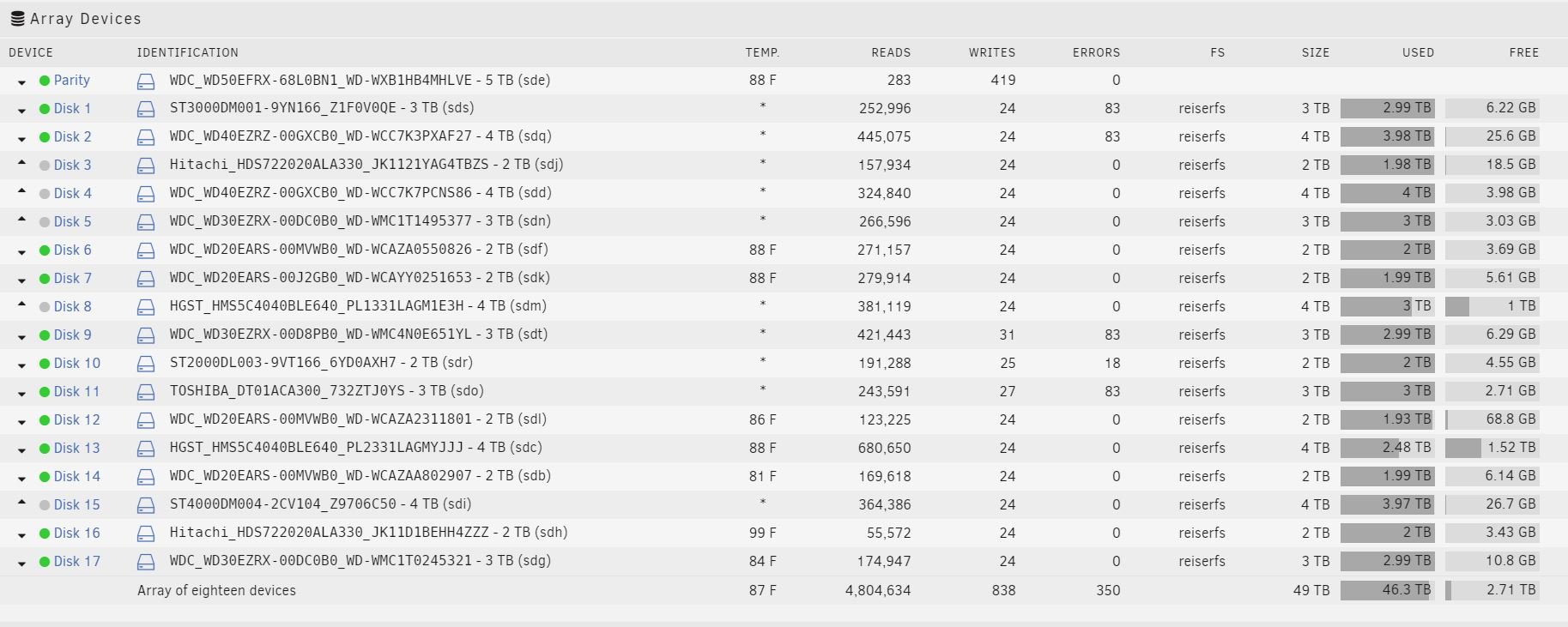

I changed out the CPU cooler on my server yesterday, so I was monkeying around inside the case.  It booted up and played music over Plex for a couple of hours and I had no issue.  Then Plex crashed and I got a notification that 5 discs have read errors.  I think it's probably a cable issue with SAS-Sata cabling, but thought I would upload my diagnostics to you kind folks before I touch anything.  No red x's yet because I haven't touched a thing,  Zip file and screen shot attached.  Running UnRaid 6.7.0.
Unlikely since it would be two miniSAS cables having a problem at the same time, maybe that SASLP needs re-seating, it can also just be the typical SASLP problem.
So I should be good to Powerdown, reseat the card and secure all cables, and then restart the server?
That worked.  I'm all good now.
