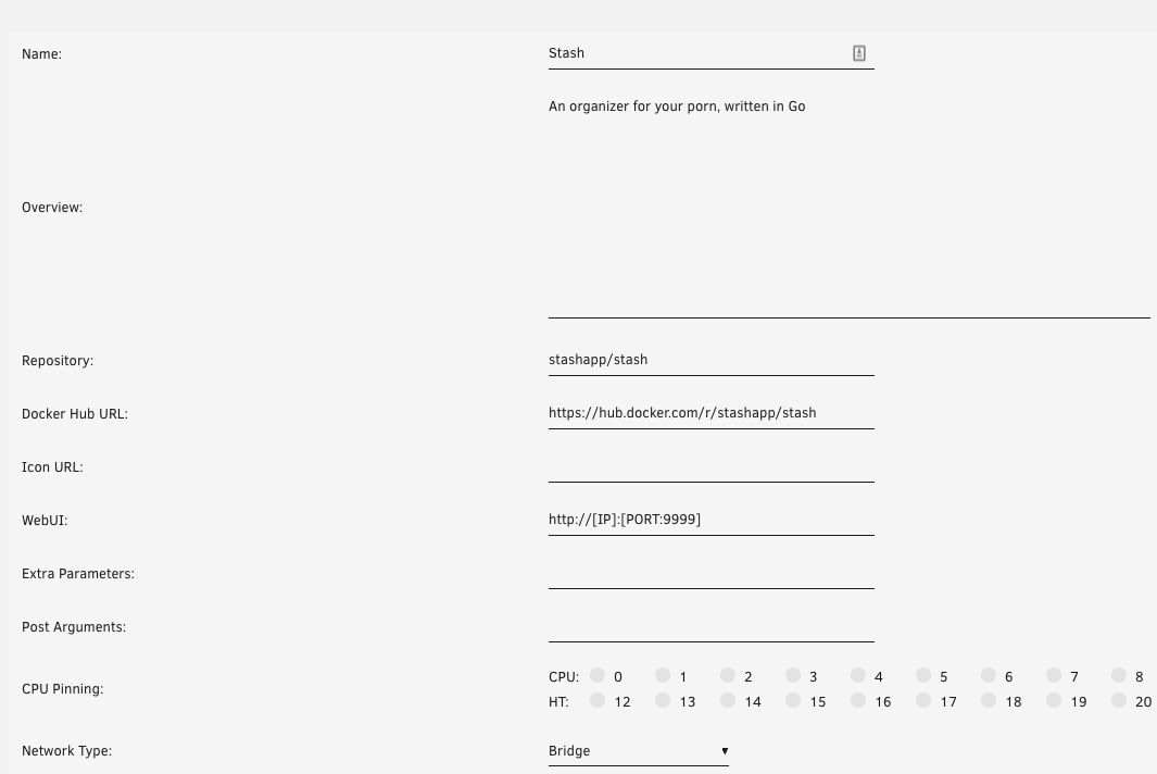

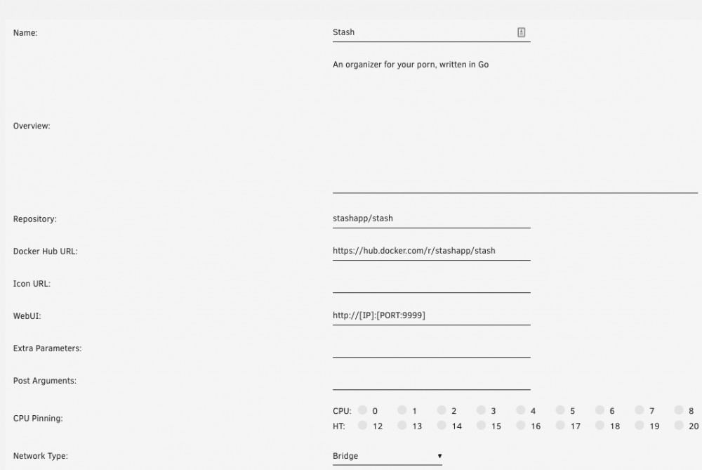

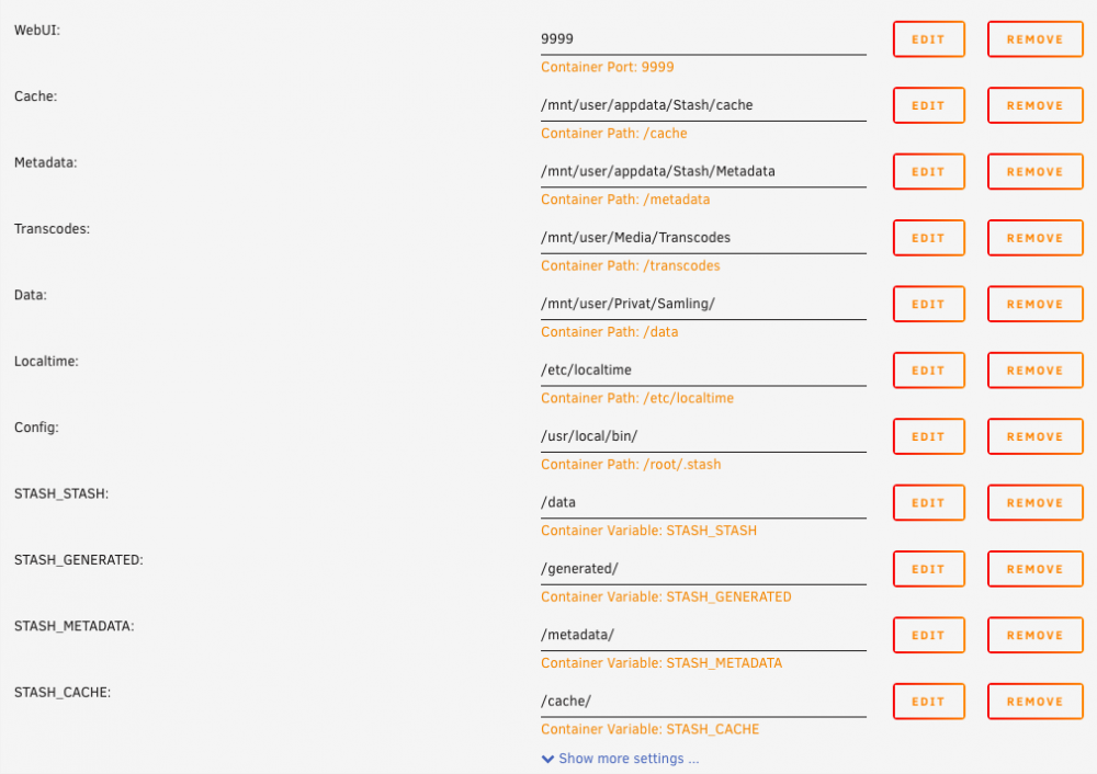

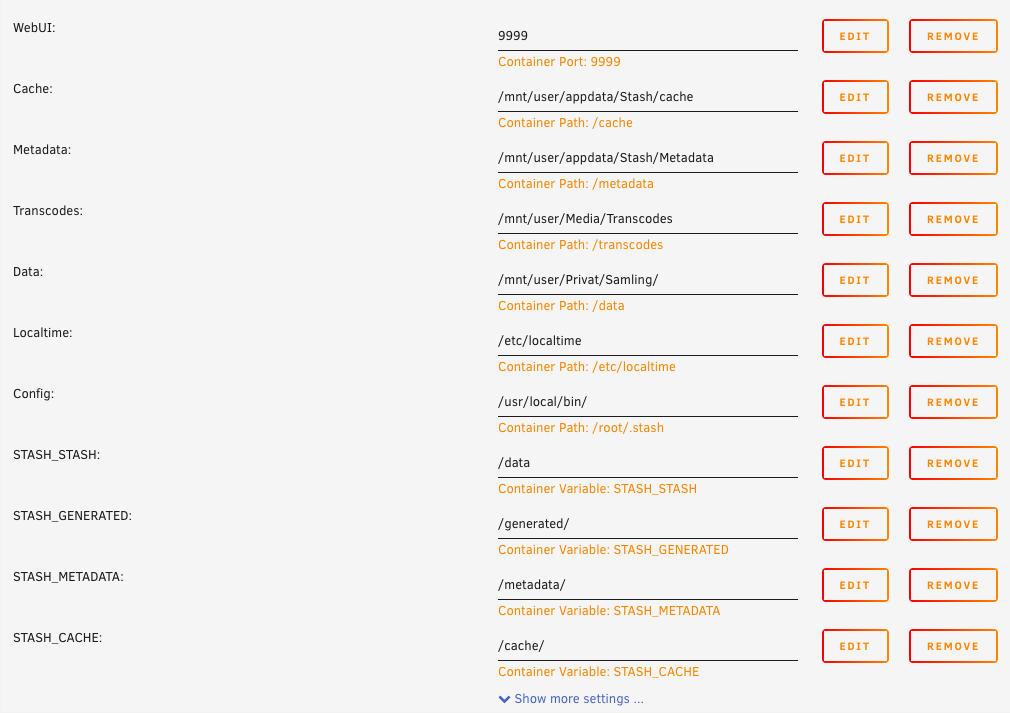

My current docker setup, I've tried various things without luck

mp4 and m4v play just fine, but wmv results in an error.

I don't know if you could fix the problem yet, but for me it was enough to pass the path from /generated to the host, like /metadata, /cache and /transcode.
