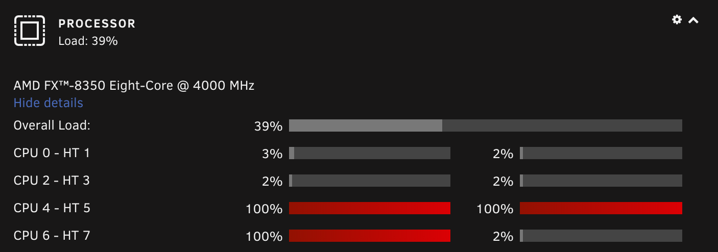

Is anyone else having issues with windows 10 with 1903 that just came out. For some reason it keeps two cores at 100% all the time once i get of using RDP. Let me know what can i look at to trouble shoot.

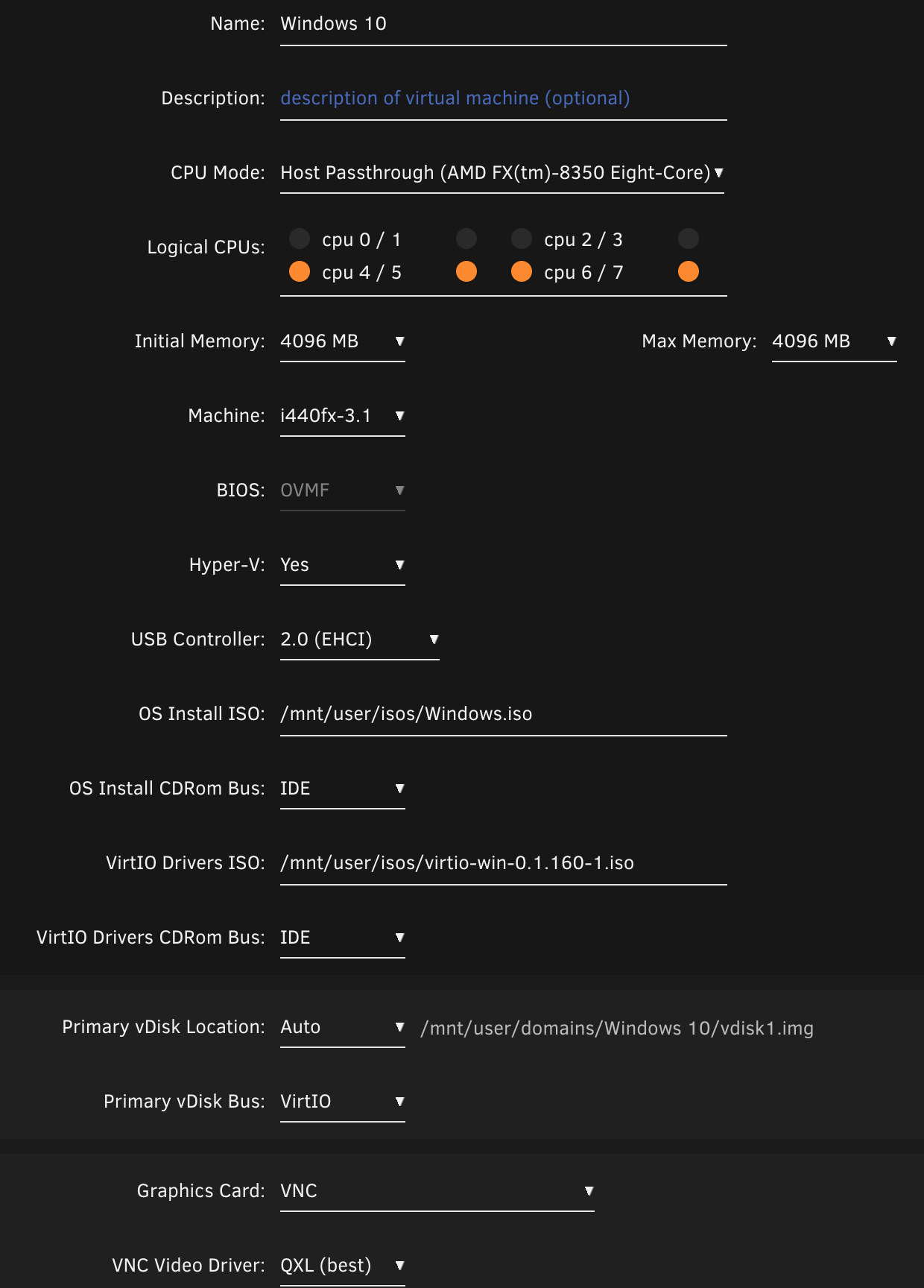

These are my current settings. I have to keep force stopping and restarting to go back in the VM.

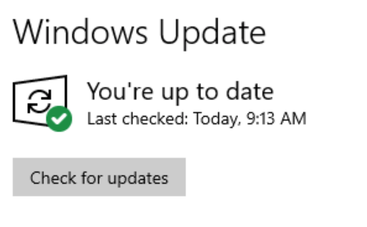

Is also up to date.

I did a couple more tests and another thing what I noticed with 1903, as soon as I login with a user no matter if I use VNC or RDP all cores spike up to 100% for maybe 20-30 seconds. A short spike is normal but this amount of load is unusual. Remember it's a fresh install without any passthrough. I went a bit further and stripped down the install iso and removed a couple of the junk, all the useless apps and services and preconfigured the install, removed or disabled all the tracking functionality as far as I know of. Same behaviour. After the first login it looks like everything settles down and works as normal, only the first seconds the cores are all pegged more than on older versions. Not exactly sure what causes this, maybe microsofts newest implementations to prevent all the spectre meltdown zombieload attack surfaces. Maybe on older CPU architectures like on Piledriver and Bulldozer in a virtual environment this is an issue now. Let's hope maybe some other users can report back if they have the same issue as you on similar hardware. Have you tried it with Q35 as machine type instead of i440fx? @Tucubanito07
Thank you for the input. I have not tried the Q35 as I don't know what it does. It was working perfect before the 1903 and now it will spike for a bit. Then after a while it will just stay at 100% and I cannot do anything else on it. I did go through the privacy stuff on windows 10 and turned off. @bastl
