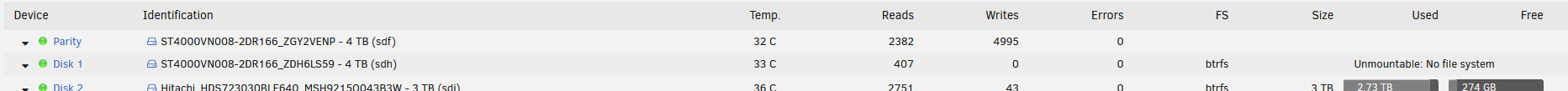

I recently had a bad drive in my unraid server, so I bought a replacement and set it off to rebuild the array. When I checked if it was finished it shows Unmountable: No file system. I ran the preclear plugin before adding it.
Im unsure why a brand new drive that was just added into the array would have no file system?
I've stopped/started the array and restarted the server with no luck.
Any ideas?

If I run a btrfs check using the GUI it says
    parent transid verify failed on 1477954420736 wanted 175092 found 1569
    Ignoring transid failure
    Couldn't setup extent tree
    ERROR: cannot open file system
Transaction ID is way off, a small difference can happen for example after an unclean shutdown, something very wrong happened there to have such a large difference, in any case that error is fatal, you can see here for some possible options to recover the data.
Humm, no unclean shutdowns or anything, the drive just failed (18 or so read errors) during a parity check. The original drive is mounted and all the data is still intact, so this doesn't seem...normal?
