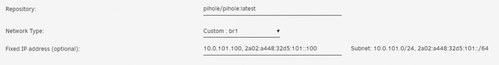

I'm trying to get PiHole running as per Spaceinvader One's video but in network type, I don't have the option to set a static IP I only get the bridge and host options. I've tried searching the forums and making a couple of the changes that I have seen in other threads but the solution still escapes me. I'm sure it's something simple that I am just completely missing.

You need to change the "network type" of the container to a custom network (Custom: br0 in your case).
You can set both an IPv4 and IPv6 address (if used) as fixed address for Pihole.

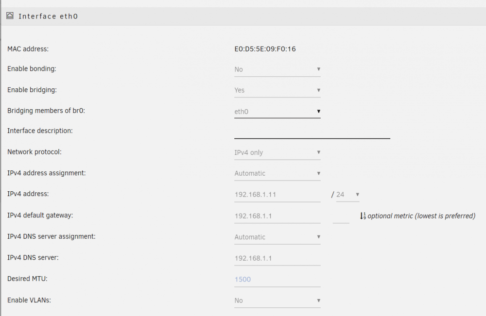

In addition: under Docker settings you need to enable br0 as custom network
Thanks, maybe I'm blind but where do I find this option?
Settings >> Docker the setting will be exposed when you set "Enable Docker" to "No" and hit "Apply."
Ahhh that makes sense why I couldn't find it. All solved now thanks :) and thanks bonienl
