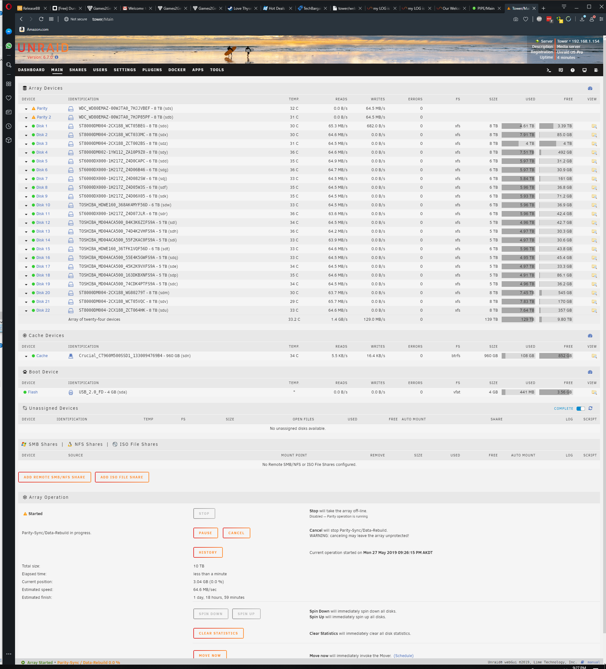

I changed 2 wd 8tb drives for 2 wd 10tb's which i shucked today (They were not precleared prior to swapping them out)  After about a few hours i had errors everywhere and my log was full.  I have 2 se3016 16 bay drive racks hooked up to a computer via 2 cables.  I am guessing that a problem with one of the new drives brought all of the drives down, however it does look like i have a udma crc error in one of the 10tb's now.
I rebooted and put the 8tb drives back in once i discovered the udma crc error and now my data rebuild of both parity disks shows
"Size 10TB" instead of 8.  Same thing after another reboot.
just as a note I am currently trying to preclear the questionable 10tb in another machine to see if it continues to have errors.
Am I ok with this rebuild of parity 1 and 2 (8tb drives) even though it says 10tb?
Attaching diagnostics prior to shutting down the array with the 10tb parity build lockup. A screen shot of current rebuild with the 10 tb issue and also the smart from the 10tb with udma error.

Should i be worried about the 10TB size in the parity rebuild even though drives are 8tb?
When you start again it should say 8TB, if you use the 8TB disks, if it doesn't post new diags.
It didn't and it is 10 plus hours into the parity check, i also rebooted the server once to try and get it to go away.  Here are the diagnostics.tower-diagnostics-20190528-1613.zip
Can't see in the diags since there was a reboot since but likely you assigned the 8TB disks while parity was still invalid, you should stop the the array, unassign both parity disks, start the array, stop again, re-assign to begin rebuild, and now it will show correctly.
