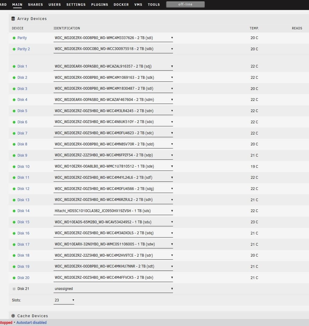

If you stop the array, how many drives slots are listed in the Main page?
Have you tried stopping the array and moving a disk in slot1..8 to slot9 , then checking if Unraid sees the disk still?
@ken-ji:
when the array is stopped, i see both parity drives and the existing 20 data drives.
the 21st is still unassigned and the new disc (a wd20ezrz) does not appear in the drop-down menu.
one thing i did not mention previously: at first i thought the bay containing the new drive might be defective, so i shifted the disc to the next bay to see if that was the problem.  surprise: quite a few of the existing drives disappeared, as far as unraid was concerned.  putting the new drive back into its original bay restored the server to a working configuration (no missing drives... except the new one, of course).
i will try moving one of the existing drives into slot 9 of the drive array to see what happens.
will keep you posted.
p.s.: editing this message to add screenshot of drive list.

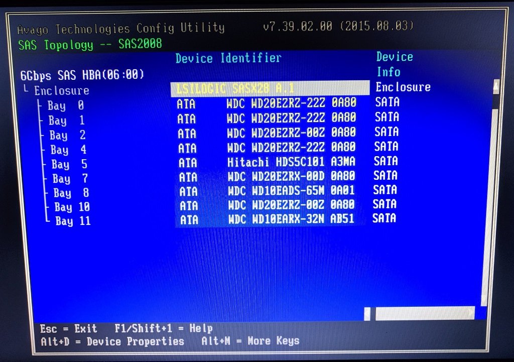

quick update:
was not able to perform any significant testing this evening, but managed to check the unraid syslog to see if there would be any error message, anything that could yield a clue why unraid is not seeing the new drive that was added to the external jbod array.
whilst the h200e does see the new drive (see the photo in the previous post, it's drive 0 (zero) in the 'sas topology'), there is absolutely no trace of the new 2tb disc in the syslog.
not sure where and how the disc is getting lost.
the only certainty i have at the moment is that this install of unraid v6.7 appears to have a problem dealing with more than 22 drives (14 internal + 8 external) total.
for reference, the main server is running 24 drives with absolutely no issue (norco 4224 chassis).
to be continued.

(1) the h200e, maybe the card's driver said something useful;
(2) the jbod's backplane -- assuming 'lsilogic sasx28 a.1' as seen in the 'sas toplogy' is what i should look for (that or simply 'enclosure')
