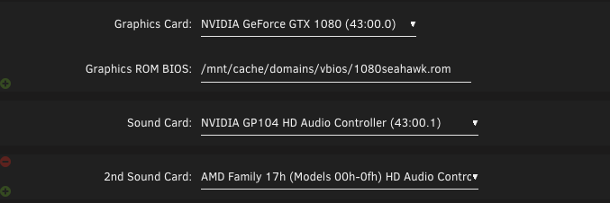

Make sure that you are also passing through the sound part of the GPU.
[10de:0fb9] 01:00.1 Audio device: NVIDIA Corporation GP107GL High Definition Audio Controller (rev a1)
The driver will expect there to be Nvidia sound hardware present. If you want to use a different sound card just pass through a second one but leave the Nvidia present.

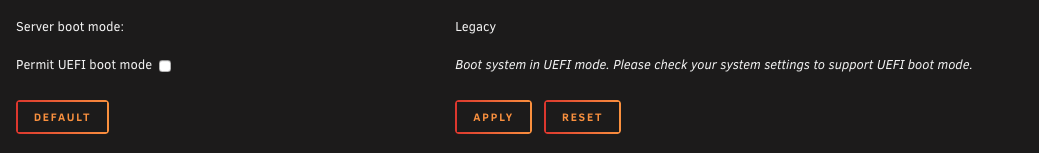

Also if you are booting Unraid in UEFI mode then try legacy mode. Click flash on the main page and check if you are using legacy or UEFI.
727890377_ScreenShot2019-05-30at13_57_33.thumb.png.b08bd3bfa4fa0ceedbbff654641f516f.png

@SpaceInvaderOne Thank you for jumping in on this! I had completed everything on your list before except changing the server boot mode to Legacy. I tried it months ago and the server wouldn't boot, so I left it alone for a long time. I spent some time troubleshooting today and changed my motherboard bios from UEFI to Legacy and UEFI, then unchecked Permit UEFI boot mode...and bingo!
Thank you for all you do for the community!
