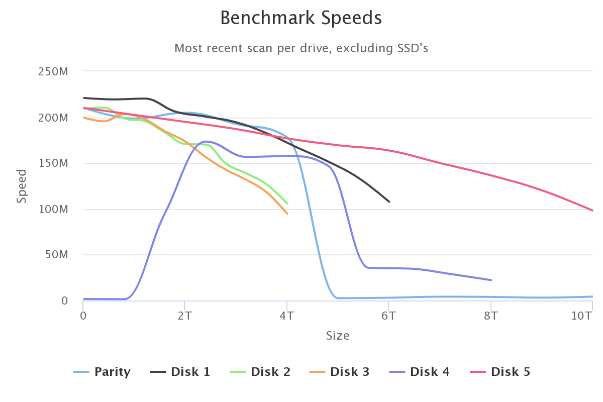

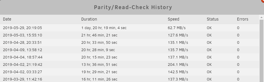

Hi , I recently had a parity check which took a lot longer than usual. I ran a disk benchmark and found out that the drives for parity and disk4 are really slow but SMART reports seem to show that it's fine. Not sure what might be the cause of the slow parity check. It took almost double the amount of time as it normally does. Please see the attached diagnostics.

I've been using disk4 since before I installed my dell H310 and even with my dell H310 installed it was running fast, parity checks were fine. It's when I added two additional new drives (10TB x 2) is when the issues started happening. I'm wondering if there is an issue with my H310 controller since it is running 6 drives on it (2 SAS to sata cables, 4 sata connections on one and 2 on the other).
You could try installing the DiskSpeed docker container as an easy way of checking the drive speeds on Unraid.

I ended up connecting more drives into my motherboard and fewer onto the Dell H310 card instead to see if that improves the results.
Is this normal behavior for drives or do you still think there is issues with my Disk4/Parity?
Yes
