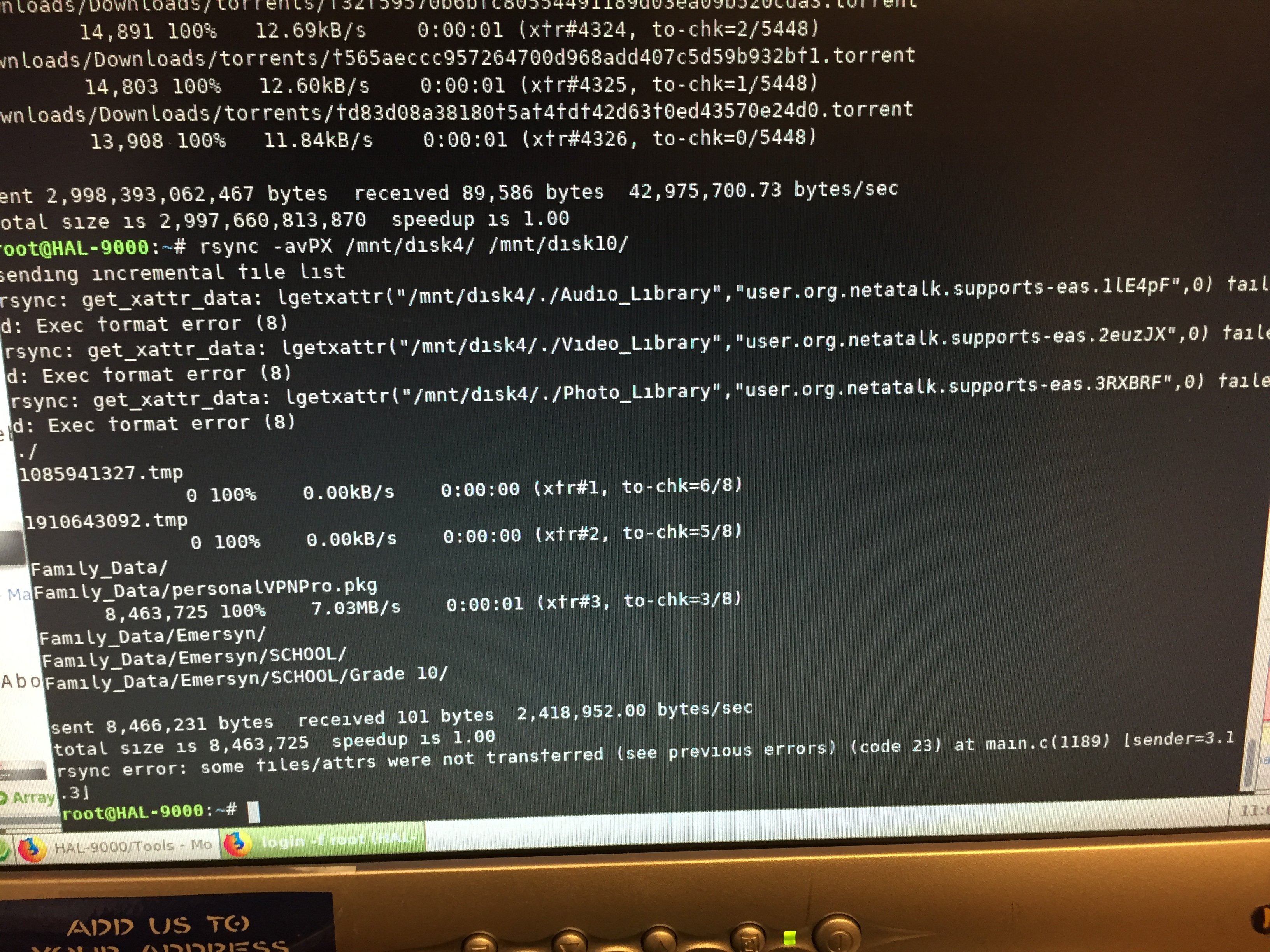

I am in the process of converting my file system from RFS to XFS.  The first 3 disks went perfectly - I hit disk four and had an rsync error (as in the attached photo).  I am looking for some guidance as to how to correct this issue and keep moving.
Remove X from the command, extended attributes won't be copied.
Thanks.  I appreciate the quick reply...I am a linux newbie...I am back on the road to file system conversion completion with your assistance
