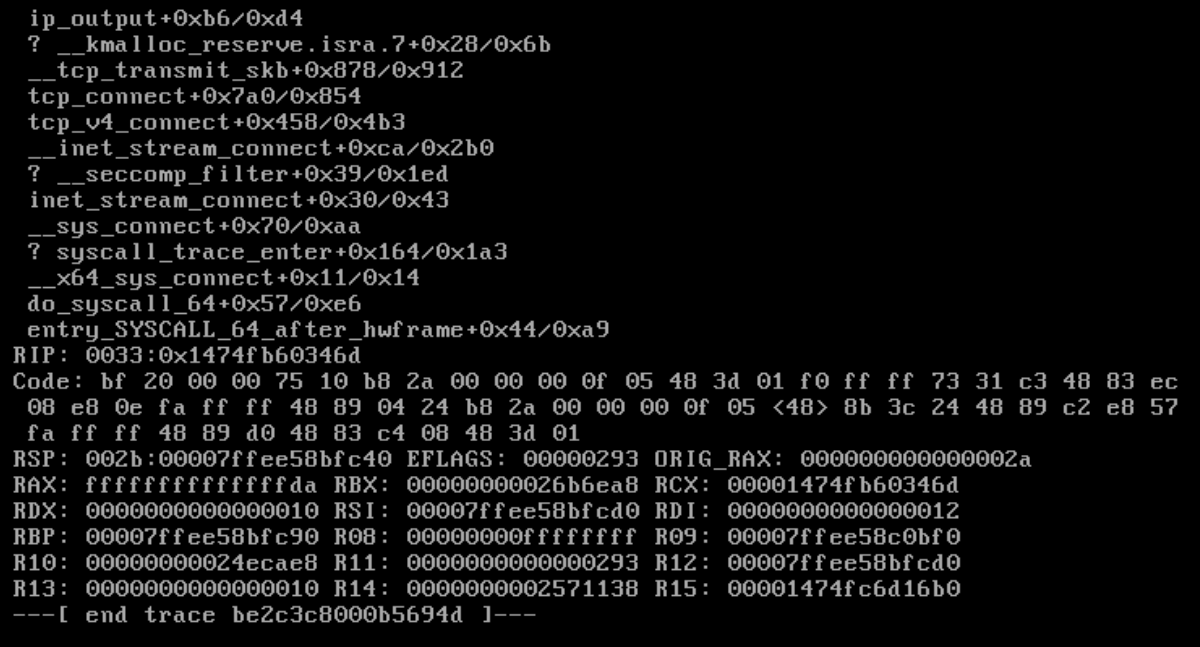

My Unraid 6 crashed, need help to figure out why
I am using Unraid 6.7.0
Several days after a power cutoff (terrible weather in the mid-west USA)
My Unraid is keeping crashing
When i connect a monitor to the server, all i can see is the screenshot
Is there anything I can pull from the system to figure out the issue?
I have 4 harddrive (2 data and 2 parity) and 1 ssd cache

macvlan call traces are usually caused by dockers with custom IPs.
I do have pihole and plex with custom IP.
Is the crash caused by docker? or anything else?
I have a friend with similar config but he is fine... :/
If you have docker containers with custom IP addresses on br0 and your call traces are macvlan related due to broadcast messages (which they appear to be), join the club.
I had to create a VLAN (br0.3) and assign custom IP addresses on that VLAN to avoid the problem.  Call traces do not always result in system crashes immediately. With this situation, after several days of call traces, my server eventually locked up hard and had to be powered down manually.  With the br0.3 VLAN, I have not seen these call traces in almost a year.
It does not happen to everyone and it does not always happen on br0, although for most of us it does.
This is not a core unRAID issue.  There is not much Limetech can do to solve this as it appears to be related to the macvlan implementation in Docker.
