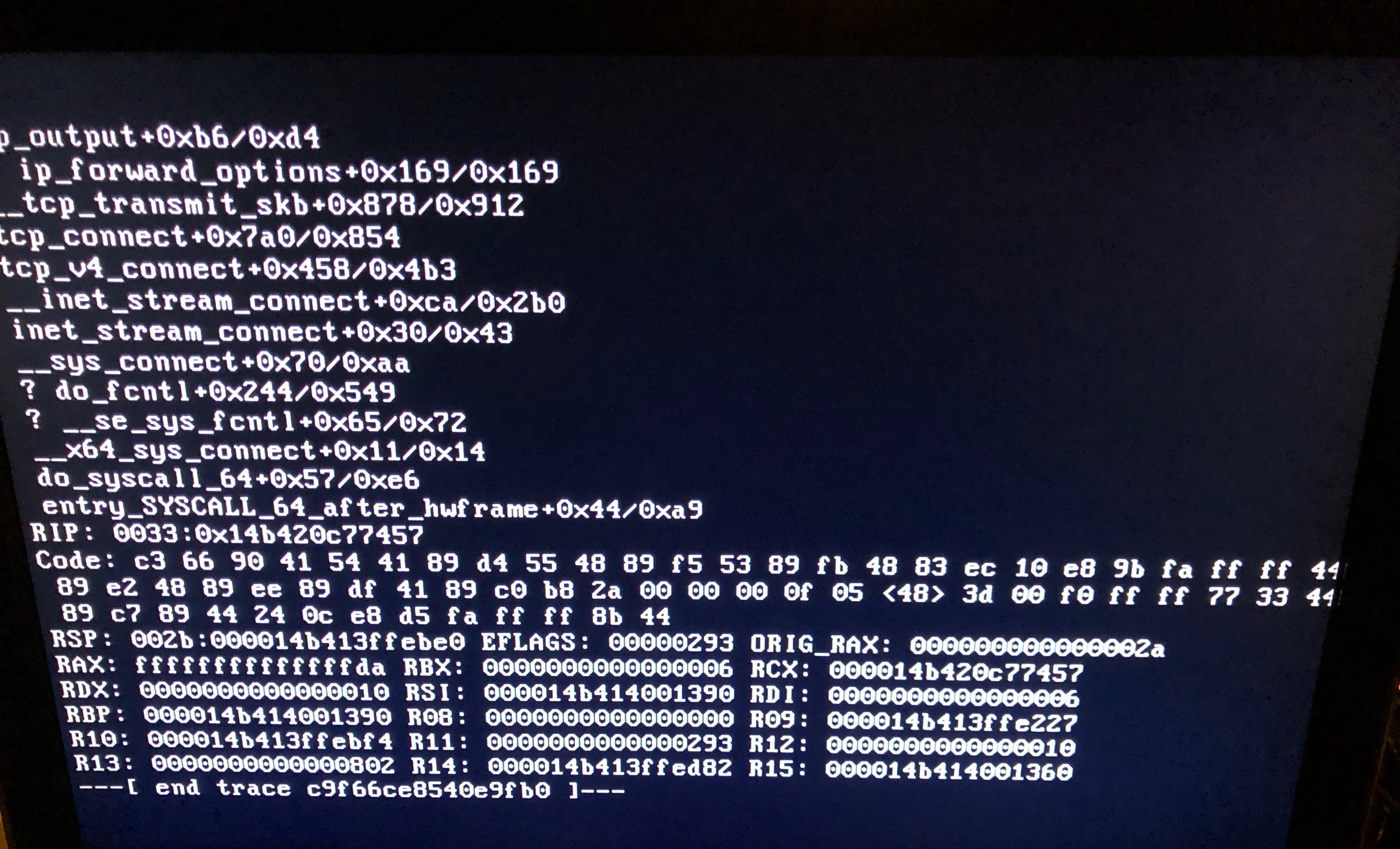

Another Crash today - Here is what was displayed on the Console.
Also attaching the syslog from the flash drive.
Around 4:26PM Central time is when I got the notification from uptime robot that is was down.
in the syslog around "Jun  1 16:41:10" would have been when the server was rebooted.
Any help would be approached to see what is causing this. I think Im going to roll back to 6.5.3 if the issue isn't something obvious.

Doing some digging in the forums and my issue may be similar to this one -
The strange part is that user Hoopster stated they see this issue with macvlan all the way back to 6.5.0
My server was running perfectly fine on 6.5.3 with the same setup.
Moved all docker traffic to a dedicated interface (br2) - leaving br0 (bond of eth0 and eth1) for other traffic. I was hoping this could alleviate the potential problems with the macvlan issue with br0 and static IPed containers. But I had another crash today. I formatted my flash and I’m going back to 6.5.3 for now since I know my setup will work fine with that.
