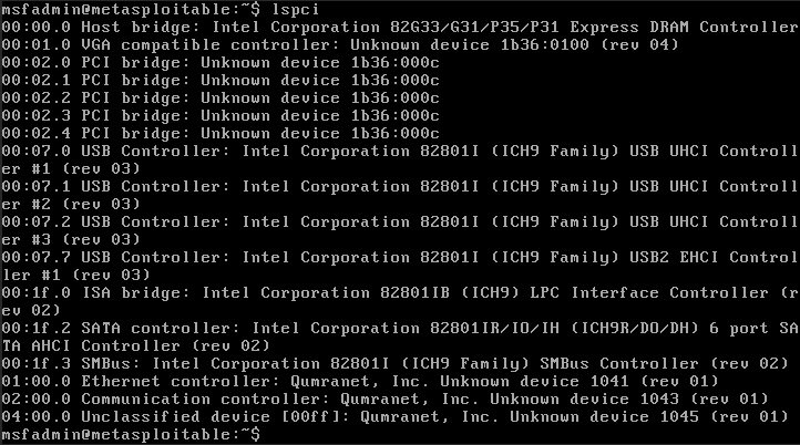

You have the VM set to use vfio for the network, so the problem probably is that the VM does not have vfio drivers installed.   You would need to either get the vfio drivers installed into the VM, or alternatively set the VM to emulate some other type of network card for which the VM does have drives.
Thank you for your response. I am unsure how to do either of those things. I attempted to set the vm to emulate another type of network card, but it keeps giving me an error when I try to start it. I don't think I have the correct syntax. I have attached a screenie of an lspci command. Is that where I should be looking for supported nics?

You could probably solve this in two ways without passing through the NIC:
  • Install the 'vfio' network drivers inside the Ubuntu VM.  They should be on the vfio CD image that you probably already have attached to the VM.
  • Change the 'model' of the network card in the VM XML to something for which VM Ubuntu already has drivers.   Something like 'e1000' is likely to work.   To make this change to the VM settings you have to make the edit in XML mode.

Changing the model to e1000 did the trick. Thank you for your assistance!
