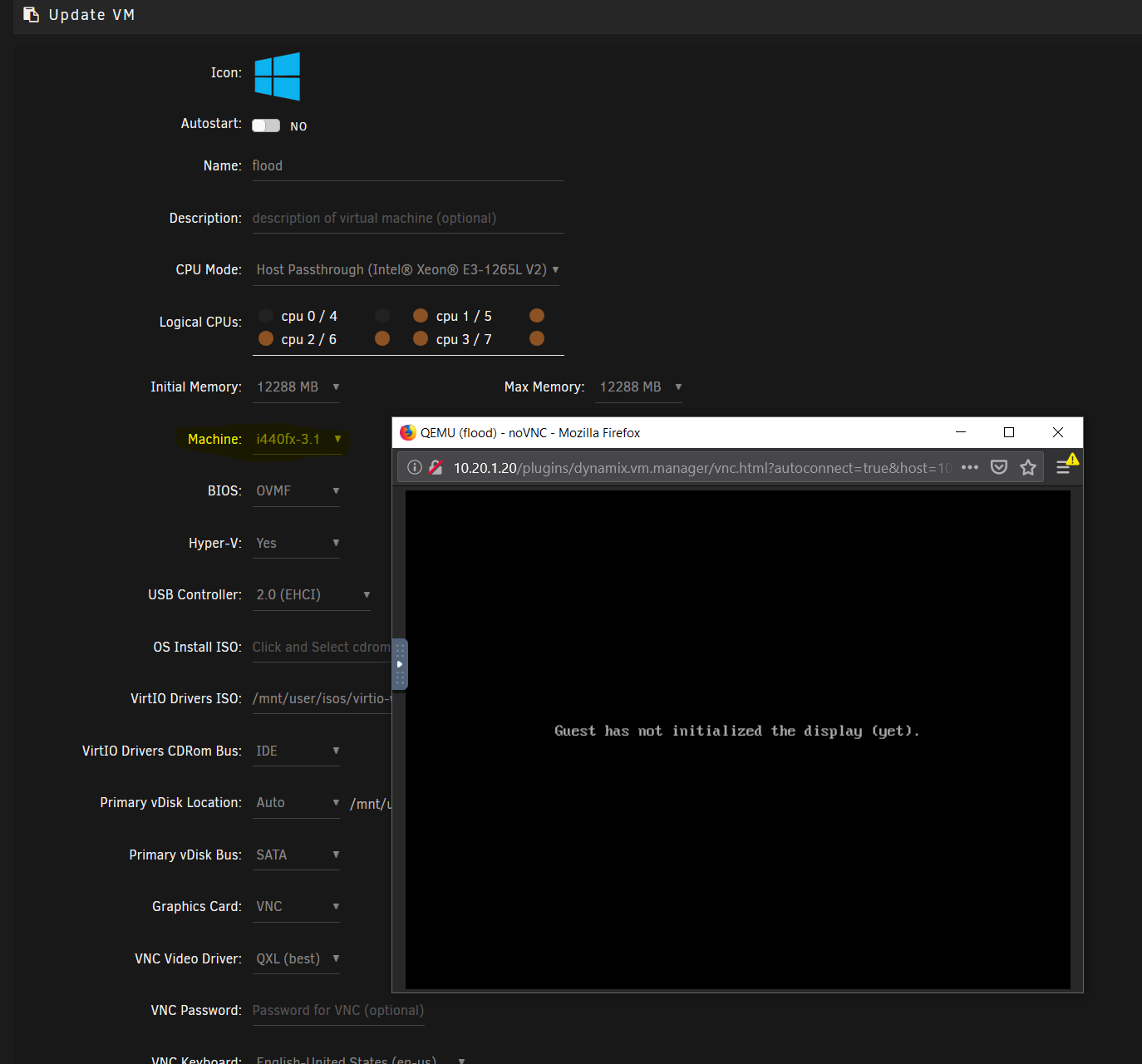

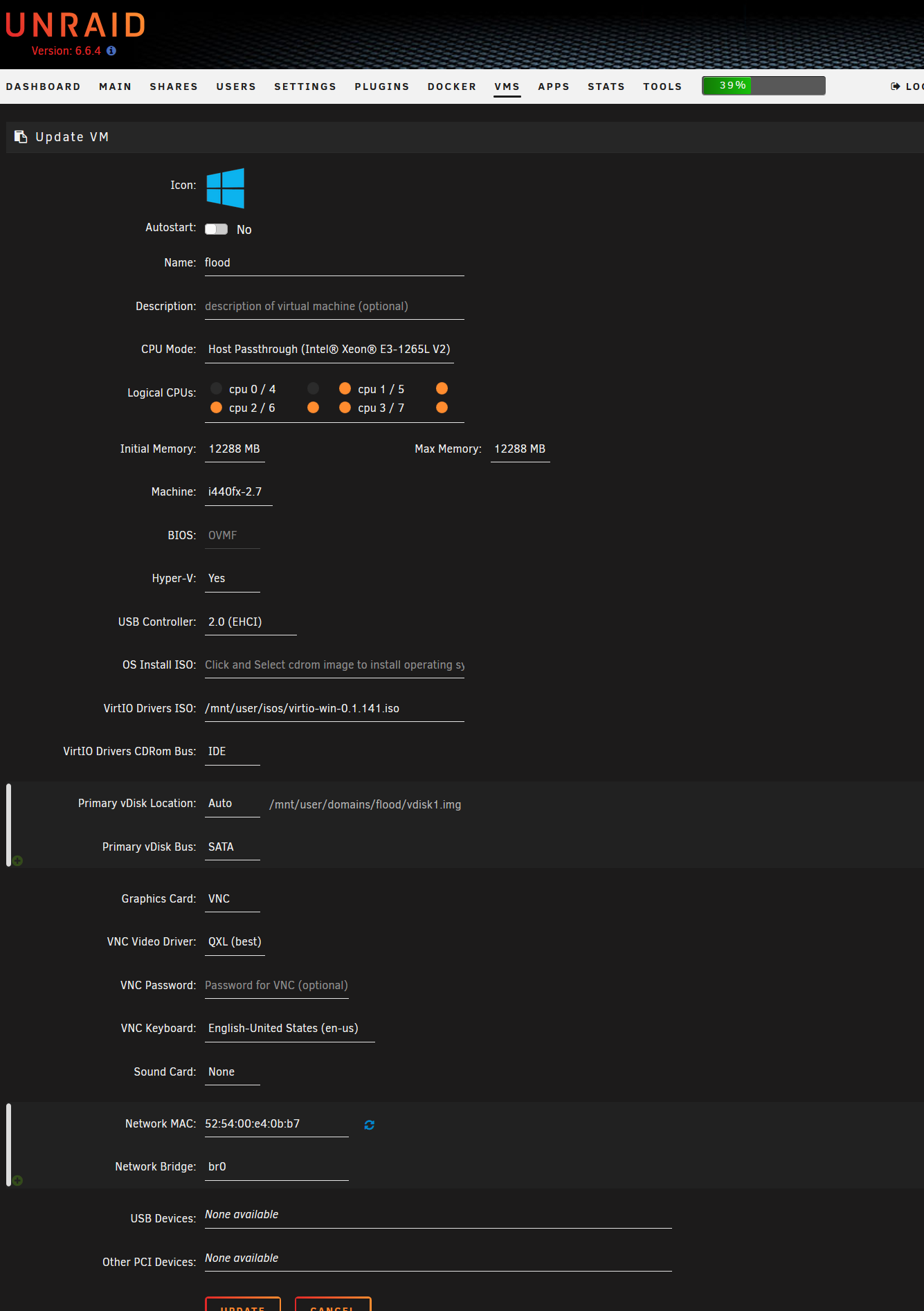

I have a Win10 VM that I have been using for about 18 months.  When it was originally set up it was done to the methods set forth by SpaceInvader One at the time.  The VM worked like a dream for me for a long time, but then there was a period where I stopped using it for a few months.  When I've come back to it now it no longer boots, or if it does I get no indication of such.  When I try to RDP to the instance as I used to, I get a connection timeout, and if I try the built in VNC, I get a message.  Guest has Initialized the display (yet).  I've tried removing some of the extra vdisks that used to be attached to this instance to simplify the boot, but with no luck.  Any help is greatly appreciated!

Try a newer machine type version for i440fx, 3.1 should be available in the drop down.
Appreciate the response.  I changed the machine type to a v3.1 but I'm still seeing the same thing.  When I attempt to start this VM, the CPU1 core goes to 100% and stays there until I have to force kill the vm instance.

I did do that bios update, because I think it was the Intel CPU microcode update for Spectre/Meltdown.  As expected it didn't help, nor did a dozen other things I tried, but I did find a workaround.  I tried creating and booting a new Win10 VM and it worked, which told me that it was an issue exclusive to my VM and not the KVM subsystem overall or something.  When I booted the new VM (which was created with an identical hardware config to the old VM) and saw it get to the "press a button to install windows....", I immediately shut it down.  I then went to the domains share and deleted the vdisk of the new VM.  Then I copied the old vdisk1.img file from the old VM to the new VM's folder.  I again tried to boot the new VM (which was now using the old VM's vdisk) and this time it booted all the way into Windows.  Horray!  Now I just have 6 months of Windows updates to do.
Because this really wasn't a fix for the old VM I'm not going to mark anything solved, but I did want to update what had worked for me in case anyone stumbles across this in the future, and thank tjb_altf4 for their attempts at helping.
