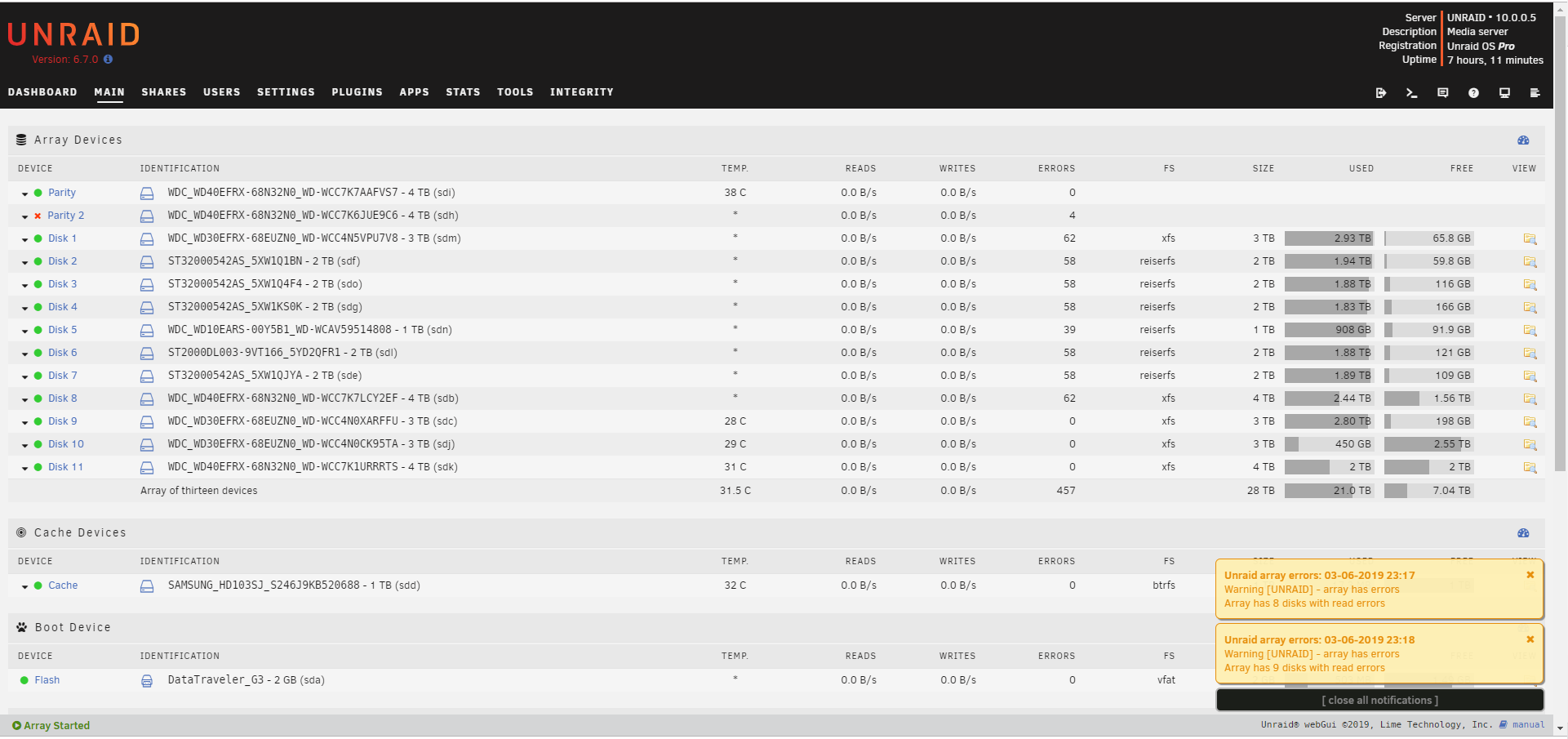

I recently transplanted my hardware over to a new case and at the same time changed the board, cpu and memory. Initially I had a problem where one of the controller cards was showing all disks on boot but not in unraid (displaying as missing). I updated the BIOS on the board from F3 to F8 and re-seated the card and cables, which seemed to work. Everything booted up ok and all disks went green. I allocated a new/spare disk as a cache drive, which formatted OK and i had green lights across the board, no errors.
A few hours later after some light plex use, Parity 2 drops out first (red X). I figure maybe the cable is bad and I'm dealing with dinner/son/etc so leave it for the moment. Shortly there after when I get a chance to check it, the shares have dropped off and I have read errors across most of the disks.
I'm wondering if the BIOS is setup slightly differently on the new board (legacy, ide mode, etc) so tomorrow afternoon i'll compare against the old board but I'm mostly at a loss as to what is going on.
Motherboard changed from a Gigabyte GA-H57M-USB3 (rev 2.0) to a Gigabyte GA-H67MA-USB3-B3 (rev 1.0) and I ran a few passes of memtest on the new board without any issues yesterday.

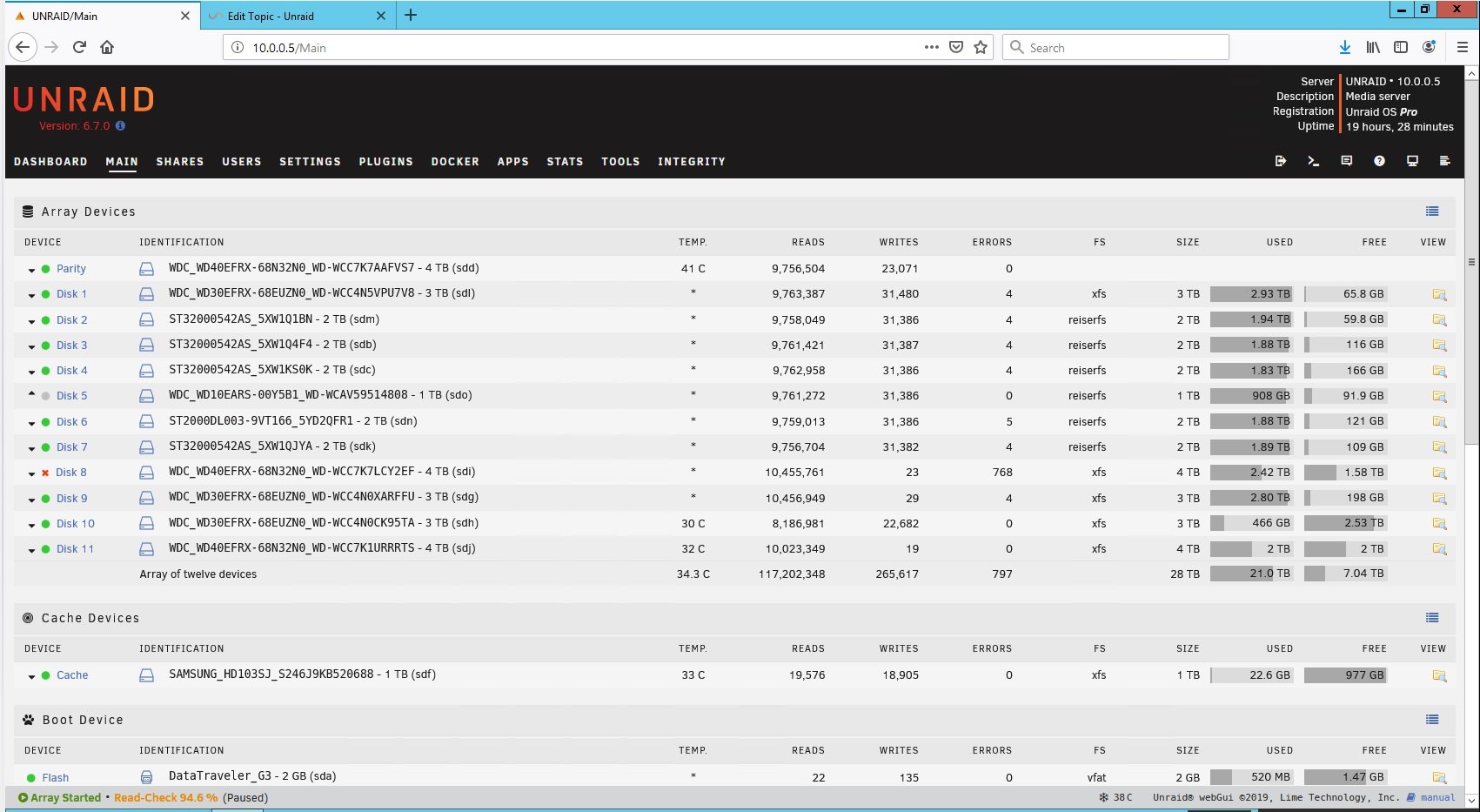

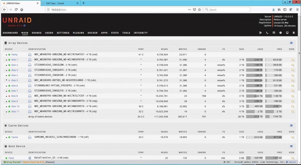

Edit: I unassigned Parity 2 since it was 'dropped' and after a reboot and replacing a couple of SATA cables (both parity drives) it was looking OK but then after today, errors all over the place again. Syslog is from the first time it failed, diagnostic is from after the reboot. Now disk 8 has dropped completely, I have no idea what is going on.  Added an extra screenshot.

Sorry for the late reply, been really busy with work. I've updated the OP with diagnostic after booting the server back up last night, it looked OK initially and I ran a non-correct parity check overnight, in the morning all disks were OK at about 30% with 8 errors detected so I stopped the check and changed to a correcting parity check, which I now regret- I'm hoping the data isn't corrupt. This afternoon looks just as bad as the other day only with different disks.
Please note that between the two screenshots/reboots I also tidied up the cabling so the specific disks aren't necessarily on the same ports as they were the first time. Apologies if this makes things a little messier to diagnose but the logs should clear up any confusion.
Multiple SATA links are going down, in multiple controllers, my first guess would be a power problem.
Also change the onboard SATA controller to AHCI mode.

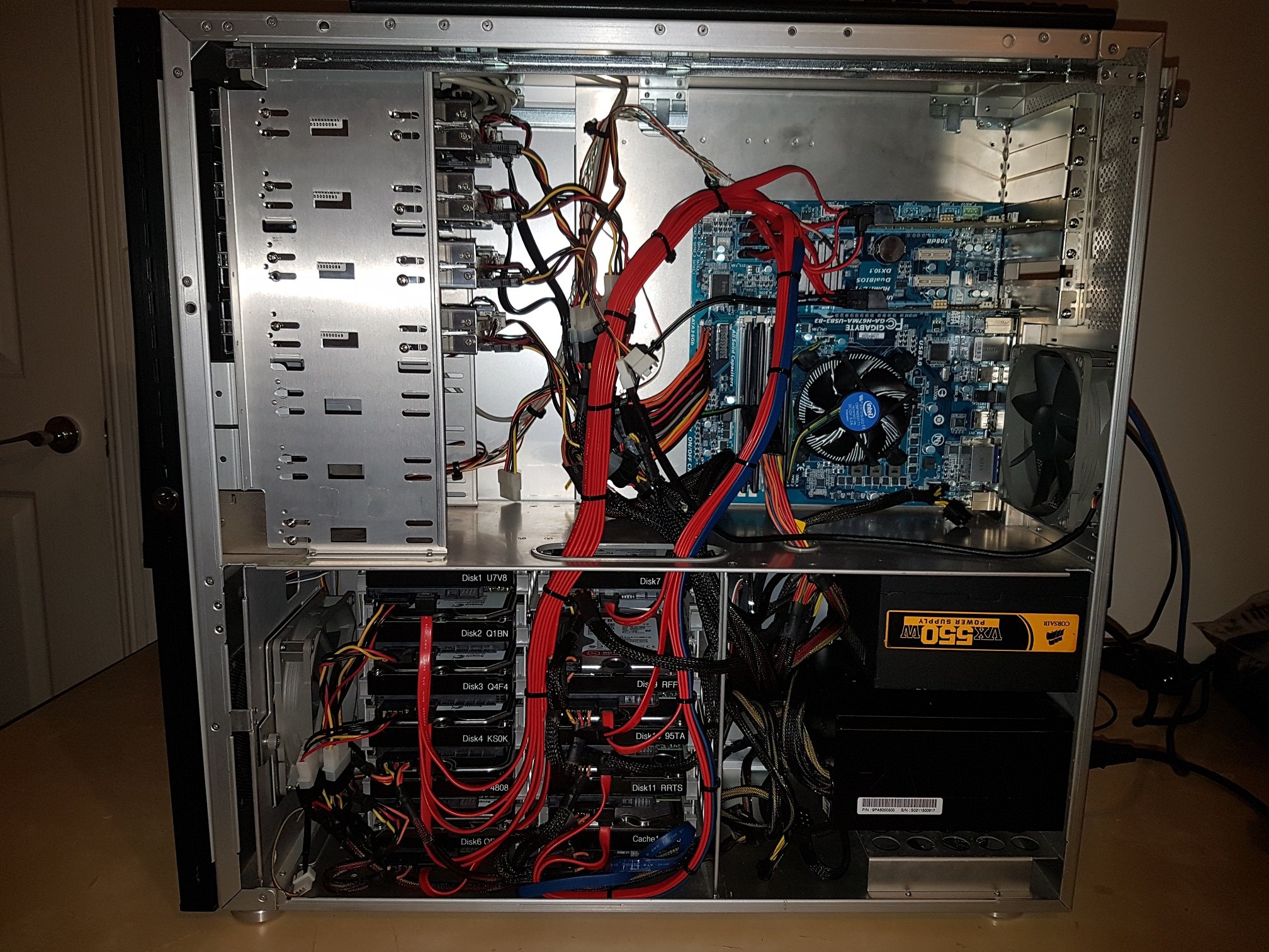

Not to over-complicate things but in full disclosure, the system is actually running off two power supplies, for no reason other than that the case supports them and I was testing power usage balancing the load between the two. Based on what you have said I suspect my TT 750 might be playing up, which is strange since it is actually powering less than it has been for the last few months.
I tested both the other night after it first failed and they looked OK but I might try swapping them around to see if this fixes anything.

Edit: Photo of the setup attached, if anyone is curious - disk 8 is missing as i'm running a WDDiag on it at the moment.
Edited by chickensoup
Photo added

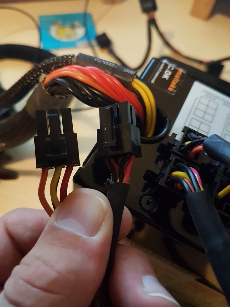

Sorry for the long reply but I think I've finally worked out what has happened.
It always felt like it was power related but the one thing I could never understand was why I was getting errors on some disks but not others- even when they were connected to the same chain off the same power supply cable. I thought at one point that maybe bending the cables in to shape to fit the case might have had some impact, since the power supplies are reasonably old (though good quality).
It took a few days of thinking about the symptoms and scratching my head; the comment about poor ground also got me thinking and then while sifting through my power supplies and cabling I had a realization.
I had 3 x Modular 6-Pin to SATA cables connected to my ToughPower 750W power supply. Turns out, the power supply likely only shipped with two of these and the one additional cable must be from a different PSU with a slightly different pin-out (I'm pretty sure there is no damage to the drives). My guess is the drives had 12V and Ground but that the 3.3V and 5V lines were swapped around. I feel like such an idiot.
The picture below shows the two TT cables connected to the power supply (top row G, 12V, G on each) and two more modular SATA cables I had in my stash. If I had to put money on it, I would guess that the one on the right hand side in the picture was also being used which is why the symptoms were so strange. Close enough voltage to be OK for a little while, but ultimately not what the drive was looking for.
Edit: All of the cable below are SATA to 6-Pin modular PSU cables, the one on the right in my hand at a distance, looks pretty much identical to the ones which shipped with the PSU.
