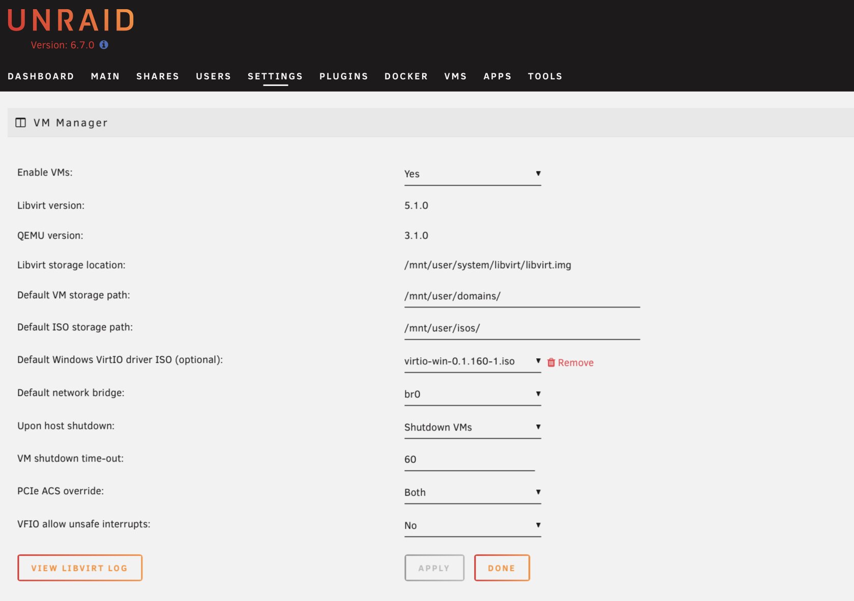

Do you have ACS Override set to Yes?
Here is a screenshot of my config
Both = ACS override downstream + multifunction. In that case, I recommend rolling back to the earlier version to see if it fixes.
I was on 6.5.3 for about a year because I couldn't update to any later version without severe issue (in my case, lagging like when 80386 was state of the art). Took me a while to identify ACS override to be the cause.
