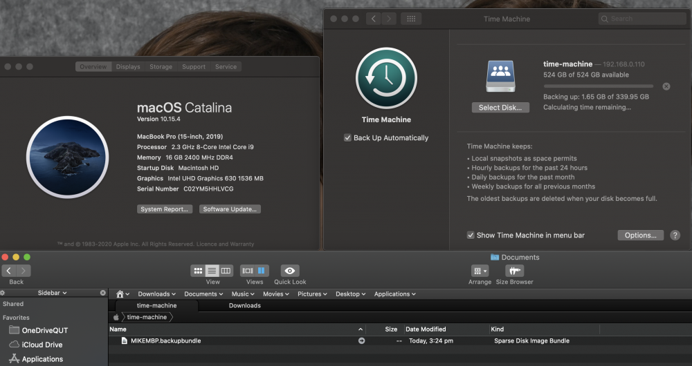

So my computer is running high sierra and I got it to run and work.  My wifes is running catalina and it won't show up at all.  Maybe I got lucky I am uploading High Sierra now on hers to see if thats the problem.  I will report back.
Just an FYI I did have to remove my existing disk for the new one to show up from Unraid

Hey you need to have High Sierra up and running I took my wife's laptop and wanted to get her stuff backed up and couldn't with catalina.   When I did the update to High Sierra and followed the video it works perfectly.
1 hour ago, SpencerJ said:
Thanks. Iirc, this guide was made using high sierra. Please let me know and I will have to update the guide if catalina is the issue.
Yeah Man no problem.  I think you need to have High Sierra for sure.  Got it working when I updated my wife from catalina
Thanks! I will update the wiki and try to figure out what broke with Catalina....

Yeah I got Catalina 10.15.4 and no luck with TM over SMB.

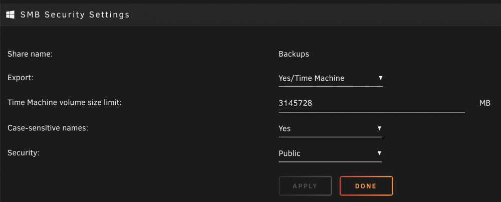

Hey, y'all. The issue with creating a Time Machine share with Catalina is due to a misconfigured setting in the share's .cfg file. For an SMB .cfg, Apple expects a setting to be passed called 'shareFruit'. For whatever reason, even when following @SpaceInvaderOne's video setup, the .cfg file passes a 'no' for that setting. Once you change the setting to yes, you'll be able to see it in Time Machine. The file is located at /boot/config/shares/***.cfg (*** being the name of your Time Machine share).
I've reported the issue last week. It may be helpful for some people to comment on the bug report stating whether the change worked:
https://forums.unraid.net/bug-reports/stable-releases/683-time-machine-share-r930/

I assume unRaid enables Avahi when macOS interoperability is enabled and I don't see anything in the config files supporting catia, streams_xattr, or spotlight, but it seems to work great between Avahi and the fruit module.

I changed it and rebooted and it was changed back to no again.
How do you get it to survive a reboot?
