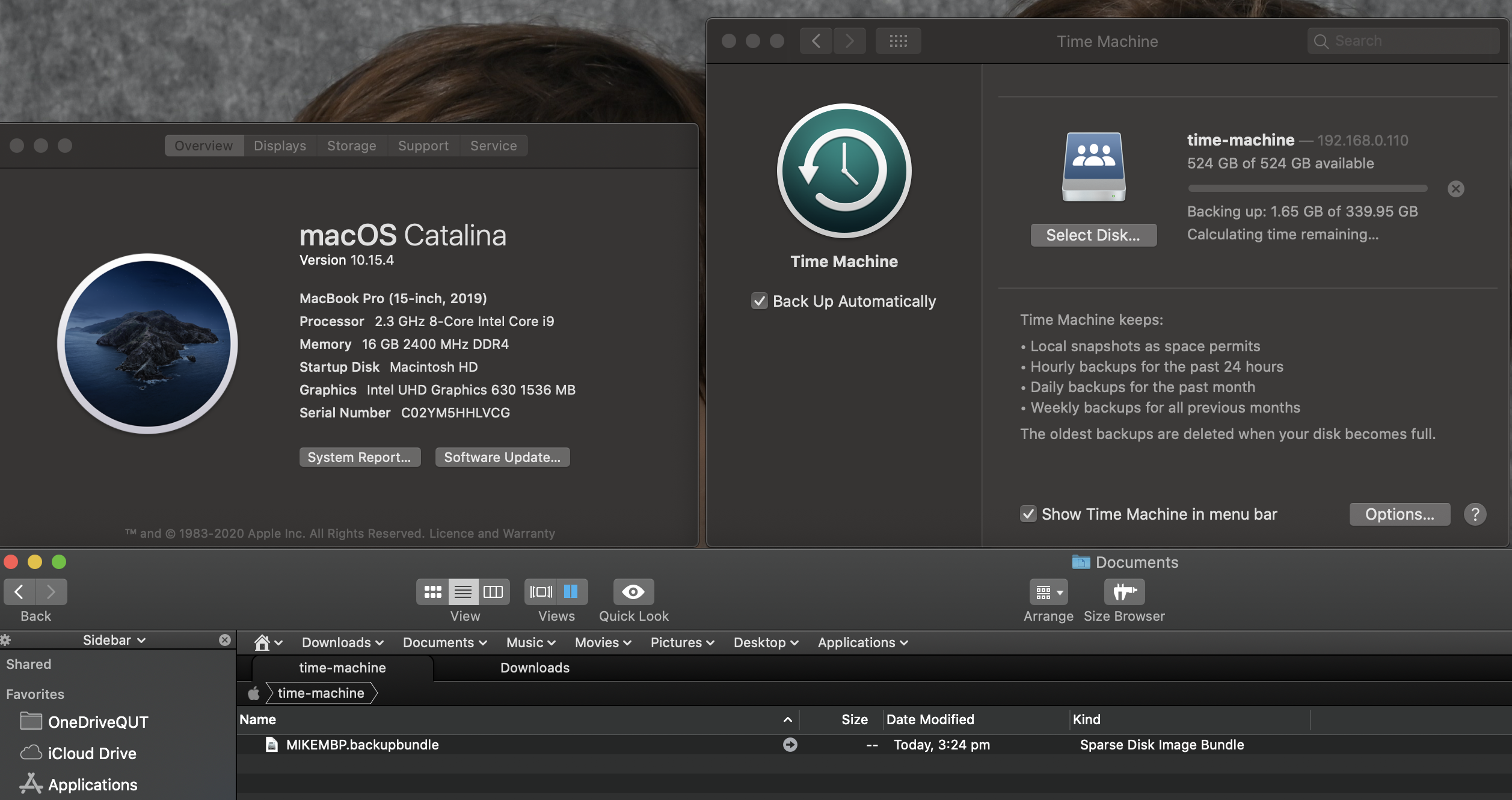

Hi guys, new to Unraid and have just set my time-machine up according to Spaceinvader one's video. It worked perfectly fine, no cfg file change needed. I did connect the share in Finder using the IP address as the hostname tends to be finicky and disconnect sometimes.
I'm on Catalina 10.15.4 and Unraid 6.8.3 if that helps. Currently doing my initial backup. I will test the restore once it's completed.
Thanks @partyhat and welcome! I hope we can all get this working.
