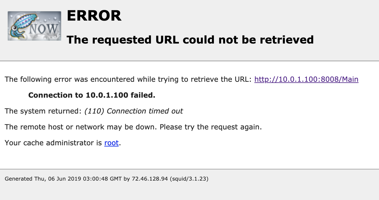

So I've had a disk or two fail with read errors in the past 2 months.  I just recovered from a failure, and was preclearing my hot spare.  I came home today and to check on it, and noticed it was almost done.  However, while interacting with it, the Unraid WebUI became unresponsive.  I can still SSH in, so I grabbed the diagnostics (attached), but it looks like both my main Unraid WebUI and all Docker WebUIs are unresponsive.  If I try to access the WebUI, I get the error in the attached image.  It looks like maybe the webserver itself is up, but Unraid is down.
