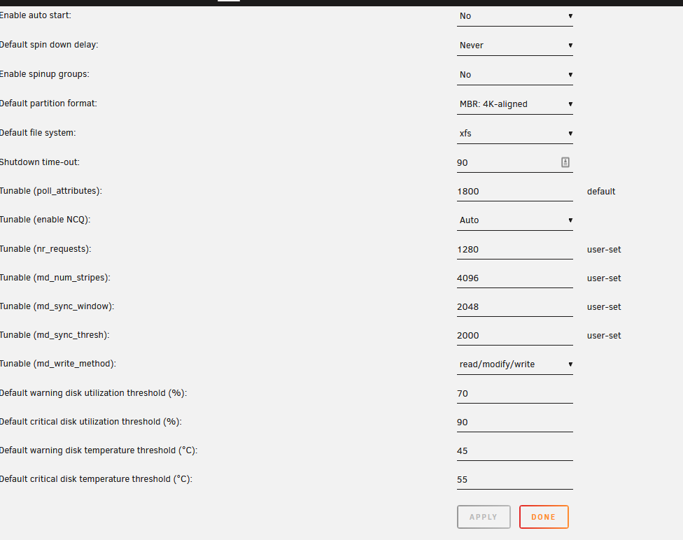

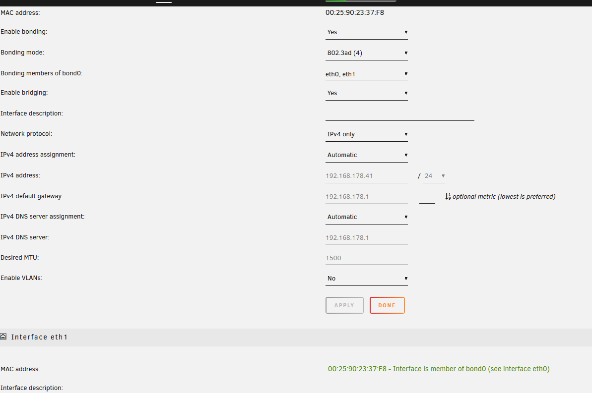

I have upgraded my unraid server with a better network connection. Now I have 90 MB/s if I write something to the array... but only if I upload one large file! If I would upload a lot of little files like 100 4KB files the server goes down to 200 KB/s. That's not normal !!!
what can I do?
Here are some pieces of information...

In your 3rd screenshot, try changing Tuneable (md_write_method) to reconstruct write (used to be called turbo write).
Writing a lot of small files will always be slower but the impact of parity will be more severe because it requires repeated seeking and switching between reading and writing. Reconstruct write helps at the cost of needing the rest of your array spun up. As long as the rest of your array is decent with random read, it generally will help.
Also, remember your network adds latency and latency is a lot more important with small files. Having to wait 0.1s/file due to network latency is nothing for a 1GB file but for 1000 1MB files, it's 100s!
