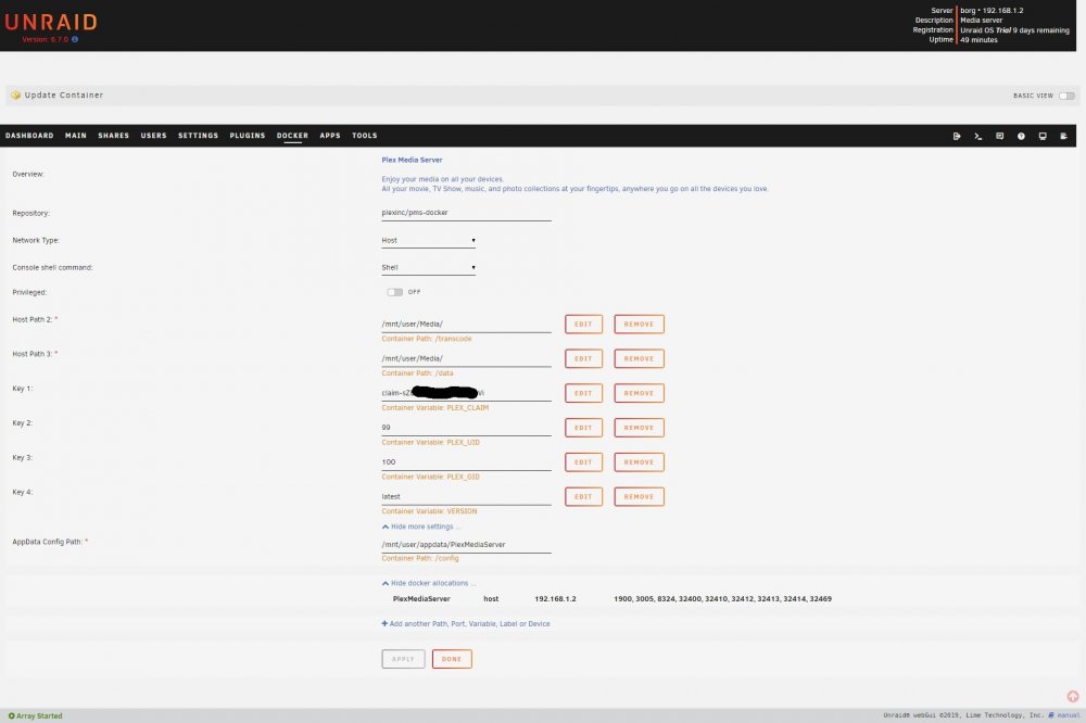

Plex now runs on the same IP as my unRAID server 192.168.1.2. The only thing I now have installed is Plex from plexinc/pms-docker repo installed from the community app (store thingy). I have all my libraries in Plex setup and it's got all the meta data in there too. Life is wonderful.

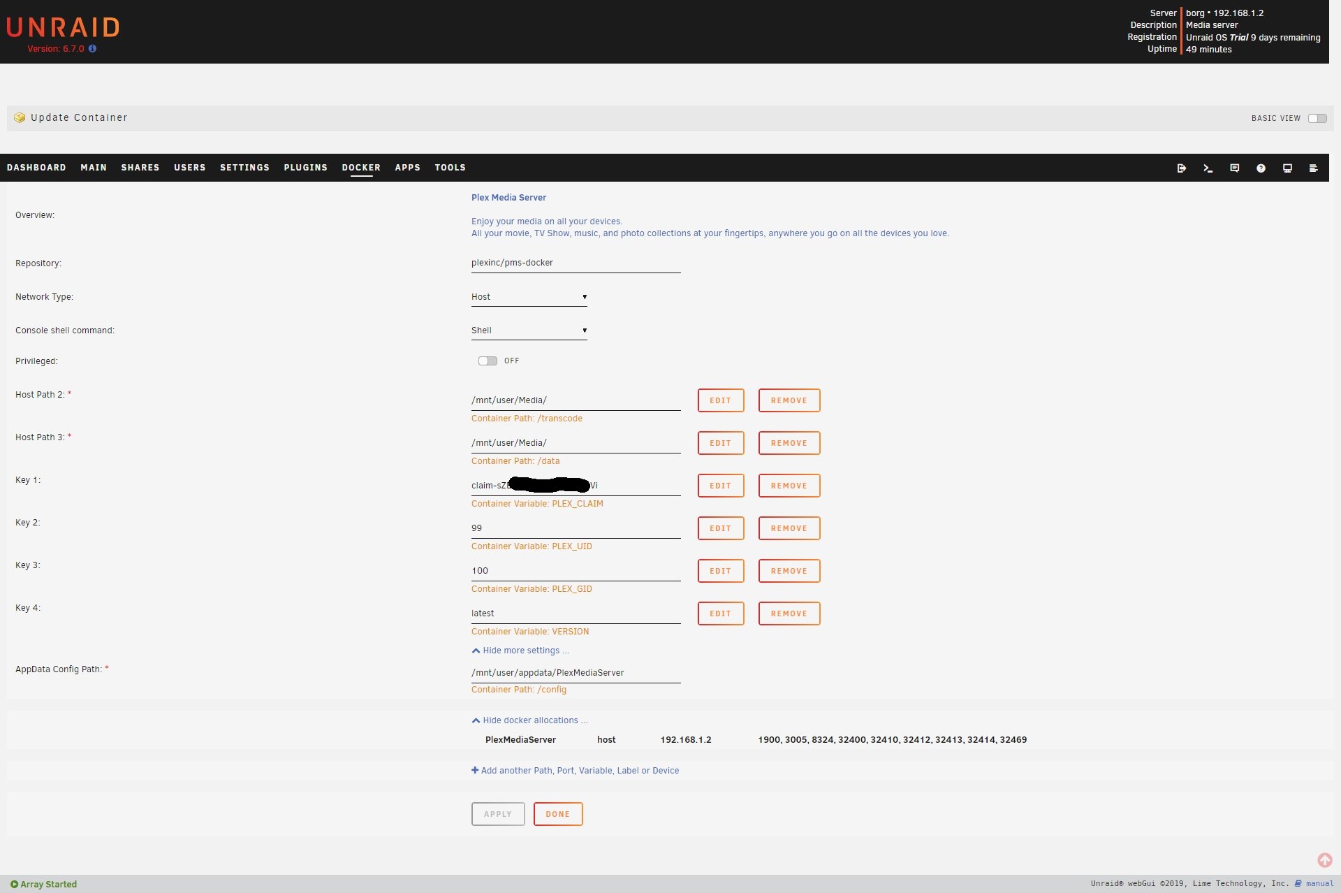

Added images (removed potential sensitive info)

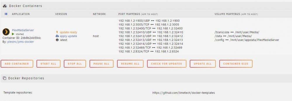

There is something I was always puzzled about. Why docker shows so many ports being mapped since I thought plex only required one (either the 32400 or a custom one which I don't use)

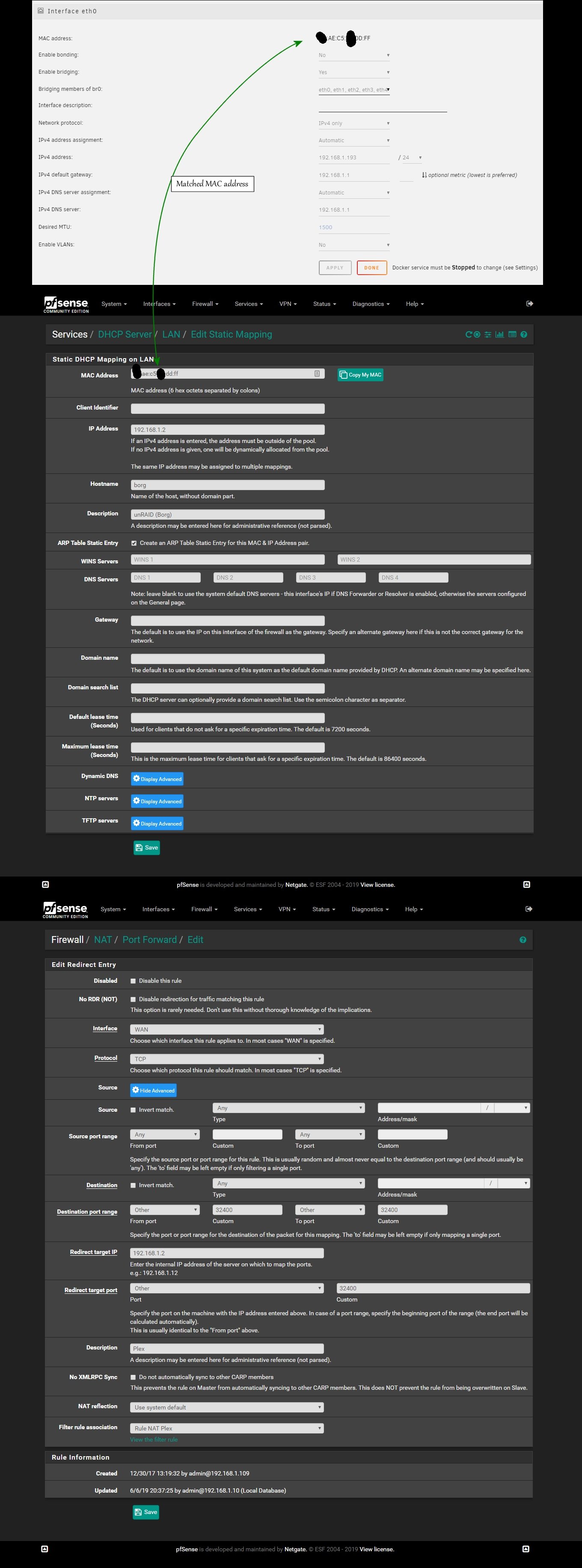

I've looked at my settings again for unRAID and pfSense and supplied the image below. In summary:
The MAC addresses match from Eth0 and pfSense DHCP reservation yet after restarting unRaid it has been assigned 192.168.1.193
The current NAT rule should not be doing anything as it is applied to 192.168.1.2 and I can confirm that 32400 port is closed from outside of my network (how Plex is working I do not understand)
I'm going to see if I can get this moved back onto the IP address 192.168.1.2 and remove the NAT rule all together to see if that's the ultimate cause of the original complaint I had (no access to outside my network to Plex server).
Please feel free to chip in on anything that looks odd with anything that I'm doing.

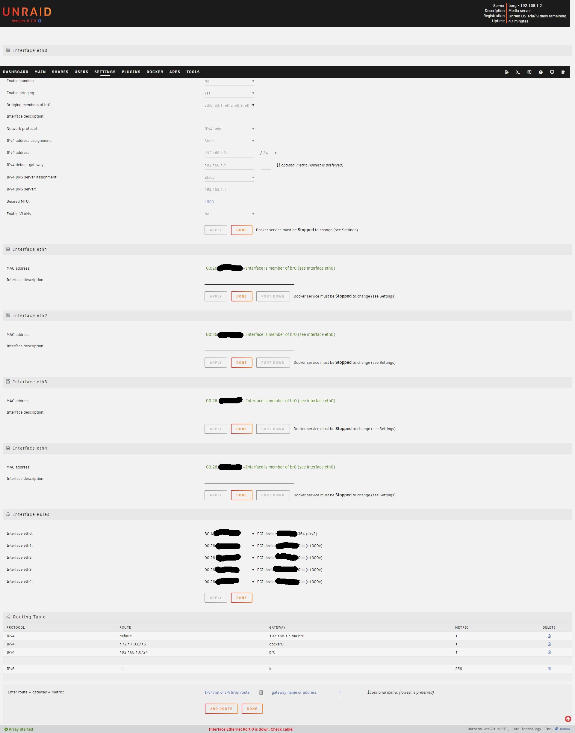

I noticed that a NIC that I was using to assign a static IP was reporting as disconnected which explains why the IP assignment wasn't working properly.
Since putting that in place having the NAT rule disabled Plex works fine. I went back and enabled it which then didn't have any issues. I've tried restarting and everything seems stable. I think I'm just going to disable the NAT rule since it clearly works without it (for now at least).
