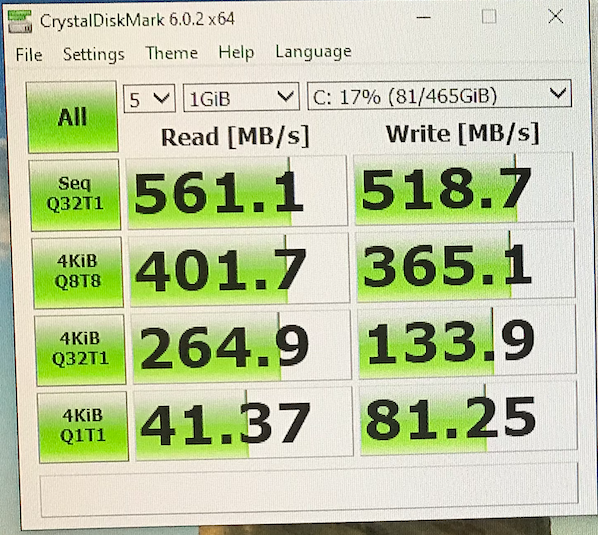

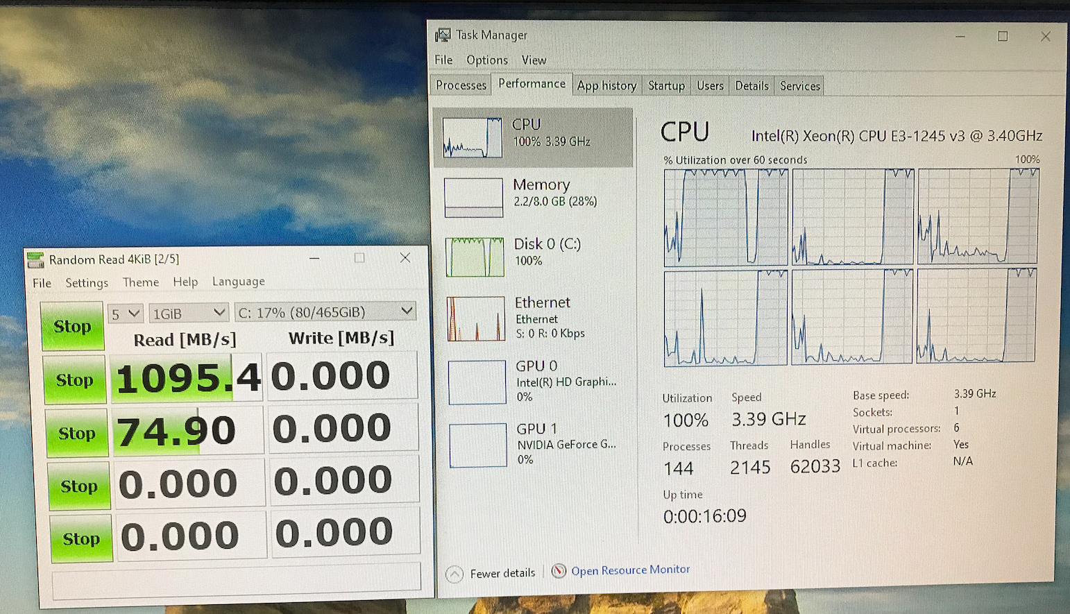

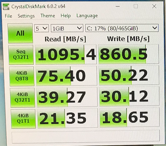

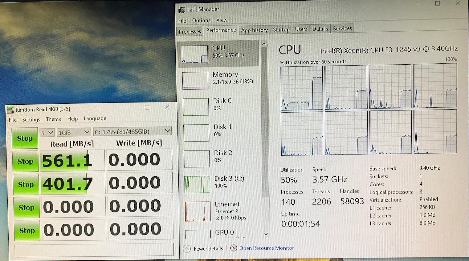

Hello, just setup a new build for UnRaid, created VM Windows 10 and SSD (Unassigned Device) is passed through to VM Win 10.
I have noticed the read/write performance in VM Win 10 is not great. When comparing Win 10 in VM with directly loaded, I can feel the speed of opening the application is slower, and thus I have done the disk test as below. I have also noticed CPU usage is 100% when I was doing the test in VM. I would like to know is this result is expected or there is anything else that can be improved? Thank you.
CPU: Xeon E3-1245v3 (Assigned 3c 3t to this VM)
Motherboard: Gigabyte H97n-wifi

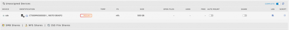

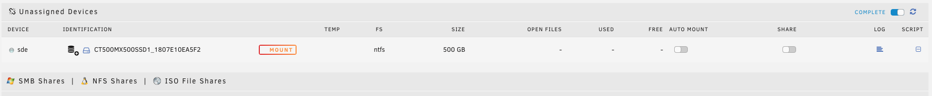

SSD: Crucial MX500
## VM Win 10 in UnRaid
1015666824_Screenshot2019-06-08at8_47_14PM.thumb.png.0be1d44ef76576b9da525c197fde6007.png
## Win 10 loaded directly
369273922_Screenshot2019-06-08at8_46_38PM.thumb.png.888b845556ff8acc91d775c6592c3694.png
