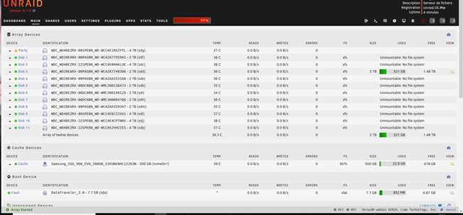

Hello everyone,
I disabled 10 disks from my server to test
In the disc of the discs
With a message "Unmountable: No file system"
«Unmountable disks present: with the list of 10 disks and me the formatting request
My parity disk was not used during my tests
The disks were in "xfs" format now declare in "auto"
Messages in "System Log"
bad option, bad superblock under / dev / md1, code page or auxiliary program missing or other error.
What solution to adopt to recover data
Thank you for your help in advance

Except for disk3 all disks appear to be missing a valid filesystem, but disk3 is the only one set to xfs, all the others are set to auto, auto should work fine but try changing all the other disks to xfs, with the array stopped click on each disk and change the filesystem to xfs, then start array and if post new diags.

it does not change anything
Not unexpected, but at least now we see why they aren't mounting:
Jun  9 12:51:24 berry kernel: XFS (md6): Invalid superblock magic number
Superblock is damaged, and you didn't answer my question:

In any case you can run xfs_repair on each disk, it will search the disk for a backup superblock, if those are not also damaged it should recover the filesystems.
https://wiki.unraid.net/Check_Disk_Filesystems#Drives_formatted_with_XFS
after running "xfs_repair" all my disks are visible, I miss 11% of the data.
I miss 22 shares and have created a "lost + found" shares
how to put all that in order
attached new diagnostic
berry-diagnostics-20190609-1559.zip
By manually browsing each lost+found folder and moving the contents, or if you have them by restoring from backups.
