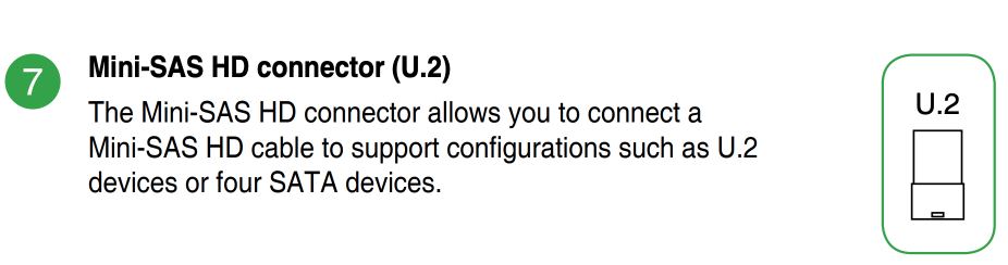

I think it's missing in the manual, only this is said about the U.2 connector :
2050421298_E15611_Pro_WS_X570-ACE_UM_V2_WEB.pdf2019-07-1111-09-35.png.23074cd830f9f0b5448e6925722ba744.png
The marketing page say :
Ultra-fast storage: Up to 64Gbps M.2 & 32Gbps U.2, plus up to 10Gbps back-panel USB 3.2 Gen 2 with Type-A and Type-C ports
Speed up with onboard M.2 & U.2
With x4 PCI Express® 4.0 bandwidth, Pro WS X570-ACE features up to 64Gbps M.2 and U.2 for faster data-transfer speeds — ideal for an operating system or application drive.

U.2 = Future Use ?  (Maybe re-use my Samsung EVO 840 500GB SATA SSD for VM Passthru?)
Question : Would you use U.2 4 SATA instead of SATA1 to SATA4 on the board instead of what I proposed here?
Should be identical, performance wise.

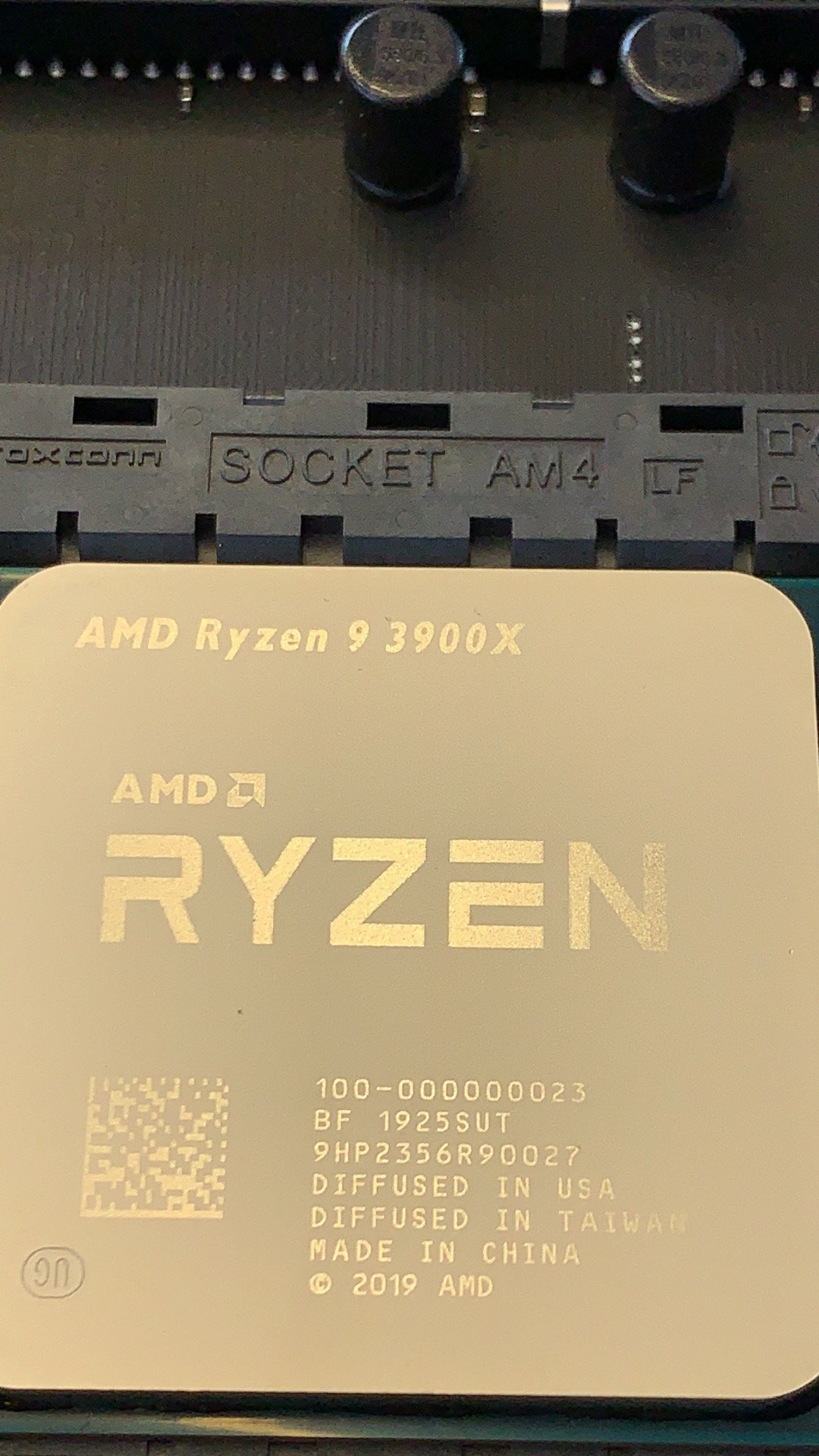

UPDATE !!  I got my Motherboard and CPU :) I assembled my test bench with :
Corsair MP600 1TB
3 x Western Red 3TB
1 x EVGA 1080ti
2 x 8GB Corsair DDR4 3200Mhz (Temporary until Tuesday when I’ll get my 2 x 16GB Corsair DDR4 3200Mhz)
i did put the Unraid USB key I just created for the purpose of this test, powered ON and it booted to Unraid!
i only have a trial key but that should be enough ;)
i still need to Update the motherboard BIOS because it came in on a very old BIOS of May 2019!  I haven’t tried Installing Windows 10 either. It was just an initial boot to check if the platform would at least boot!
This is what I plan to test :
1. Update BIOS and enable IOMMU
2. Install Community Apps ans Unraid-NVIDIA build.
3. Create an array of 1 Parity, 2 data disk and 1 cache disk.
4. Create a Win10 VM and passThrough a Keyboard/Mouse and the 1080ti
5. Install Plex docker and add couple of movies to test Hardware decoding with the 1080ti (will be the 1060 6GB in my real system)
any other tests people want me to do on the platform?  How can I test stability?
Edited by Pducharme
