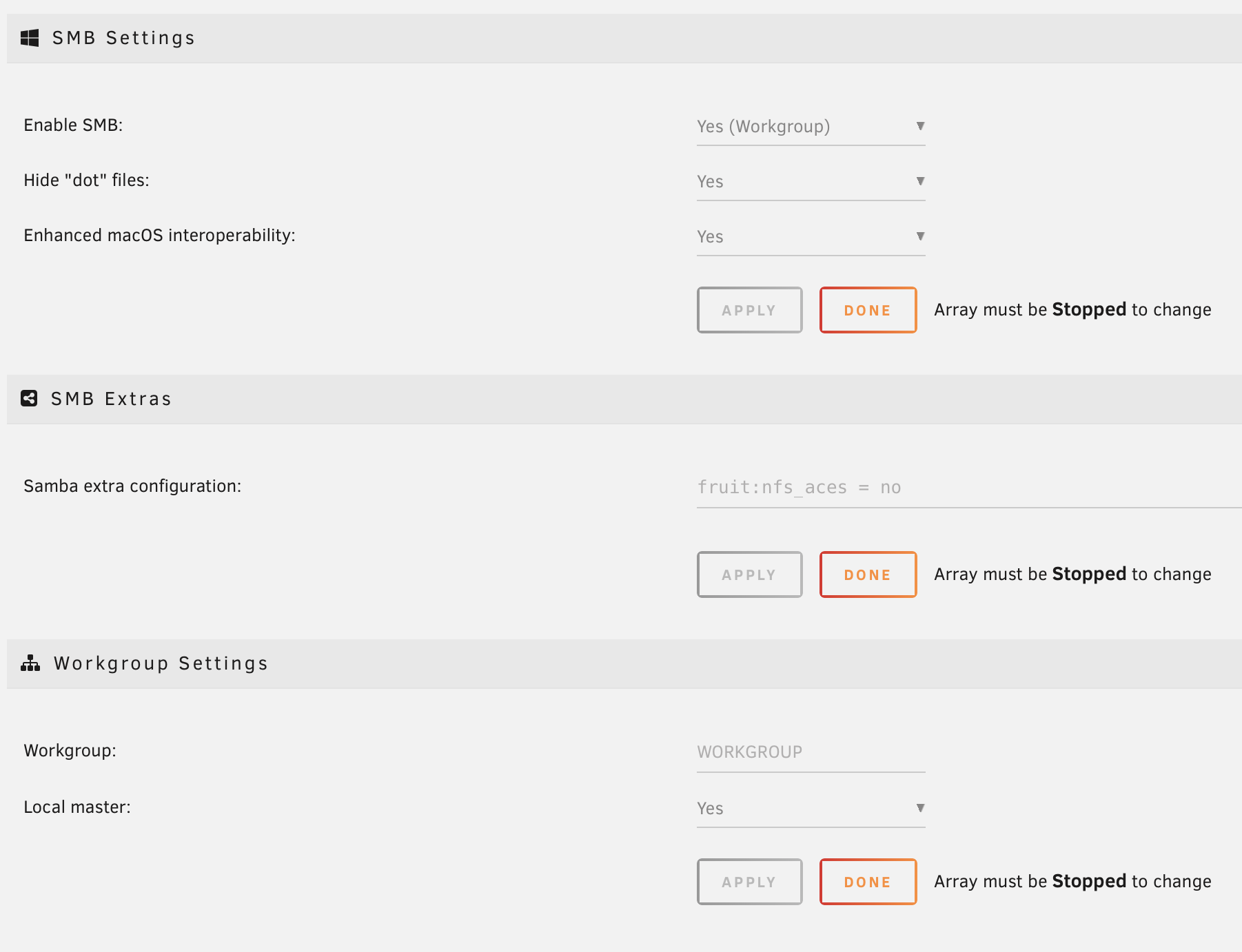

  2. Would anyone mind helping to explain the 2 Mac related settings when upgrading to Unraid 6.7:
    1. smb: when Enhanced OS X interoperability set, include "fruit:nfs_aces = no" to be compatible with Unraid security model (I'm assuming this just means typing "fruit:nfs_aces = no" in the blank under Settings > SMB > Samba extra configuration, correct?)
    2. smb: disable samba auto-register with avahi for now (No idea what this means.)

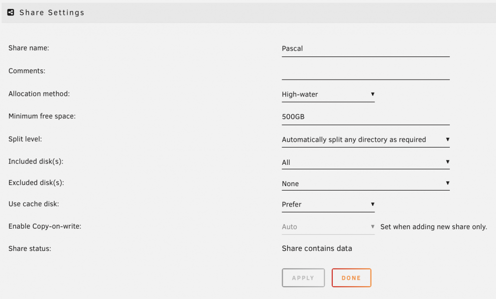

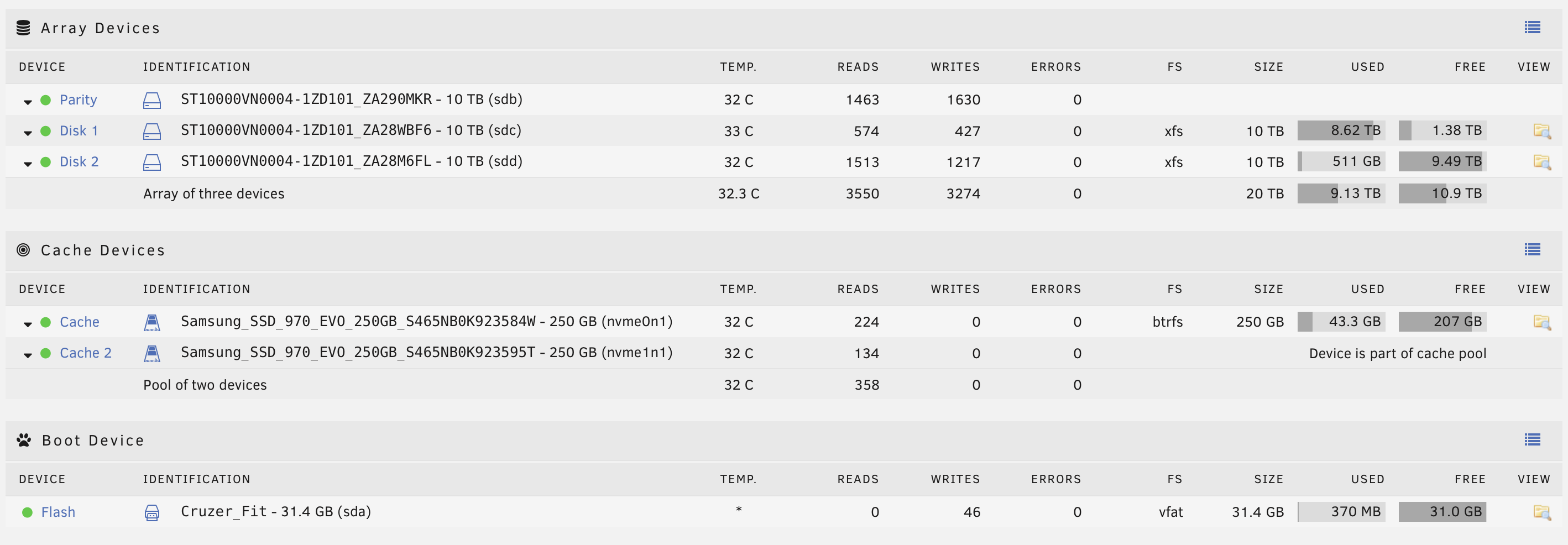

Cache:
Yes, cache is involved. Sorry, I should have mentioned that. I'll include screen shots of all my settings in a corresponding message, but I've got 2 of the 250GB NVMe 970 EVO SSDs using btrfs for cache. Before the upgrades (MacOS 10.14.5 and Unraid 6.7), the speed was fantastic. Probably, 250MB/s - 350 MB/s. It's been so long since I've had issues, I forgot the exact write numbers. Definitely not the 50MB/s I'm getting now. The 1gbe get's 109 MB/s, as expected with 1gbe, so it's definitely something to do with 10gbe and SMB. In past versions of MacOS I had to put "max protocol = SMB3_10" in the Unraid SMB Extra Config settings, but I don't think that's required anymore.

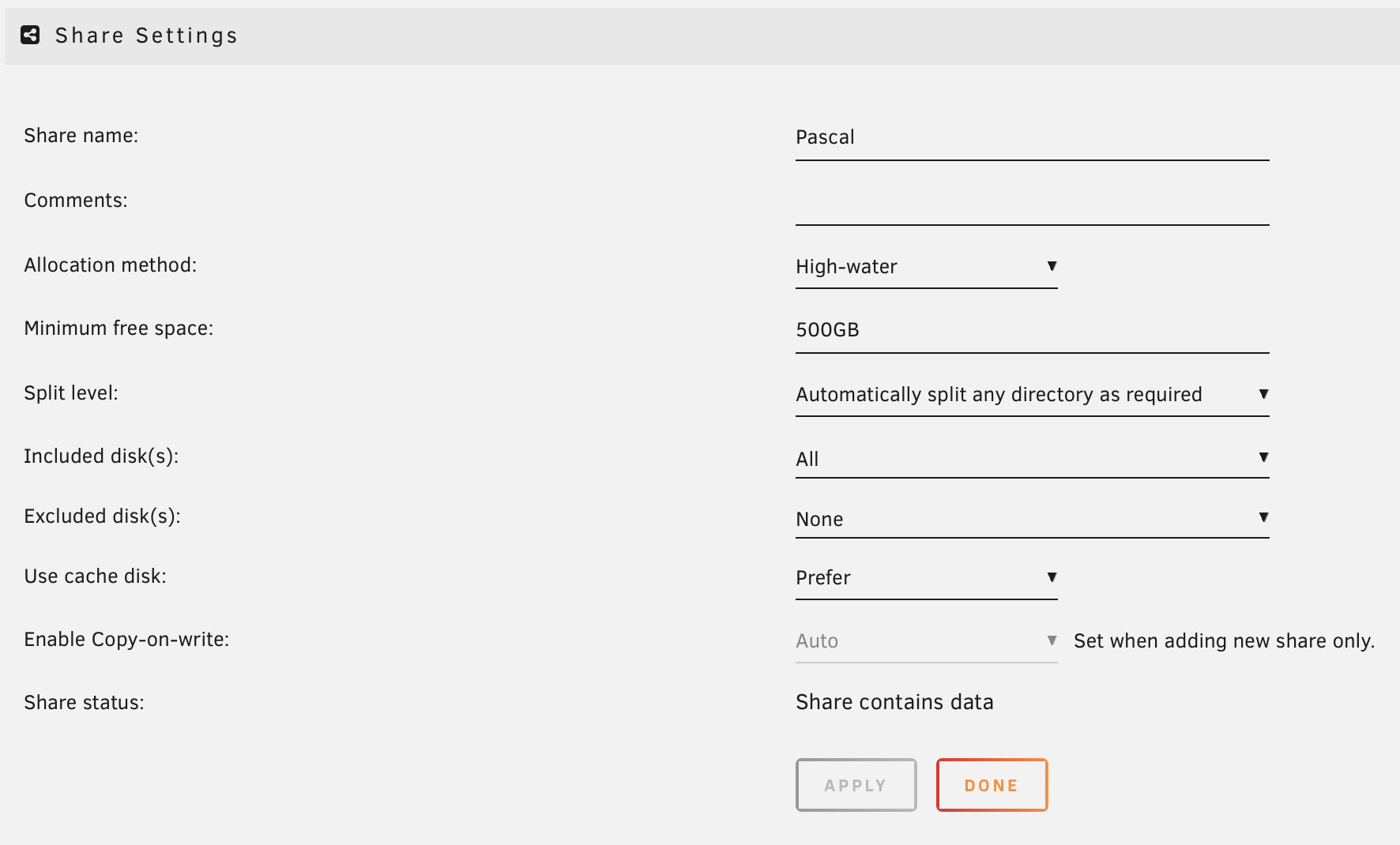

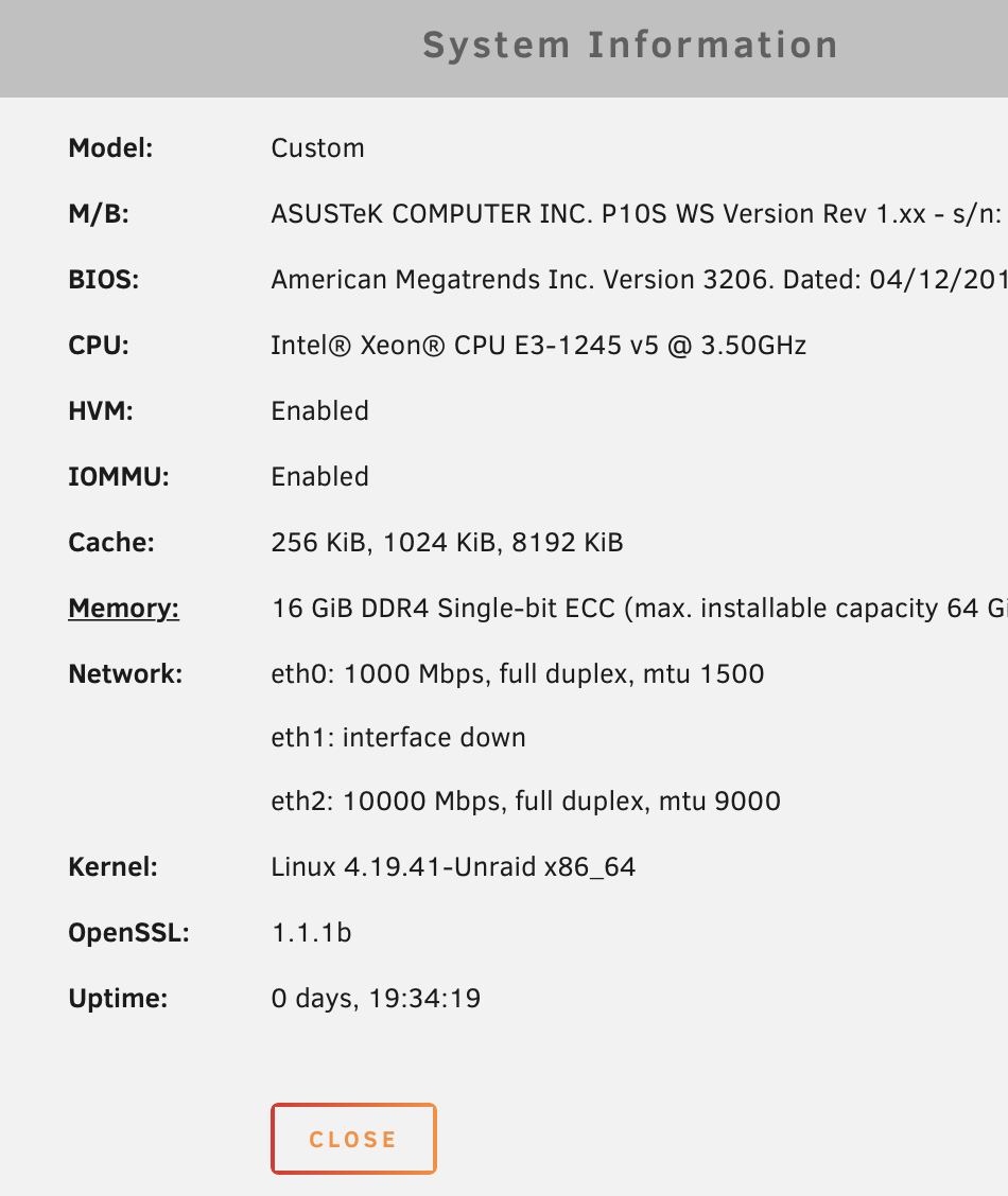

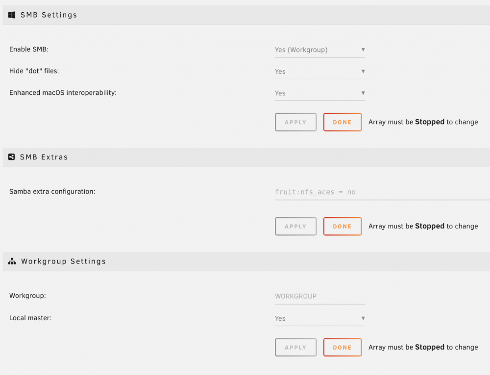

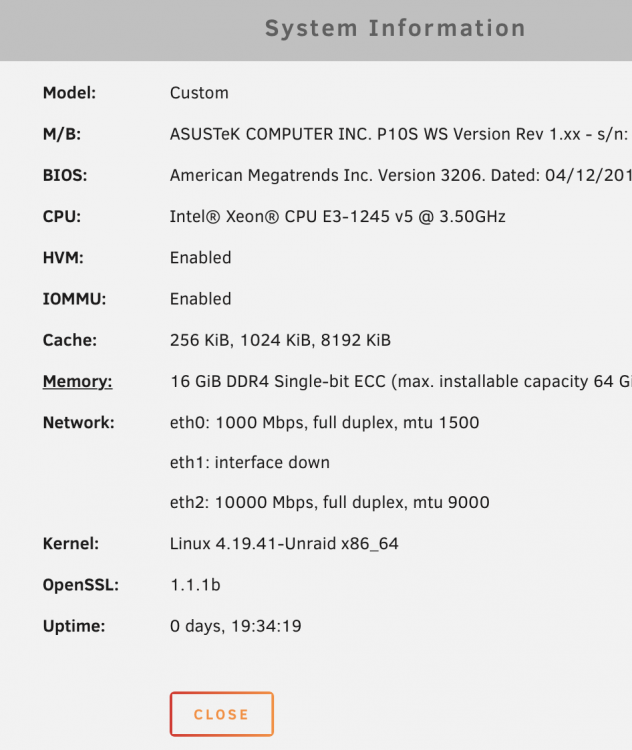

Oh.... here are my configurations settings:

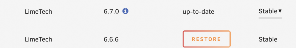

As a last resort, I am also thinking about downgrading the Unraid back down to 6.6.6 for now to see if there is a difference with that. Never downgraded Unraid before. I'm assuming that's safe, since they give a nice clean button for it. Is that a bad assumption? :)
107760238_ScreenShot2019-06-09at3_28_37PM.thumb.png.9a6003b61ba1248fd98f2a636decedc8.png

I won't get to it today, but, my smb extras text is:
max protocol = SMB2_02
#unassigned_devices_start
#Unassigned devices share includes
   include = /tmp/unassigned.devices/smb-settings.conf
#unassigned_devices_end
Looking at this, I remember when I was tuning it a year or so ago, I read somewhere that limiting to smb2 was a best practice for macOS 10gbe...  You might give it a try.
Also, my osx enhanced operability is set to no, not sure why I never enabled it.
Edited by 1812
Thanks so much for your help! SMB2_2 was definitely worth a try. Unfortunately, that didn't work either. No difference. What's in: /tmp/unassigned.devices/smb-settings.conf  ?

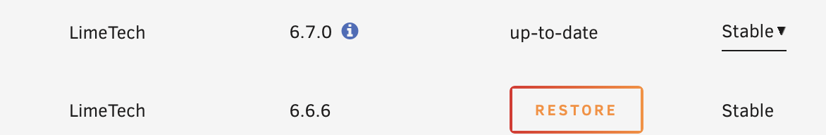

Ok... so here is what I've done.
SMB:
I downgraded back to 6.6.6 and tested SMB. The speed was still 50MB write and 450ish read. Therefore, I think it's safe to say that the speed issue is not Unraid.
AFP:
Although there are settings for AFP in Unraid 6.7, it no longer works. That's actually the reason why I was trying to use SMB in the first place. Downgrading to 6.6.6 does allow me to use AFP properly again, which gives me speeds of 397MBs write and 790MB/s read.
I think I heard that Apple was releasing more support for SMB in 10.15 this Fall. If that's the case, I might just use AFP via Unraid 6.6.6 until 10.15 comes out.

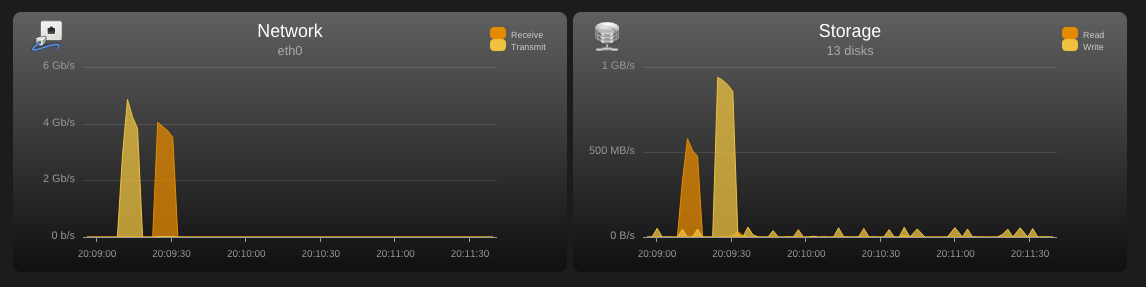

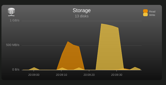

Good news bad news
Good news: I got to test this already
Bad news: it works fine for me on 10.14 using solar flare 10gbe card.  This is about a 3GB video file.
543151470_ScreenShot2019-06-09at8_11_35PM.thumb.png.2138dc9628ae222722c06260577e7974.png
So either it is a problem with the adapter, or thunderbolt.
ALSO reset your MTU back to 1500 on both the Mac and the 10gbe port on the server. Worst case is that its slower. Best case is you had a MTU mismatch killing your write speed.
