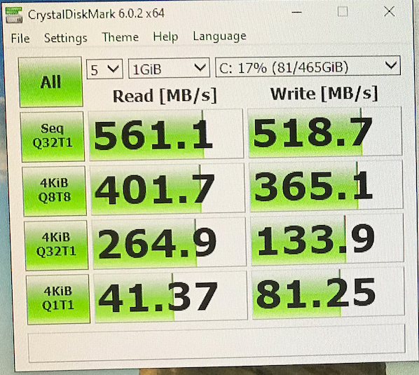

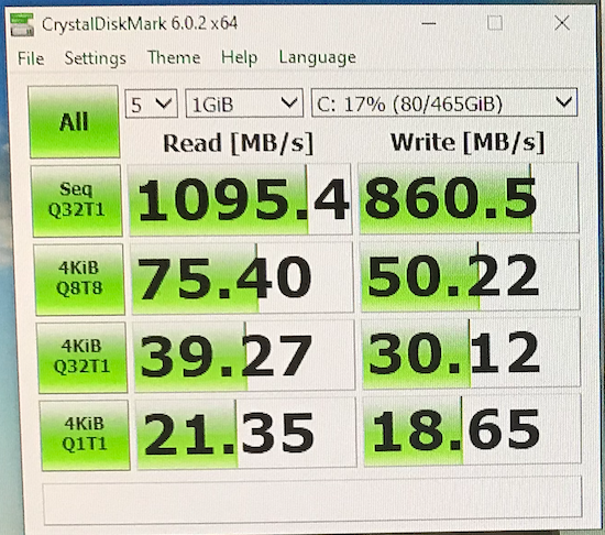

Hello, just setup a new build for UnRaid, created VM Windows 10 and SSD (Unassigned Device) is passed through to VM Win 10.
I have noticed the read/write performance in VM Win 10 is not great. When comparing Win 10 in VM with native Win 10, I can feel the speed of opening the application is slower, and thus I have done the disk test as below. I would like to know is this result is expected or there is anything else that can be improved? Thank you.
CPU: Xeon E3-1245v3 (Assigned 3c 3t to this VM)
Motherboard: Gigabyte H97n-wifi
SSD: Crucial MX500
Tested but result is same:
1. Bus: SATA, VirtIO, SCSI
2. Win 10 installed on SSD in UnRaid cache
3. Win 10 installed on SSD passthrough (Unassigned Device)
## VM Win 10 in UnRaid
727188979_InVM.png.8390a82c395f062dabcf234bd92250db.png.3c4660aceec12cd711c5af3d0e39d832.png
## Native Win 10
774173380_Screenshot2019-06-08at8_32_15PM.png.a66e4f25982088adb2071d8e575e74ae.png.52b195d26b21fe8c965e132c6224cd98.png

16 hours ago, Coffee said:
<disk type='block' device='disk'>
      <source dev='/dev/disk/by-id/ata-CT500MX500SSD1_1807E10EA5F2'/>
      <target dev='hdc' bus='sata'/>
      <boot order='1'/>
      <address type='drive' controller='0' bus='0' target='0' unit='2'/>
    </disk>
Sata isn't the best option. It has more overhead and latency as using virtio or scsi. If you switch it, you need the drivers installed on Windows first or it won't boot. Add a small dummy hdd (1G) as scsi first, mount the virtio driver iso, boot up your VM and install the driver (vioscsi/win10/amd64). You can remove that disk after that. Change your xml like in the following example.
      <driver name='qemu' type='raw' cache='none' discard='unmap'/>
      <target dev='hdc' bus='scsi'/>
      <boot order='1'/>
    </disk>
You should see better performance with this. The hosts RAM isn't used for caching with this and trim operations performed on the guest will be passed through to the device itself which isn't possible with sata.
Edited by bastl
I had this a while ago and couldn't get anywhere near bear metal performance.
You can get quite complex with this and start looking into IOthread pinning to help, but there's only so much you can do with a virtual disk controller vs a hardware one.
You'll probably notice a bit of a difference if you use the emulatorpin option to take the workload off CPU0 (which will be competing with unraid stuff). if you have a few cores to spare, give it a hyperthreaded pair (one that you're not already using in the VM).
In the end I got a PCIe riser for an NVME, and passed that through to the VM. You get about 90% of the way there performance wise compared to bare metal as the controller is part of the NVME itself.
Good luck.
  • 8 months later...
Good luck.
Thanks for posting! I just bought the v2 version of the Asus Hyper m2 nvme x4 Riser based on your recommendations, and I was wondering what vDisk bus you used when passing through your nvme drive (VirtIO, SCSI, or SATA)? I used SATA, but it doesn't seem to be quite as 'snappy' as I had hoped. Did you use SCSI like suggested above?
Edited by DoeBoye
Neither. To get performance at 90% of bare metal, you need to pass it through as a PCIe device (i.e. stub it and then select it in the other PCIe device on the VM template GUI). Everything else won't get close to 90% and very certainly not SATA.
+1
