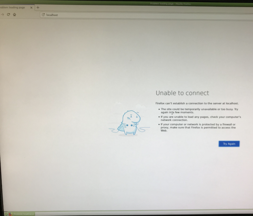

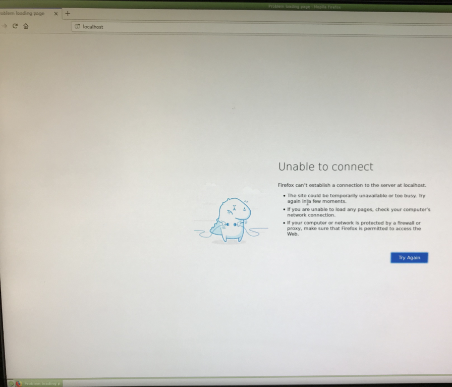

HELP! I did a shutdown and a reboot with GUI and now I get this;
I can connect using putty? and I did make some standard backup (Video guide) but I have no clue on how to get it restores without a UI?
Best regards
Casperse
UPDATE I have also access to the flash drive through SAMBA (Other drives is not there because they need to be mounted through the UI (Encryption)
So if I need access to the backup I need to start the array through the terminal and somehow type the password?

The array is not set to autostart
Edited by casperse
2 minutes ago, casperse said:
would booting it up in safe mode be okay?
That is never a problem.   It is a good way to check that a plugin is not causing issues as in Safe Mode no plugins are run.
I have created a new USB boot and replaced the config folder with the one I can access from the old drive?
Would it be safe to try to boot from this USB? or is that a no go?
Ok booting in safe mode made no difference
I am getting really worried now!
1) Booting in safemode same thing no UI Webservice
2) Creating a new USB and copying the config folder to that new USB and booting from it same problem?
Could I end up loosing all my data? I have the encryption password and should be able to decrypt even if I need to start with a brand new fresh install of Unraid right?

The problem is that nginx (the http server) is crashing:
Jun 10 18:18:53 PLEXZONE emhttpd: shcmd (26): /etc/rc.d/rc.nginx start
Jun 10 18:18:53 PLEXZONE root: unable to load certificate
Jun 10 18:18:53 PLEXZONE root: 22497627080512:error:0909006C:PEM routines:get_name:no start line:crypto/pem/pem_lib.c:745:Expecting: TRUSTED CERTIFICATE
Jun 10 18:18:53 PLEXZONE root: Starting Nginx server daemon...
Jun 10 18:18:53 PLEXZONE root: nginx: [emerg] PEM_read_bio_X509_AUX("/etc/ssl/certs/unraid_bundle.pem") failed (SSL: error:0909006C:PEM routines:get_name:no start line:Expecting: TRUSTED CERTIFICATE)
Jun 10 18:18:53 PLEXZONE emhttpd: shcmd (26): exit status: 1

Not sure the exact issue but something is wrong with your SSL cert.  This is not included in diags (obviously) but should be on the flash in config directory:
config/ssl/certs
named either certificate_bundle.pem or PLEXZONE_unraid_bundle.pem.
I suggest you delete any pem files (or rename them to different extension) you find there and then edit the file config/ident.cfg.
Find the line that say:
USE_SSL="auto"
change to:
USE_SSL="no"
Now your server webGUI should answer up at PLEXZONE.local or use it's IP address.  Next you can go to Settings/Management Access and re-enable https (set back to Auto) and let it download a new LetsEncrypt cert.

Thanks that solved it !!!
