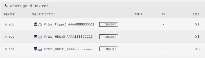

After a fresh reboot, I see this:
My first HDD starts at sde so it's kinda annoying. I've fixed it in the past by not having any Windows VMs. Annoying, again, and the win2008R2 VM I currently have I do need. I obviously don't have any floppy disks on that VM nor anything special in the XML as far as I know (it does it pretty much with any version of Windows installed in any VM but maybe it's just random and I'm going crazy).
Here are diagnostics.
I've had this issue for months if not years, currently on the latest unRAID version. Any help would be greatly appreciated.

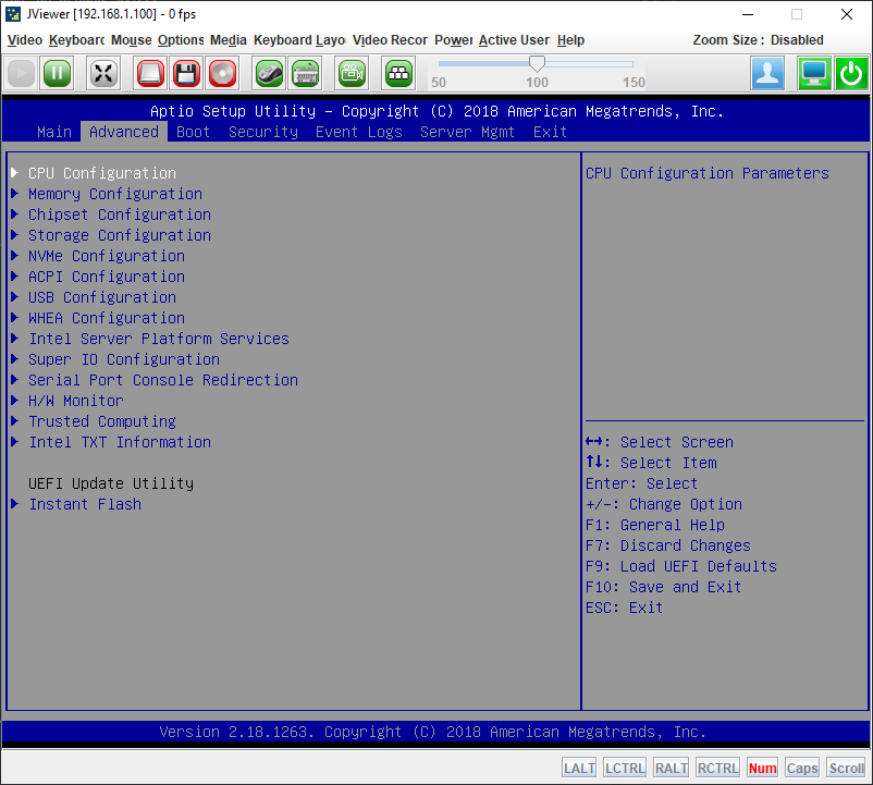

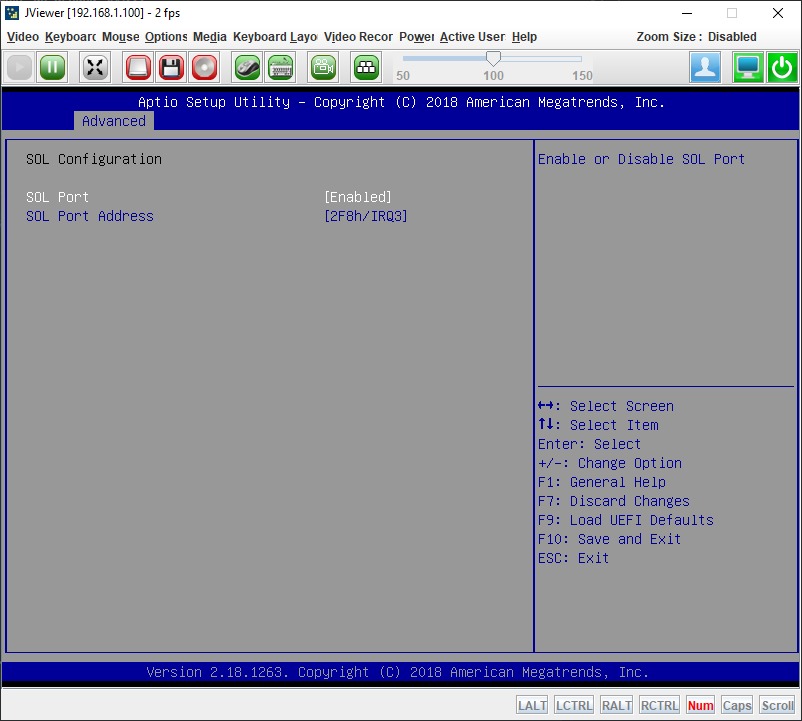

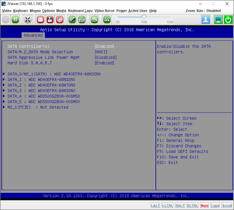

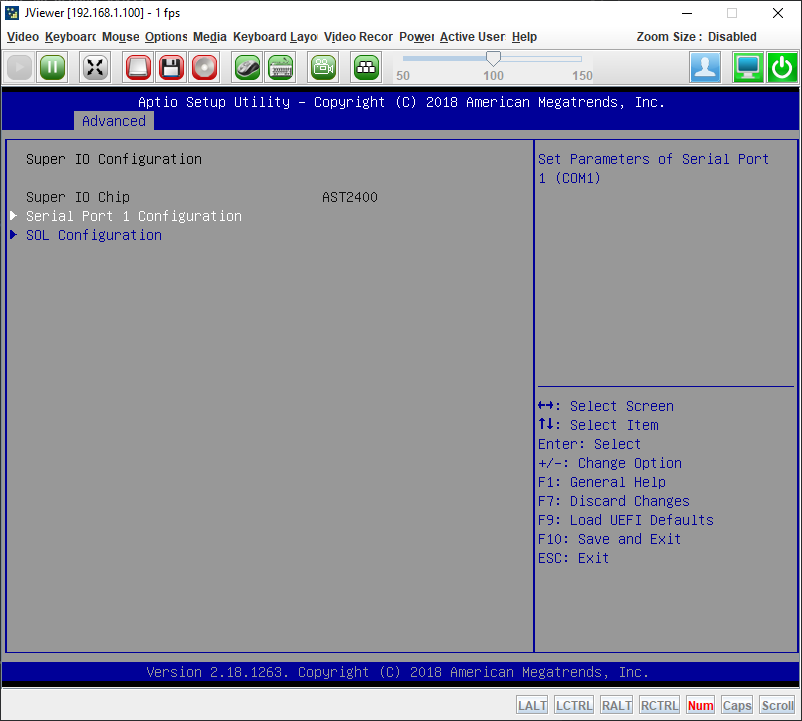

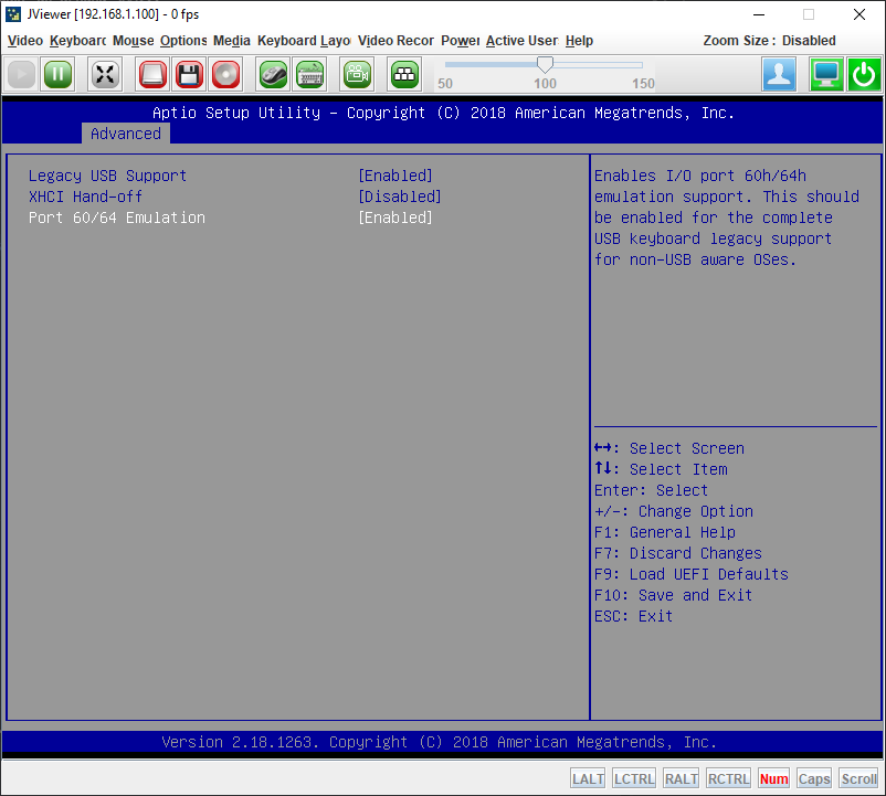

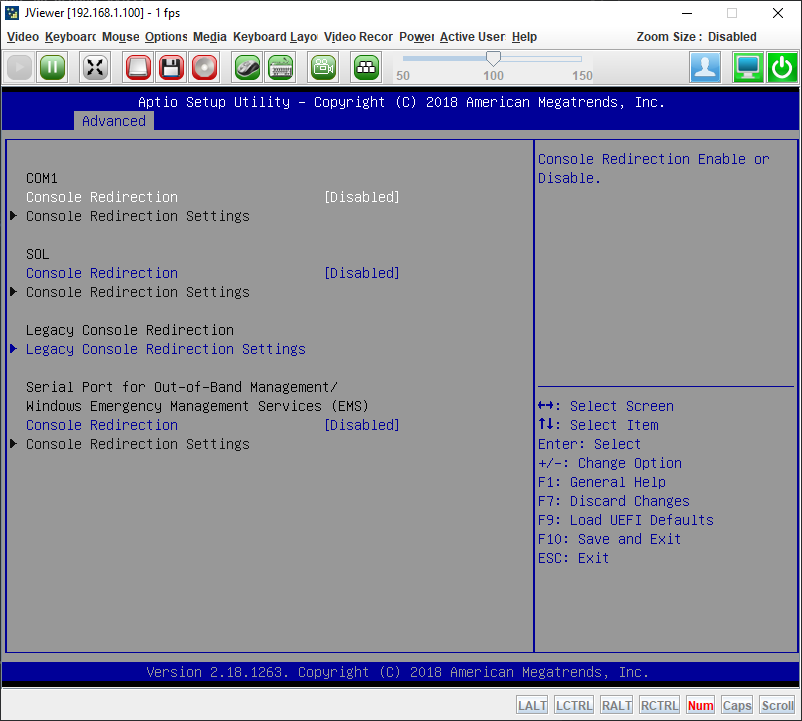

It sounds as if you have not disabled all floppy drives in your motherboard BIOS settings?    Also do you have a built-in SD card reader that is enabled?
Edited by itimpi

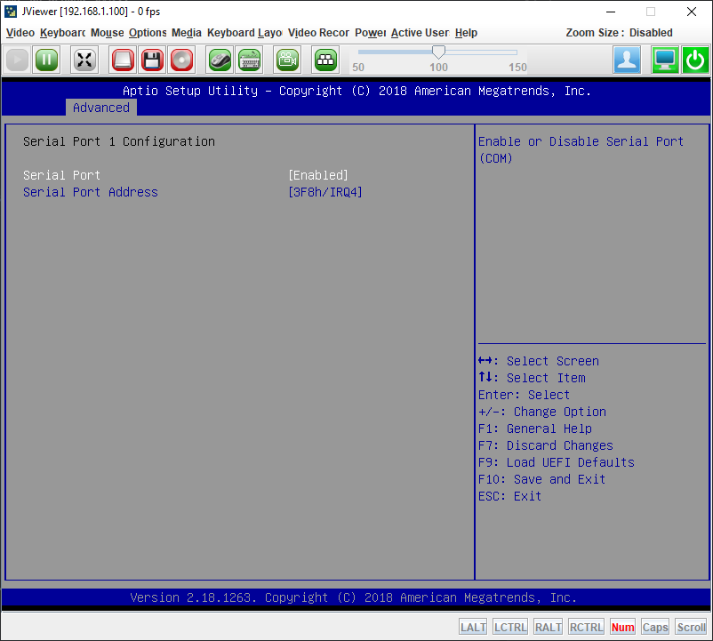

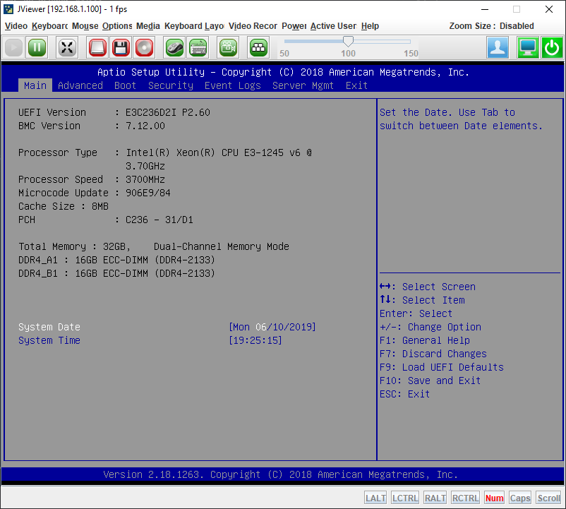

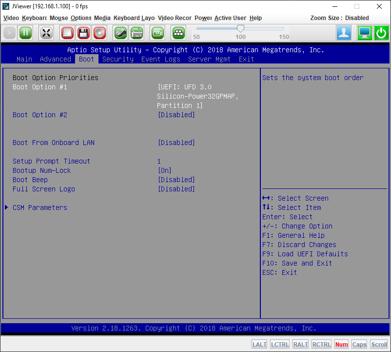

I don't have any "virtual floppy" (or floppy setting) in my BIOS and it's not consistent across reboots, ie. sometimes they're not there. Still, here are some screenshots from the BIOS just in case.
Main BIOS tab if that matters.

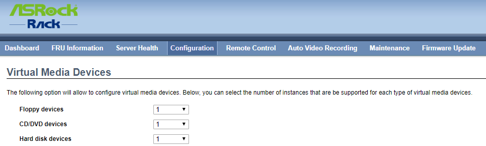

I'm so confused. (big thanks to... ASUS... lol https://www.asus.com/support/FAQ/1012437/)
Setting all 3 to 0 make 2 of the 3 devices disappear, then 1 reappears again. After a reboot I now see 2 instead of 3.
10+ reboots later the virtual floppy went to sdh instead of sdb. Considering I usually reboot 3-4x per year, I'm done testing for a couple of months.
But really, it sucks. ASUS says to enable the power saving mode to have the drives disappear and all it really does is making them disappear then reappear randomly. It seems that somehow I managed to boot and have unRAID see the disks as sdb sdc etc before the floppy but it's weird.

You are actually 100% right. Seems like the floppy was indeed created by the BMC setting but the 2 other USB peripherals were me on the IPMI console. Heh... well, the problem is now solved, thank you.
It's basically a mixed of the 2. I wasn't connected to the console when I did a reboot earlier... then the issue was there so I went into the BIOS through the console and just made it worst by staying on the console while rebooting couple more times. Then I found the virtual media settings on the BMC which made one of the 3 drives disappear permanently but the 2 other ones would stay. After I closed the console they both disappeared.
