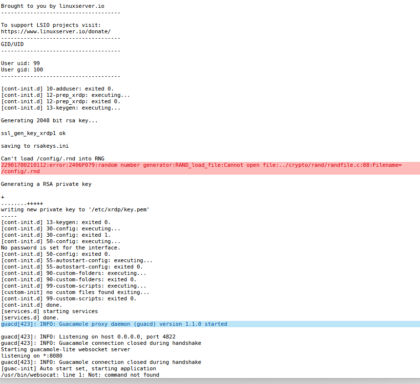

I seem to run into the same problem but I am not sure where to go w/ it.
calibre    | [20210714-03:04:11] [DEBUG] xrdp_wm_log_msg: connecting to sesman ip 127.0.0.1 port 3350
calibre    | connecting to sesman ip 127.0.0.1 port 3350
calibre    | [20210714-03:04:11] [INFO ] xrdp_wm_log_msg: sesman connect ok
calibre    | sesman connect ok
calibre    | [20210714-03:04:11] [DEBUG] xrdp_wm_log_msg: sending login info to session manager, please wait...
calibre    | sending login info to session manager, please wait...
calibre    | [20210714-03:04:11] [DEBUG] return value from xrdp_mm_connect 0
calibre    | xrdp_wm_login_mode_changed: login_mode is 3
calibre    | [20210714-03:04:12] [INFO ] xrdp_wm_log_msg: login successful for display 10
calibre    | login successful for display 10
calibre    | loaded module 'libxup.so' ok, interface size 8456, version 3
calibre    | [20210714-03:04:12] [DEBUG] xrdp_wm_log_msg: started connecting
calibre    | started connecting
calibre    | lib_mod_connect: connected to Xserver (Xorg or X11rdp) sck 20
calibre    | [20210714-03:04:12] [INFO ] lib_mod_log_peer: xrdp_pid=521 connected to X11rdp_pid=525 X11rdp_uid=1024 X11rdp_gid=100 client_ip=::ffff:127.0.0.1 client_port=45268
calibre    | [20210714-03:04:13] [DEBUG] xrdp_wm_log_msg: connected ok
calibre    | connected ok
calibre    | [20210714-03:04:13] [DEBUG] xrdp_mm_connect_chansrv: chansrv connect successful
calibre    | lib_mod_process_message: type 2 len 0
calibre    | lib_serdpClientConProcessMsgClientInfo:
calibre    |   got client info bytes 5744
calibre    |   jpeg support 0
calibre    |   offscreen support 0
calibre    |   offscreen size 0
calibre    |   offscreen entries 0
calibre    |   client supports glyph cache but server disabled
calibre    |   client can not do offscreen to offscreen blits
calibre    |   client can do new(color) cursor
calibre    |   client can not do multimon
calibre    | rdpRRSetRdpOutputs: numCrtcs 0 monitorCount 0
calibre    | rdpRRSetRdpOutputs: add output 0 left 0 top 0 width 1024 height 768
calibre    | rdpLoadLayout: keylayout 0x00000409 variant  display 10
calibre    | rdpkeybChangeKeyboardControl:
calibre    | rdpkeybChangeKeyboardControl: autoRepeat on
calibre    | 4.sync,9.276101301;
calibre    | rdpInDeferredUpdateCallback:
calibre    | rdpkeybChangeKeyboardControl: autoRepeat off
calibre    | 3.img,1.3,2.14,1.0,9.image/png,1.0,1.0;4.blob,1.3,256.iVBORw0KGgoAAAANSUhEUgAABAAAAAMAAQMAAACAdIdOAAAAA1BMVEUAAACnej3aAAAAdklEQVR4nO3BAQEAAACCIP+vbkhAAQAAAAAAAAAAAAAAAAAAAAAAAAAAAAAAAAAAAAAAAAAAAAAAAAAAAAAAAAAAAAAAAAAAAAAAAAAAAAAAAAAAAAAAAAAAAAAAAAAAAAAAAAAAAAAAAAAAAAAAAAAAAAAA7waDDwABtWbkhAAAAABJRU5ErkJggg==;3.end,1.3;4.sync,9.276101377;
calibre    | guacd[511]: INFO:    Accepted format: 16-bit PCM with 2 channels at 44100 Hz
calibre    | guacd[511]: INFO:    Accepted format: 16-bit PCM with 2 channels at 22050 Hz
calibre    | guacd[511]: INFO:    Connected to RDPDR 1.12 as client 0xe48e73
calibre    | 4.sync,9.276101536;
calibre    | 4.size,2.-1,2.32,2.32;3.img,1.3,2.12,2.-1,9.image/png,1.0,1.0;4.blob,1.3,256.iVBORw0KGgoAAAANSUhEUgAAACAAAAAgCAYAAABzenr0AAAABmJLR0QA/wD/AP+gvaeTAAAAdElEQVRYhe2VOxLAIAhEd5nc/8qkQcd8dNLIFuFVoAWPAUd4ABEGACShkrAWqCRsTBQSdj/IlngIZEu8CmRKTAWyJJYCGRLH7CJrDy8C7g6SPeeYbKKPIIqzdZ66hK347mKfic49Qu0rkKH+pouiKIqi+A8nWNBM/C9+/cYAAAAASUVORK5CYII=;3.end,1.3;6.cursor,1.1,1.1,2.-1,1.0,1.0,2.32,2.32;4.sync,9.276101608;
calibre    | 4.sync,9.276101858;
calibre    | 4.sync,9.276102108;
calibre    | 4.sync,9.276102359;
calibre    | 4.sync,9.276102609;
calibre    | 4.sync,9.276102859;
calibre    | 4.sync,9.276103109;
calibre    | 4.sync,9.276103360;
calibre    | 4.sync,9.276103610;
calibre    | 4.sync,9.276103861;
calibre    | 4.sync,9.276104111;
calibre    | 4.sync,9.276104361;
calibre    | 4.sync,9.276104611;
calibre    | Using O_TMPFILE
calibre    | 3.img,1.3,2.14,1.0,9.image/png,3.237,3.336;4.blob,1.3,8064.iVBORw0KGgoAAAANSUhEUgAAAiYAAABgCAIAAACmMi5JAAAABmJLR0QA/wD/AP+gvaeTAAAgAElEQVR4nO2dT2gbSd73f/vSA9VgQzVEoILVoQ9eaEECEkzADetDH/KADLNgww5E8OSghbwgwwzYsIERbA4ayIIME7BgA6tDHlAgCzbMQAQbePvgB9rgAQliUMPjQx38QAkUqAYLuiB9eA8ty5IsWS3JiZVJfQjBkrtbpZJc3/79rd+tpgyQSCQSieTj839uewASiUQi+VKQkiORSCSST4Ry2wMYRQAAQg0AAoAA0AcA8MWy6iN02yOTSCQSyeyMkZxAzHSx2SVB9QQCgA8AgR8+M3gtFZ2DLxVHIpFIPmeuSE4gNE5nvNhXwLE+LBYRUDsC+37vEcxwCYlEIpEsPMOSowb+yOMi8QFU4c/i/lLGnnNhbfkQwOeiREkdG4Zm6FjTACMVFPCEz5igZ6J+wumZN+5EFUGpYA7NRfWA2g4bd0qlZPY/3Co4/iQDdeexYaxovYfll836iTfut5cEIARw7tP3wnWZ886DYPJ4+k/3hM/bwqXCaTDGRowyqePtfHLC6AEAoPoLtQ/HzolEIllYrjrWZnKpzT2Kvlf1R44DLauqAv6oZW5xSK7gjYyuJ9Sh5/GSildUYwUyFmFn/o8vGiOFIZXEV7XXTMWvkZxPhwJoCciSShKqmdI2H/ill+5I5Rh3Ol5S8ZKq65BZI/avrLo/qzEtkUg+WxYifcBXAMGldYVUVcMoTpBGEIlrmCASQ2hJrRw0nfpYE+HWWbfIxgN94oyShIpU5IsRi7X5Nbn6pK6rJIZY+zZuBcaD76g7OaNQGq2dE1DAWiUeF2/sBZBSiUTyCVkIyQEAaz1J4qinLqCMGJqGVYAFlZz1NbKR0YeeFB2gjAsBCAEhCC8NWz/9aEvI0Ed5tADMFNl/ezs2gXPEKBMAoCJIGVjvGyHGauoecY6vk41Gg/sAqgLxGCLxgbefWdMnSE4AlI1284rOHO5fiURyewyv61wAdOa4njpjvMV8EMd3rluRASAeW9BYjp5AQ3ojOlD9ZdgmIwRZXxPLHGHKAICZ1gY+jeDywzHTeP/tjY44Mo3/4b1IzxubFfJGv+roceRce3pl3+2ZQZZJshuXs4SWgBB0jWuOMb/4vDH70CUSyeIxLDnMB28OySFIxJdmOZFxMVFyNLygkrM56E8THSiU6/yKK4wxUf2F1o6YGOWNWr0fv7yCAKfBrNWuOOE7qq5jSm/fwmu4Xr/koK+mONd22OYDHfV9PRBCtxM7lEh+K+gJlByZ7/NpaZ761yRG9TMsOUQFbSbNCEEqgiWsLk8Qj2GEz98LWJlwFNEWUXK0JWQYAx95tUav6k2Pkb8iZMDv5LrcqfOe5ACAldYqCyA5ePAjaPHpBIMLn/R5F72O1BuJZC7MFLHWRjtOPiW00ox45LDkaAjQHJIjliB+35yhJtRTJscqMFZBgZG5ubeIkRzQGyHAqU8dFR9KHHDeMUo9z/Mx7i7Q6buk8jO9xfeuIjBWsNU/zgCcBp/qCgRf6o3oAJ9SsSQSyRC6jm97CAAAEU0cuPn0AUWdrQcBjxIPVkBbRou2TpFBdx894zMIg3mv73sjoO56AFB/51lr3TUaLUHawP0FNJ+G/KPRhTJCQKXajPpZKEBiKJsZcD/WDicoKEmoI6t8RAfyT68PIUkkXwYK6GRKl9JHwHvv+5HDMYuSsea9F2HfgeshdxZOctDywEM+fSQsaWDcd/vfcLui1Tjh/SazmSafXnLG4RwzN4Kjb684ujLU+ZXJDGmJZE50ghZhCadnU6zJCzBeAABgfCBHaxxYW7g86fnjS6vpQa+a212Lm9QTnUs/Z8rQ1CWIfjfxUbHWSDqJiy/cae8APM+vvKbN08X6ECWSzxE9cfuJAwDQjOxVgyiSIwLwAVQA1HcsjmFPCM6FdkOaJTpCBAMvMRKyeElr3qBLcNrkCxWB2Z99EIDbvPz8nJPLvDVQYDVNPnGjF+fXi7ocBeIaSqdIrz8CvqPm/qyXXrhTXRBjdSOjs/+KoFVj6nLEqCpaieQLZGECOVPUyU1WjL2X2+y9Vynte21PXDjfCdF28hus7ZULldlGOYQIgHv+ULXgVfDileaw9wMroJ7QpspxSN0j/YZSw+X9GdSNdwN5a2Yq/oklp9Hk/d68g0NW/C7dUx1jRbu+tubgLYNAxGMoffdSq/SEup0zftyb0LlA1uVIJNejJxZgPQymyB2AKJLDmPdjoYIAUqZh/clstfn+i5r7jha2dnPbD+cY6TAeFxMlZwGtHPeUA/RVOCIw0xNq8vsxUwP3Kam72tjOmAB64pab3/C2oJT3J4XrRGNs7Ju1D2moKzWbFfLpnpOQxNWMpe/XZJs1iWRGVARkUi3jJ4Axf6qEqQiONeGHUZaG4ybv6dWqDedjlzykIG1ZQwqAAkhBoICqIFAAKX1TE4AAHwLwAyECgECIADyEmCeMSYPRFsJ1OQDnwj3l/d2XsxndpXxcaY4WQ+K8WwyqaWOb3IzD/Jos1EodsW84a4vqLzT38FKbM2vEPmKLlgwikXwu6ImF8Kq5/ztdXDbCRtSB8AMQAYgA4IMQFz+LD2N2cgvboylhKgWCKwH2nt7Axb6f4VlehJt3vKSqi5LxcMl+bSDfFy1BIW+k7w5/IQhB2W/00nYaqd0pMVPatAkcZvo2v2daDOmDGumdR3XjOnXG+n2+CmT+ePslbBLJZ8rVjvW3wlTpahDFyiEJslPsOtAMg2zr8TB8ixQQV+wpEQjOpygPvDyxI1iU2hwFsIb8BWurTM/EwVva32YNL6n5R0nRAXrW19YTD39FVtPx/oeNEz6yw3Ry5TKLGmM1qePmmATlH7ZS8GHE8wJgtrhI6g8aXlYBQFUAx5DZlz4AABCAS6f4LA5s2l/oY5nkwGb+mB4EhKjF71Ijf+X+ryf3PpB84SxM7sB0C/5kyUEKGL1UvI7QY+HPAgC5ZzcZyuZepMVLu7NwnfwB4I3NQEEbFumfUbQEQ71w+tETA01uvI6/93J09te6pW9kLo9cva+Nk5yxwbBZ2xaYq2RsZAmgdjhWMEZSP/FYqy9JRIHM2ng/oQJkzH2cJ5PWJF88xgJkSAsBU2yaBQBRJOfgte3Yo5dC05oYfJmCVltEKc2Ja2pzwUpzQt68pZTyhxl93EIZws78MJJjpgbLccZvBeScsI0Hl2KWvksq+7fZ/AYAIADbYTNElWqHrdyfL81ByyTT6pZEItE0FL0zGWv54uNs98FaUy/FkyVnnN4AQP3IjVJMExFfgBCTO7wtbD9pAGieeoXnjeQKNlYuNqJeUiG8F2hzl4q6y7sNoRUwhypAfx1rMvK2oGe8F0RBCMx7+BZ2qwvA6/isLSgVzsnozaQn4tTZpnW5UQVC1xo6EolkFPrvp1gGJxYkfEp+t5oasFRUwdD5iLUsDNsMqMtXkM1nKqVa/5MipscfzJI53Tpp+IwWv0tdbyIAQKPB96rTlR9KJBLJb4nNb/RMtAbS7L1feLZA9W0RYjlfQeahpa/EGye0Wj0iCgAAjuGdp5uc85sycUJanpgoOfjO4lo5EolE8gkwIheBTptR9rGZrBib/7m6kV1ltJW+Z5KYWvnJ3siu5h5b3nuv/My+2dFEqdIg2kKkBkokEsntoEzRXW2q1gCfgMmSY9zTc9myxzz4Crb/mtl7mTP0+Kuqvf/q6MZDUkPNY0aCEKgIFsc1KZFIJJ8SMk0DaUpnqVr5eEweOKVe68xDCsAHODp0MzH8l2yZMQ8A4CsYWQUyM1700pypYtcKUjUdxXUcMwCAHpZHF7FKJBLJwjNFenQAdKY0n49HFK0UsNwVVR9QtXrEOt1nrAeG/fomA1MsWmkOuXNdK0kAEABCEHRHT1sZRAykGQM5Dl6L1atzDlUikUhuhejdPOmUDdA+AZMlJ3U3/v/+nR/5q1rNteEmJcfjkUpzhnfNUZAa0/EdA8X0WpWKQIeAACActBBJ4Zg+dLr2e4PVb3DUEolE8umI3l2NRthH8RMzWXIaJ63Ki740gZ5mKpC8O7yaz0nE0hyCkRrT8UpGIzq6Y/SLCvrlQLS7n4fHgb9vXZUcRKaoYLUdueexRCJZHAR1ChEPzea2c0/SH3U00zJZcmpVZ1yDmY8hoazt60sTctK0GEo9qiA0Quq1OPbaFw8C7LWZMIb7iiLNAAXJcI5EIvnsEJ0p2oyh5YvanYCLTgs++BAIEYju6qcAAEIIwVcaQhiQdhO7HE8gwn45V/RGBOAHoEbr/TwtnicAJkhOXEPwYfTkYKLCSS8HAXHGIBCgDByKFFBjus9kPalEIvnMEOdTtOrw2g2/U4NzJoIo5gFCy1hd0pGWRFj/SPITKdXOSMc1ojmHVHCxsWls/jnlCyhXjpxDelMbUfdgXIzuHtyHhlXPdePLq1d/RRK4AZdpbx6DkcEhTNJSciQSyeeHN4WVw8+mKp0U4rwlzlvAjgCQFjMQMdHSDUdPJitGZl3Pb1sQgHhsFop2Lmc6DgWA4hMrS/cFu2HfWpR+0kgB4E3QR0iORgaUmXsgfA+h+PBhceOT7ucskUgkN4E/jZUzB4K3G9BuIM0gegbQjW1tNVlyzDVjZ+cNPWnpK7jwNFN4+sattwCglsSZB/rByxvu3tNqRyrNQcHoeccJAkoDgm6YR3AQHQ7asORMlUEgkUgkC0HAo7nIbgzBXcpdLWHhhHUjrrbJu4IyxhvHLfEB3KbnOLRx3Aqfd5ueOmqXtn5UpKrKdP1pIu6ag8RotxhSEI5dPhQdzR8VbUMxYyjAI5FIJAuO6LRu5XX5mc1OKgA3ELyfLDlCCF8BDsABPC78sNAyfPFJNTR+4MdjWEVd1en9cA0sLM2ZhKZ4QoxWe430Z7Jh76x1dZ7CDILJLyORSCQLg+C3ts2HOKc3ojoRSkEN4ry9dEM9zF7+XHtLJ1gKAbTanp6IowuxEcJv0mtnLQCv41/ds3kIrCHK3PiocA75vUrrl9453vavJq0BACbGTWUQNI6d6qsqPaXCF1jTdMPY/CaTum8CQKNRb75rZB/l5rl+rVZDClgPMr1nqtVKpVK17Rtuq3qLuG49n9sqV/YMY7HKCObBsqxcLpvN5uCGvgmSLxy/c5s7S4lzytwqMeb6Dk+WHPeUvXo9ulhfNybHlPzAb1KqLWv8nBNN8yL04+RcTJQcgpFDR2cQYIKhP2mtDeALWB6WHBRPAxxMHMxE7FqtWCwm06nc4xxa0hhjjSPHOXJCyWnWG6+q1TkXGrv2BiG1X3I0jei6tNIWHV3XNa37N3Ij3wTJl42A81tOexLc9c5snLBmvkKEjaj33XENzehp1EBWytCFIGgJe22vftq8/mD2HiYupziGPGd05oKW0AAuPxj+HoQQaPnKYcS4kRuG6uuqrut7e7u92Fo2m72xOtNR9hkAZDKZTCZz9XnJQlGpVG57CJLfEIKLm4imzAk/szFJgRK5teggEUpBxzfQHNeV4CqUsVbbAwB8xdq4ihdl15wlVbRGu8VwLA6Kc5m0dq4KwQFGJa0pMH/PO9ERRL9SNqUgACiXy/vVKgBYpgkAmob339SE4JUXFee44TGGlpFhJPP5PEl0Nbbyonzwy5tisVjZKzcpXV/PNJsudd3eRawHVuFpccCxFghrzdr6Ls/ee3btjfggjKSx/dcCIeRihLz00+7RoQMAq2vmupXZ3tkZ58LKbm6aa6v573Z6z1hr5tbj/EY2ezm8vxX2ymV6xjRN29jYyGazUSaqcexsf79TfFY8+KXm1uuggGVZ+e93EBr9lXAc+9XLKj2loEDqvpnP53vvyHGcg391PZlxQta/yWx8u9n7CGq12v7rauuMgQJxQja/zfbk+Zpr9nPwurr3omK/rYWfY7FQsG1796dSaLnWarXSs2Kt9gYtadePpOdYG/lNiDJpEkmPqYpAPybCozW8Eumv/ioR9stJx53j1kg/V+p+vHHcirIxKD1jyRU9rmneuWDtCfs3ROonrQACLoR3te0NUgAT5J11H4oO8jmDxHBWNAJQYzcQzjHuGrZtV6vV9QcWjg2sX7lHDyHwaz/X/lmtAoCqAAAIIYQvco+yWizun3sHv9T+kstV/1XFuHuuf+6Vnu3mv8snV3Q/EKqKCtsFtIy2/1oAAFUdvUBXKpWNzc29f1aEEMWnxUKh0LvFLhQKbtPNb+VJgjiHTnF3d5736597pd1yobCtr+i2fVR6VlRVtLGxGfH03b+X8t9tFYs/0FNaePojLxaLxeLVw2q1WqlYtB5YDx/lQIhKpbK1tVWt/hMhDQBaZzT1tbnx56yqIvo/bqVS4Z6Xe5wHgMaxUyoWs4+yprkqAkEpFYJHuWY/qftpeF5unDRTqTQANBp1FaH6r41Qcup1R18x0NKEkfQz8psgkUzFVK1uPiq87WJ9tANmIpO/+9lv9M2M7gcAV/5UuCfCGp2JJFf0eEzzOoJ5fKJt4UUrzcEYeeMyCPokBwC3Wi1yb0RK+Y1kEGx9n/fe80q5XCmXtRhOfW2ur1uplAkAaEnDSxoA9N9KY0y2n1x25TPXzM31Dfvf9sa3F3cNAexs58PVLZRTpCKkqCPvx3sYSaO30uUe5wo7O+yMkoTuntTrx41isWhaFgCkUiZvF2w2x3c3gPx3eeNuGgAymQw9bVYrlY1v1iN+/6zMehiUMu5q29/lC08K9NTVVwZvCAJR/mnPXDMLT7tqlLxrZL/N1n6uhbN0OVcAqVQavkKVf5Rzj3MAqHniajHcm4rwg4hyzX503dA0XK8fpVJpSinn3mZ2w6nXwzhM49e69WA9PPKakfRfcOQ3QSKZimlyBxBSEHyFQFEBfPCFCMSNpDhfIES7jog5+cArRLjdCgQEoAJAMCgV4T17AJGsHNpqnlJCCMEawRptMc7H2jpRd83RgLExPQgSGhxfXp+z0UlrKJ6cP4MAY1LaK1PqOk7dPWkc2bZdq+Ue564JFDuOffCvfUopPxcAAELQ/+3TAAVS6amztsL78RCSIADQYowk9Po7FxQwrcsvh2lZc6a6mfcvXyv1tbn/+oAx1vMNTjj368t+Run7JgC4bnNIcly36Xe8/mAVjhE9adQbjXCJ9zxerVbqTqPVZn7Q/Yp6HseY6IbBK16xWLCsTPpe1xaJcs0hjFS6cVyHHDQajq7rlrW+//pAdDjnHm97Zqr7Lq4ZSZTZkEgiI8T5uPt7hJaJuhRHiMAyQQiPDrQEXHRaglO/7Yi5g83Cox9LcvZrtFEfnSaQSuMoegMAqXsGQig0kt4cOul7yWskh59H2jVHw6o7xkbB8QF1EWOS1jSSuinnqK4bum4AZEWH73y3U6lU1v+0gfGID95xnMJOYX1zI/soh7GGFNjZ2enfWFtdxjNYrOrypYMx/FBCw9R7z7Rl3H/TrWlRN9sY/UII9Q9P0xAAtN5HlRysXc4JQggQYu3hPyTOPQAoFAoD8xCI5L1woReF7R3uebnHOV3XEUJHjrP3vOz7gDGYpll4WjjY3y882QGA9H1z+7s8SeiTrjmMmU6VfrKFEPXjRvp+yjB0FaH6u4b3noMCRtqYOBKJ5Aa56lVDalzFSaTpUVtwKhrCGsIG1i3B6pzW5klG8M/pbN/xCPvljNEbHsDRsRdRcugZIxgdnbV84QOAOL/WdRaA5/n4zqR+0jEkGqOT1khCA6C9j4F7IARHy1eiPjH9RjIIBq65pGX+lGk+c9kZHSk59tuabhjb25fxeW+8+s4PvkP4uQcgLmeDX5tnqKD+CRFiuDLXF0II3ot/8LYHAPE7UW/qWZvrKxcX73AQgsSGMztC+dx5UkjdHbB+VIQAgJ2xpusWSyXT7N1kDexpZD3IWA8yQvD6caNcruzsFKqvq9df8yrG12kIwK3XG/VmppABQKl0uvFrnbe95IoRvv2JI5FIboyL3AG0rGt3UihmzJwzBoAQMYmmM7cq/BnbGYhgYFWJzuTuAyOx1uLlZ6mNb/XrG970MHTChUj9QScxDQAmVIOGPQgmoWHkczayBwGKxQFdXkFw;
calibre    | 4.blob,1.3,8064.VXRGHaYgNTZvszV6Nvxe3KYLAF29QeAP2rCiI7Q+e6tx7PidSW9WARFEiG+NIn3PgAAc+3IpdK71qhGCKbv8FrrvRpRk2W8vr1B7a2sajh6isN9eZmrV3tYAwDCSQ8cYRlJdwu67Okno/f/C7AwhBAD0z+FIPyFCmrlmZb7JsDMKgbj+mlfRE7oWw9V/VX3hpdMpAEinUvV6o9Gopy78ihFHcjGg4W+CRBIdEYCmZ/T7P5C7eUTMOfTmAkTI3Ryap++XmOVeecbUGfuwVT9pZb+Nul67lGpLuNGkqaQ+MWMNAPh7ASsTjiEaAoCRGQQIgBDELrRACMw5i+sjXCjzZxAUvt/R7mBrzYoniOgIp+7YNds0zdDRpOs6BHDwumrcSyMF9BUjba7u/bTrOI55P+26zdLfd8fdaPfQV/TazzXn0CYxgvAU6zsAGHfT6fupH58V8x1OErpzaDfc8P2ONiKtB+ulZ0X7bc00V92mu1cuDx2gIlR5+Ur4Qtd1+78dx7a3drZDb5Xn8fzjrcw3mWvSphsnbnm3ZP7RbJ7SSqViWtZw7gAAQij//VapWPQ7wrQsbQlxz2sc11P309aDjK7rGiGVl68KBR0AqtUK7buDKZfLQvipVJrEMGOt2sFBOp0CBSEFrrnmyKGmUmn7rd1LTkul03vPywCQvgjkXD+SIa5+EwCEtWatZzIX6SRDD2FnK8/arerr/XHXlHw5zFN9ORZF0/6QZc0Zq8dEIGbQq9mzNT0O4kOkuzZVAdbmSEHW2ir3IlWPtiJYORiroIA/JoMA90kOAPJarZGZDvNnEOTzefvQ3v/lwGtzH0AnJPc4t3mx5pqmub65Ufmvqs/LYTXGxsY6b7d2/14snAs9oee3tysvhpf1IbLZLKWtH58WfSHCupypRlgsFkul3fJPZVBg1TTzj3PFp0W8NPrbkslYvM0qLyrFZ6XkilF4Usg9HsyDUFGxWCyXSk1KtWWUy+d7GdK+74UmxTWDKRR+2N8/KDwpgALrD6z898P5xBfDyJA7uPqqulss+gAkpqVTKd0wAAAUVHpW3C2VshubSEXmH8389zuli0zr1F3j4GDfsW1+7mkxYpqrvfFfd81RpNMp+62dvrBp9BVD0zA/94x7F9kT145kiKvfBIArKTmDD8WHSP0GJZKZQdhAanxm99oM/G41NejaFgydD6gCWgZxPvrkXE4vv6D967iI6fEHDwcuiNSN/7CqP79JrugAQC/COUO0Thp+n0SYaZJ7ODkcvfP3OtyxUpulq786ettwXl+aU4ZJrUfZq1akx9x65bqaEtv5rXnny+Vy7ef9N29rM/hhw1LQN2PKGO1abbdUqh7sjwxihaWglWpVtuqRSBYH78zmZ7MUJpN7+Rk2cItUl1NzRpVxfBX1NcJVGymqCPyH6xZl/KjeGCk8PRiPFLogGNExPQjig0lrXhuEL9DVTmsfIYNg0bBrNU/4uq7DB1H/tbH/upp7NFw4ciM06vWNbzdH6o1EIllMruZVRT3xI5WCGgba+NPoRNLa4WRzzBe+noizNncp9YUPATQpTRvJuntdpzUvWisdrKn+KRVCXG2aovWS1pQWBHHfAxAcriatKUjVDL/9m96UGqE3r6utM+YHghB9K58fWYkyP9uFwuSDJBLJQjFzJsJMJ0ZIkm7w3eejV2RrLR6t201rfc30hfDOhZk2mpSiMV1bevBOpNIcghEACOaiK6kBWIsjJEQgUhajDeSFSWuxERfB8d+45FiWZVk3E3vMPc5f7eYSkdR987fnpZRIvkyQgmZreDM5SXq/1mJtGPlvvxYp6OQL/82hQxnDy2jfdgDAqY/eDaEf9n6ybw3HEABwNvpqWgKRBNXT1vp3KbQMvD26ywsiw0m6EolE8qXgz1QXqM7YX2OykXJNzEVfQY26uN7QUZVuGTw9Y/RsitZeHhckPnnXHADwxvUgIEiLYZLQEcKb3wFn7sjKpZvaxUAikUg+O8Ztr3w96tJwBXdEZiwFBRUy/4GtryfHnYyVARsieg/dKJ3WwuYp4v1oyUk/0PWUGbaajid0PW2NtAMRmbcaVCKRSD5TfG+WsMIMuWoh09XlCIDUPZRZw1ZKAwD718kWmXtK19dMhBD3PHrGtJhWfzdhi7aQKBkEeEkFBfw2FYG4mj4RJ3r/JcblVyAFqTHdb0tTRyKRfGEEfLZteJD2MSVHBBBPwLqJM2saxqjh8t0KdRoifRdNTB/wA//NoZM2ktzjJKYZK4bbbPoRkpIj5UkrQDTE2kIwFyVGpNVFDG/heEpKjkQi+dIQM2VOITX+EXcFtdZQZg0bK2qrBbW3HC3Bvu15bQAA5zhqz6i62zTvpxGAd84BVIDJcsKjbWGg3UGsLTir41GSExFEknAy7y4GEolE8lkh+Nks+5io8al3V+kxOZajE6Qn1PIrnvmOVn72IirBwBUSBACc4/rRO5eetfxoHSpbPFK3j7imwvgMgohoMpwjkUi+MDzmiGCW3AEcm/3+frKVU3nt7dc8aw1VCnG77oGCpt1dTghBYlrGNFvnPK5p3ZrQSfidSPu/aWFpzpgeBBGRGQQSiWRxEO266LSwbn2MLiHdl+hQTmfpc4O0efZNiJax5p3DwRtReN4SHTDvQm4T4wQwAboOUTYvYG0OCnLPmH3ovHpjR9GbEB5hR2oSQwDdDIKIl71KmEEw8+kSiURygwiPcmaz45JoTy5hnIWA8WZ1tlO1+XpaT5Ox9gGcY+EcCz0BuQdYz4FLwT2NZJeJjkfPwNCTzGPRJaflCZKYUJqDcfcuYFwGQURw3JAZBBKJZBHwOxQAROCx01eodaTpmZmTkq8iOpQ3q7O51NCyPudIZqnLoWewW/EKz71wi6oo8HPf0AltMbSEVTRBRS7PirCFAdG6V+PzhXMQmT0gJpFIJDeH6N9NQJxT9q7MTlEuwKQAABBzSURBVMqiXZ82qDHiysxh7yqz6Q0AEH305lLRiZokfTWm4nHYfzuh9cDQRUgcx2PEe9/yo81blGpQhEBF4AvwWB3g4cTjxyF7EEgkkkVAdEZ0aRHnlJ1TRLFK0piszhBNER2Xn76ZZ2scLbYKcxtbkxUj/y0SADVHsLOB53UCsAxexPY8F69jHzvRdwrwIsRyQAGsIZ+JeTMI5t6RWiKRSG6A8bWZIvDEmc3PbKTGVZxEmo6wPiHFQDCPu36rPuc+bEiN45X1ea4QMllySAwqPw/rDQBQBvkHaLcZydDRljWPc+Z5SV1vnkY1J6JYOQBA7iDGxLgeBBFBSPYgkEgkt89IK2f4GL8l/BYwgLAwE2mqgkDRINzGRQgA3xcecCrm9cWFIGJkbyR9brJcUAb0it6E6DHwI4yCxDTW5gRjhJDfEUld94WgbPK0ejzSFgZYUwE8mDuDAMkMAolEctv4fLpVSPgt8Fs3IizjIMksoBlbRw8xOX1ABGJkJjT6CrQliJIJgBBWkdqkFAFoSxp7H9W+8wVESVAgF0lrc2YQYFmdI5FIbpeAzxzb/0hoiQzCN7Y2TpYcjEZ3pzHvAvMiedXoGcUaBgCv44EKKcNojdm65ipROq1pWi9POlLD0LHXkUlrEonkVhGduSIuN46mZ/B8hThDTJachgs7WWBioOqTxCC3AU60KiU9QbQlZJlpXdcpZfZxPUpbzxDv/WQzJx7rSo7XakS97ihkBoFEIrldZuvr/HFAJPkQk5vUG4gSy3HegZWCWhH2HWDvQUWQ0iFzH9wzsI8ivYYQwvM8XwhtSUMINFD5edRqUMbFxOCMhrvuvRvIIND0aR2pEolEclP4EXIHPgFIwSSZnT8l+iqRympKr2DTgqwFeBkAQAioOVCpgfgQ6TW8cxGPYQig7jZVpMY1HF1yonQRRQjUJeR3BNxIBoGUHIlEclsswPqDNIOsbMzTSO0aopWCfoDqv6H6byAaAADvRBWbEF/4LQZhzwFf+F5ninNbUUpzAOIa0A4AAGfuPLsYYGJwd5ZWdxKJRDIvgt1QTvOMIBVr+uYNJgtcZbpdQVnEws8r+IHvn3d/jm7iQPRdczCiZ6GVM2cGQfL27zEkEsmXiYK0hOWz+qdPWkOAVN3CxPx4vatDhtMHfAF8jn8AoCqqqqgqUlWkasvhP22YZS38VXiYqqjjMt9YtF1zSKwbzvF+W7sY7O6Wqi8rn+a1bNve+T4PAJ7HLcuCQABAdnOTunNN6Udl63HOObThJiaKMbZuWXP2sFrw6ZIsOoqGExlyf4ckc5qW+tirfwhS41oiQ+5vY/IR90roMbzSUx+8OfQ1lUDxGAYFVISQoiIVoe7PqPtSAYhA+EKIAIQvROD7QkAAHI15qwF4HR/jSf2kL/Kkfe7Ol0GAVY34fOoInv22Vn2936IUFGQk9cIPBRwj5d0SWlJzj/PRrzN0yurXaX3lE+2q4Lp1w0gCAIAoPNkBBXkeZ5zf7AAqL8r0jBWLxZu4mKCnNGkYcBMT5bqukTTm+ZP7GNMl+SJBCBsIGzjggrvCoz6nN273IAWpsRSKpW+wR3UUhiVHU0CdR+eCSG0FruJ1xt5dci7GSk7Q1SQ4v3xGtOk8xgqKp6aVHNu2Ky8qhac/GEbS49z+bxstawDgNt2HuWzkywgANHSKuXbDGYrX4L5zH2azAIAxsR4QAGg23eSKDhP0W0y1TLtuM/W1OddAL6CnFGkajhG4iYlyXde4m5znCtGmSyKJjKKhmIliJgYAwbryI5jwZ5cftKyrS3qk5mwfh2HJIepcoxDTxYYiwd6DrnfVRXR8xoTXFqzFGRMeE9wTwvdBUSHW60HQmKePwAwZBAcH+5vZDeNuGgBwjGxsZAGg8GSn6brl3XJ5t7yzva2v6KW/77puU3wQqftmoVBACEEgLMvKPc4f2TYogDWt/xS0jIrF3erranjY1uO8feiw962MZeXyeQAQQpTLe45tA1Jzjx5WXlT23wyPnFJaeVF2T5rig9j4djOXyzca9co/ypRS9BXKbKzncqFFJegpTd4zAGDn+3zmm03Lsly3ESek8GSnUa/HCSkWiyShA8DW45xxL03dJj2j1WrVfVevVCr0jMaJXnha0HUdABrHDmuxzDebQ+NxmzT7KDfwVCAqlYr91vbOfcsyt3d2QEFem42YLgDG2O7urvuuHk/opmkahgEA7km9O1EAW49zqXtp97TJWIsk9OKzYmjyHhxU96sH3rmfy2Wrr6qln8rhOC8H9q6ZSie3cjlKaep+uvC0GL6iXatVq9VWmxl/MAp/K4QK57puubxH/8eNx8jWznYqlQYA120YSQMAhODFpz9qGG/v7NR+eVN9/crjHKlo+68F07wZuZV8cSCCCEEEMACAAMFFqD2CQyAgED4ICACCi0i5ogKAijAoCJCGVIwQAaTdisz0c0UiPoJmzMmRw+gx85jH3gsxmHqAev/3xXtEa64MApVMfauLAOw3dvwOSd5LYdzNLMw+yrmntLq/Hz6klGYfPQzNoPz/3bJtO5PJuG4TAlAV2KtUAMB13f5TDl5XjbsGAISHIU3be1FmjGW/3czmcgih4tOChnF1/4BzvvWXnG4Mj5ye0Z3v8/nvdorFohA+Yy0AgA/ih0KBJIh70szntzKZDUJI12LABADcprv913ApbzLWKj4r6olisVgsv6gUi8VQnOKElH7aBQXZtl2tVApPC/qKXnlRKT8vlX4qA8CbX2paDA+Nh51RX3jG4DiLT4ugQOXlP4Uvcn/JGW/tTCbDO+LqdAnBd7a2so8elkpFx3YKTwuhB9JtuuFEhWPTdb1U2gUFst9m3Xo9dd88eF2139rlf+yhZa2wsy3Oha4PNYwS9NTFy2rxeQkB5HJ/qdXebGxs1g72938+KD4rajFSeLJdeVHZLhToqVvY2S78rZBKp6svq6Xij+FH5p40M5l1SmnxaWHz22wmk2kcO/s/H5Rf/BNjjTGmLt4fl+TzBAEiCBHU9xc2/Me2qHwGfwT0tMW4f6kuoMK1Su3N12mNU2faUwp/K1Qqld3nZc5Y2jQLhR8w1ly3Ht6Dh+i6DqADAI4RwzDCmxG36abTqY1vu560oVOarpu8l+oedj+VyWQAQNM0CAAp4J7U6Sktvq6CggghupFMGcO2Xfl5Ofswa1kWAKAlpK9oAJC6373RNu6mtWUcpgm4bjN8aXZG0VeIkFB7aPFpQdcNADDXrDA+T08pAOw8KYCCIBC7z0p7L3bDY6w1y7bt7pyMita4rqsndNQXt3NP6o2T+v7+ASgILUHqa5Od0XHTtf/6wLhrhJaTaZnwFJJJo3+i6CkFBUI7CQDQEgYAEYjKi8o/X1ZCAyW1Gr79gW9Q+KYKT39ASxoApO+vsjMKgSj/o7z3ohLadtaD9drP+wBQLu9lc7lwGq1MplKpQCBAQW6TplKs+rJaKBR0wwCA5ilVEfLPPYy1cEolki+cz0ByQEHXCPhFCMhXA+QrAFP2IBBCiLbL21S8dwVr8rYbqZPoIDhGtp8UtgEopTvf59/8fJB9lGs23X79qNVqtZ/3+XsPAFibrX+TAYCm65rWpadl6BT3xN38Nts9bK17GD1tkoQOCrIPj8y11V7kgLdZcmNj4K11eP3YKRS2B8YaiEql4hw6QggBwM89LVSXd+6Fk8oNraVwzU2Z3b5znsdJ16fUTN1Ph7LhHNf9QBSe9NRF6InrQpGu20zeHdBF+/DIXLN678LzvHTSGDdd9qGTe5S9eHc+AIQGU2+iXLeZSqcvriZalOp/0OvH9XiCkIuBee+ZccUcdN2mkU6HegMAnHvpu4ZzXMcx0vO/cc7iMSIEr9cbhafFiwEzTcOgoHC6Xr2sbl/oDQCsr2codf+Sy2FNyz3Oh9ovkXzJXJWchQt++hdj7KlL71eX4qCovcMgENdkEHicihb1267XdkXLnSE57Rp0XSd3SLjkuSd0fb2rAbZt7+/v7z4r4hjxPL7xzXro9O+tlSH9p3gdzjg3VvSLw7rPu03XuKsDAGdMN7qrIWOUnlL93sBbZm0PAsBLAyXEu8/34IMoV/YQ0pxDu1KphNrcdF1rPQMAjQtzx3VdHLv0/Nq2ncmsXwygW2zbatF0Ol0qlSLOj/vOzfxpYCNb3ma9Nd3zuFuvF/66PW66vBbr2QrO4VFoMA1M1KWHDXquQq/laLELCyMQzuFRPj+cQ+g2XXKne2MjBG8cO/l8rvFrnfT5Bu23TvZRlrc9AOi5T+23tmlZ4XQZ6bRlWeXdUvquEVpUGGuFQhFAVKv7lRdlKTkSyZW6HCXKdgRj8QHNYCUAAIjrqkw9BTzwRfhPUT1V9ZZVT1N5TOUxjRONxwaUkp923TtCeN5Zgx6/cmuFo8qm/SxdL68397foYZm79o3oTblcdk/qQgivw6vVCm2x9XULALw26yXaNY4d834ax4gQolTaJURHS5rocNZmRl9Obf8pzXduUtdBQReHdW/Mm64bepM0Qo6O6kIIr81+fFokhAypCyFERehgfx8CITqcnroAUHeOLMtCSPParFwuhxnGQnB6RsN7/2bTTXclp8kYc10XAlF9WfF9kXlgAUDzpDsAANB1w63XXbceXsQ5tMPbAMex7dqVFIxANCnVV/Qw2gmBABCEkKNDRwjutVmxUNj4dhPHyMjpAgASJ67bBADGWLlSCQ2m3kRdjK0rhz1XIY6T8L0IIXaf7zHGhiyt8MR6w/U8Ljq8+PTHzHqGEJ3Eidt06RkVQpSfl1SELMvUYhgUZL+tAQj7bc227dx/Znsvl8lkzD+ahUIBQLAz6p7UAQQE4L1noU67J/WD19XuCPt+rtVqjjO1R1ci+ey4mj6AeMwI/fvTXwwBAD221SnzrP0PAsYnSQMAjyEIUHQvID0st05tOPc+QY88Ifzi0x8Z55qKjFR6b68cBuHDHDMAtP/LQWY9U3z6o+s2MdY0DaO7OgC471x9xejPqe0/xXVd455x9bCeYZTNbhT+2tzMZIykYfzB4InhCUQIFZ8V956XKy8qOKblHuf1FWPzzxvFv+/q+oGeiJNY3LgXplrRboglEPT08nW3HueLT4teh6+m0ru7JVCQEIKeUePCukql;4.blob,1.3,528.0rmtfPHpj16b45hmrllhsvLBv/avJhy7pxSEyOe2es/slvey2YeU0s1vNrGmbX6zsZHdBICR0wUA+e/zpWe79lub/J7oiXjXUryYqKGxuRdeStNMW6vmX7LZOCFWxtIIwbGBsEp44s6TQi6bBQUymfVcLgcAqfvpzJ82d/5vHhQw16zSbhEAIYQKT3YqLyq7pT3jXnJvr9zNYXvnPszlACC/s5PP5crlPfNrs7S767U5WkbmqrmzswMAtTc1PxChxdr/c/VlNfsoej69RPK58rvV1GLV2y8a9udw77mVyz18lP2URTyfKZUXZSH8/Hc7tz0QieQLZfJ+OZLFxHFsACECUSmXQYFefoFkiMaxIwQHELZt12pvsg+lMSGR3BqfQ8aa5CqBqLyo/FgoomVkfm0W/15awLyPBcG27UKhgL5C+opeKu0OedUkEsmnRDrWJvBZONYkEonks0A61iQSiUTyiZCSI5FIJJJPhJQciUQikXwi/j+KnbED5bHzGwAAAABJRU5ErkJggg==;3.end,1.3;4.sync,9.276104688;
calibre    | 4.sync,9.276104938;
calibre    | 4.sync,9.276105189;
calibre    | 4.sync,9.276105439;
calibre    | 4.sync,9.276105689;
calibre    | 4.sync,9.276105939;
calibre    | [2021-07-13 23:04:18] [Connection 1]  Closing connection with error:  Error: WS was inactive for too long
calibre    |     at ClientConnection.checkActivity (/gclient/node_modules/guacamole-lite/lib/ClientConnection.js:154:24)
calibre    |     at listOnTimeout (internal/timers.js:557:17)
calibre    |     at processTimers (internal/timers.js:500:7)
calibre    | [2021-07-13 23:04:18] [Connection 1]  Closing guacd connection
calibre    | [2021-07-13 23:04:18] [Connection 1]  Client connection closed
calibre    | guacd[511]: INFO:    User "@842c9aae-1b1d-4d73-a12e-3fdcc5b89e33" disconnected (0 users remain)
calibre    | guacd[511]: INFO:    Last user of connection "$3ba63a85-51b4-46bc-9f7e-8251b16d6d25" disconnected
calibre    | guacd[511]: INFO:    Internal RDP client disconnected
calibre    | rdpClientConRecv: g_sck_recv failed(returned -1)
calibre    | rdpClientConDisconnect:
calibre    | rdpClientConDisconnect: clientCon removed from dev list
calibre    | rdpClientConRecvMsg: error
calibre    | rdpClientConCheck: rdpClientConGotData failed
calibre    | guacd[410]: INFO:    Connection "$3ba63a85-51b4-46bc-9f7e-8251b16d6d25" removed.

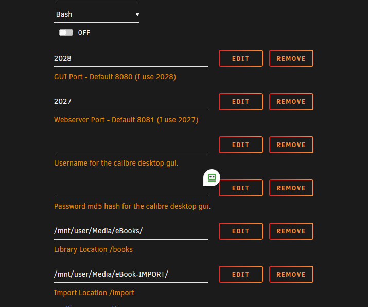

Hey Folx!

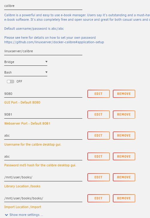

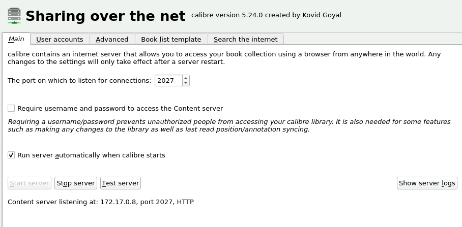

Very new to unraid and docker, and I'm having an issue I hope you can help me out with.
I've installed calibre (I used to use it in my Windows server before I upgraded to unraid) I have a couple of problems.
First, I used to use port 2028 as my GUI interface. But when I set that in the settings instead of 8080, it still uses 8080 and errors out when I try to access it via 2028
I use 2027 as my server interface, and that works fine.
The second issue is I can't get calibre to see my ebook directories. I've tried using the default container paths of /books and /import, and I've also set them to my actual location of /media. If I set them both to /media, I get the error "Error response from daemon: Duplicate mount point: /media."
In either case, no matter what I set the mount point too, when I launch calibre, I cannot see my Media directory when setting preferences in the app itself.
Can I provide any further info to help diagnose this?
EDIT: I think I figured it out. I'm learning. Looks like the default container needs to be unique for every location. Which is annoying, because that isn't how my hard drive directories are set up. Oh well. At least I figure out what the issue was and how to access the data.
Edited by Lonewolf147
New info
Where are you setting this?  The way to do this is to click on the icon, select Edit and change the applicable HOST port to 2028
and leave the container port on 8080.
Yes.  You're trying to point the same folder within calibre to 2 separate folders on your array.
You set two separate container paths to identical host paths no problems
This video will probably clear some things up
https://forums.unraid.net/topic/54834-video-guideall-about-docker-in-unraid-docker-principles-and-setup/
Here is where I make the port specifications, but it still goes to 8080 to login. 2027 works fine. 🤷‍♂️
3 minutes ago, Squid said:
root@localhost:# /usr/local/emhttp/plugins/dynamix.docker.manager/scripts/docker create --name='calibre' --net='host' -e TZ="America/Chicago" -e HOST_OS="Unraid" -e 'TCP_PORT_2028'='2028' -e 'TCP_PORT_2027'='2027' -e 'GUAC_USER'='' -e 'GUAC_PASS'='' -e 'PUID'='99' -e 'PGID'='100' -v '/mnt/user/Media/eBooks/':'/books':'rw' -v '/mnt/user/Media/eBook-IMPORT/':'/import':'rw' -v '/mnt/user/appdata/calibre':'/config':'rw' 'linuxserver/calibre'
65fa719111a38509b1aee130b9806fdd7d7065f34eac9b3894026f162ea57976
The command finished successfully!
Kinda surprised it even works at all.
  1. You changed the network type from Bridge to be Host.  In host, all port mappings are ignored as they don't make sense in that mode
  2. You changed both of the ports from being ports defined to instead being environment variables.
  3. You're referencing the ports of 2028 / 2027 when the app itself wants 8080 / 8081
It's easier to simply delete the container, then reinstall via Apps (not via Previous Apps) and add back in your path mappings to the books.  But this time, simply change on the template screen the ports to be 2028 / 2027
Actually, strike that.  You didn't do #2.  But, you did change the container ports within them instead of leaving them alone.  Advice still stands.
I have other things that use port 8080, thus I wanted to change them to be unique. Works fine in my Windows version.
When I've tried using Bridge, Calibre was inaccessable from outside my network. I had to switch to host for it to map to the correct IP.  I use a dynamic service, DNS2GO, to map my IP address.
I will try installing again. But the way you say to just change the ports sounds exactly like how I do it each time I install.
new command line:     root@localhost:# /usr/local/emhttp/plugins/dynamix.docker.manager/scripts/docker run -d --name='calibre' --net='bridge' -e TZ="America/Chicago" -e HOST_OS="Unraid" -e 'GUAC_USER'='' -e 'GUAC_PASS'='' -e 'PUID'='99' -e 'PGID'='100' -p '2028:8080/tcp' -p '2027:8081/tcp' -v '/mnt/user/Media/eBooks/':'/calibre-library':'rw' -v '/mnt/user/Media/eBook-IMPORT/':'/calibre-import':'rw' -v '/mnt/user/appdata/calibre':'/config':'rw' 'linuxserver/calibre'
970e2df8e39935400586ccbc11eabc8323c7c2c86fff1e933cb813829ef17b0a
I reinstalled, kept it on Bridge, and it works to access the GUI.  But, I cannot access the webserver. I launched Calibre, went into preferences, changed the webserver port from 8081 to 2027, restarted.
That IP 172.17.0.8 is not my ISP IP. I believe that is the Bridge IP. If I change over to Host, then the webserver IP changes to my ISP but the GUI reverts back to 8080.
The internal IP is irrelevant.  To access it you refer to the HOST IP and the port you've mapped.  General rule on any container is that when in bridge mode you never need to change any internal container port (8080)  That's what the port mapping is for.
Sure many (many) containers use 8080 for access.  Leave them in bridge, leave the container port at 8080 and change the applicable host port.  Now you would access the container at IP:HOSTPORT, but internally it still thinks its listening on 8080
OK, I can see what you are saying. Thank you for the help!!

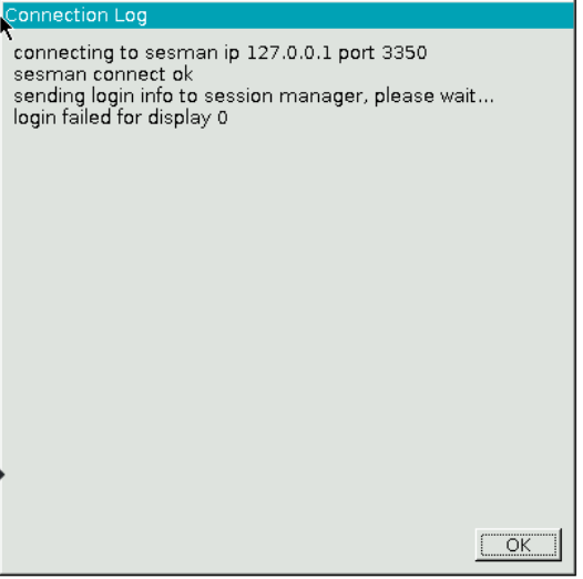

Hello,
I was trying install that docker but everytime I get this screen, I try with bridge and host mode with the same problem.
What I do wrong? thanks!!
Edited by milfer322

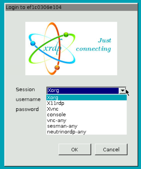

Hi all,
I installed calibre/linuxserver and followed all possible instructions, from Spaceinvader too, but nevertheless when I try to enter the Web GUI I see this:
and then there is no session "calibre" in the drop down:
My Setup is:
Any ideas?
Thanks in advance!!!!
On 9/22/2021 at 2:37 PM, Samuel A said:
Hi all,
My Setup is:
Any ideas?
Try leave empty username and password field.
On 9/16/2021 at 10:37 PM, milfer322 said:
Hello,
Anyone know why my calibre dont works?
Thanks so much.
On 9/22/2021 at 8:37 AM, Samuel A said:
Hi all,
My Setup is:
Any ideas?

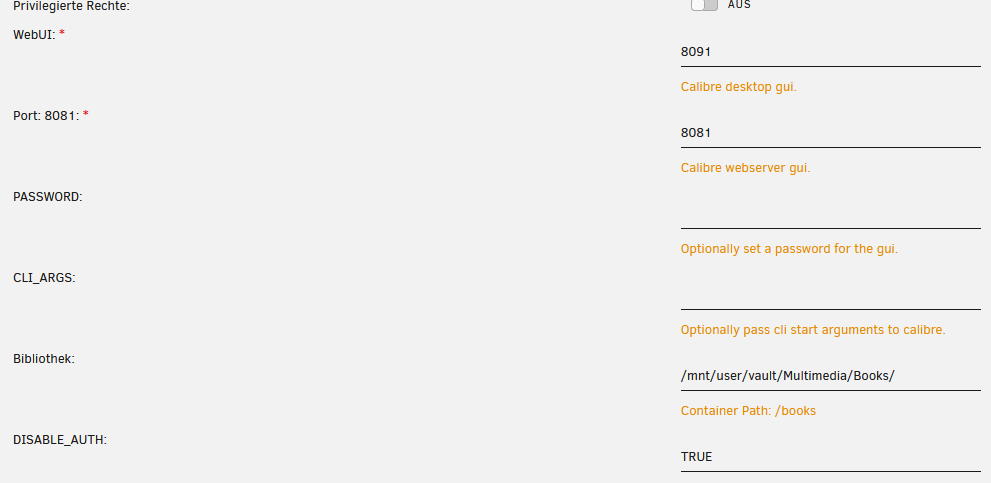

GUAC_USER and GUAC_PASS are deprecated. Try adding a PASSWORD variable instead (no need for MD5) and login with abc and your password.
Does anybody where the variables for the unraid app calibre are stored? Maybe we should request a change so that the GUAC_USER and GUAC_PASS are replaced by PASSWORD.
Hi
I just can't get calibre to autostart anymore either. After I deleted the old configs where GUAC_ was still in and redownloaded calibre, it worked for 3-4 startups, but I subsequently changed the config folder location to my nvme drive and ever since I'm back to square one where I have to manually start the webUI once (changing it back does nothing). I'm still relatively new to linux/unraid/docker, but I guess it says it can't autostart because it can't find the command? Any ideas what I could try?
(And not that it matters to me anymore, but maybe disable_auth true could be a good addition to the default template?)
