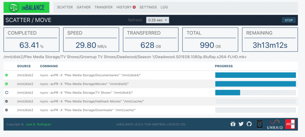

June 10, 20197 yr Hi guys, I've been running Unraid for almost a year now. All issues I’ve run into so far, I’ve been able to resolve on my own with the help of google and this forum. But I’m kinda stumped now. I’m running 5 data disks, a mixture of SATA and SAS drives (all 7200RPM), plus dual parity (both SAS), and a 500GB Samsung Evo 850 SSD as a cache disk, for a total of 8 disks. All of the spindles are on XFS, and the Cache is on BTRFS. The disks assigned are connected to sdc through sdj. When I first built the server, I had fewer disks running and only single parity, but I could get write speeds to the cache of about 130mbps or better; and write speeds to the spindle disks around 50mbps, as I recall (not exact, so don’t quote me). Not exactly impressive, but I’m not a speed freak either, and while I was not impressed, I didn’t find those speeds to be troubling enough to be concerned about. I didn’t go with Unraid for speed, I went with it for ease of use and ability to use mismatched disks, and easily be able to upgrade/expand the data pool. At any rate, I’m not overly concerned with performance of the spindle disks, as long as the cache does its job, and is maintaining SOMEWHAT reasonable write speeds. The problem is, it’s not anymore. I recently noticed (since upgrading to 6.7.0) that my write speeds are maxed out at about 30MBPS, no matter what. Includes the cache. I don’t know if this was going on before the upgrade, but I didn’t notice it before then. To be fair, I did move the drives to a new case; and am now running a different board with dual processors. It’s POSSIBLE that since I didn’t do any testing at that point, that that is when the performance started to suck. I don’t think so, but I’m not ruling that out, because I don’t have hard data for that. I've tried turning on Reconstruct write, and it had literally zero effect. (And it shouldn't matter for writes to the cache drive anyway). I’ve tried switching out cables on the SSD, and I’ve tried both SAS connection and SATA connection to that drive. The performance is the same regardless of whether it’s writing to cache or a disk in the data pool, and it doesn’t matter if it’s a network transfer, or done locally using a Krusader in a docker, or Unbalance. I pulled the diagnostics and in the log file (attached), I'm seeing a lot of references to a write error on disk 0 and disk 29. I've looked everywhere I know to look to find anything it would consider a disk 29, and can't find anything. I assume disk 0 is one of the parity drives? I googled the error and from the posts I've found, it's related to a bug with Unraid not being able to spin down SAS drives? Not sure if that's accurate, but it makes sense since I do have SAS drives in my machine. I’m sure it’s just something stupid (and probably my fault), but I can’t for the life of me figure out what is going on with it to cause such slow writes. I spent the past few days going through, cleaning things up, making sure only the data that I want on the cache drive is on there, and that there are no files stuck in limbo trying to transfer out of the cache due to insufficient space on a share. I feel like there isn’t anything glaringly wrong at this point, yet the issue persists. I’m in the process of trying to clear off the smallest disk to try and reformat it from XFS to BTRFS because I’ve read that it can be SLIGHTLY faster, but I already know that it’s not going to make a meaningful difference (cache is already BTRFS anyway). Desperate for any ideas at this point. Thanks in advance for any tips or ideas you guys might have! syslog.txt
June 10, 20197 yr Do you have some examples of other writes? The screenshot you posted is doing disk to disk inside the array, so those speeds shown are perfectly in line with what I would expect.

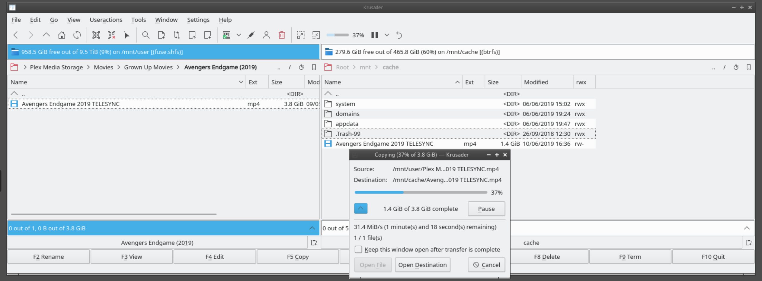

June 10, 20197 yr Author Really? That seems horrendous even for spindle drives to me. But yeah, even when transferring from data to cache, or over network to cache, the speeds are pretty bad. Here's a Krusader screenshot from a test I just did moving to the cache drive. It peaked at 70MBPS for literally 2 seconds, before dropping down to 5MBPS and then crawling back up to this and staying right around 30-31 after that.
June 10, 20197 yr First and foremost, you are copying user share to disk share. Be careful there mate. What speed do you get copying from cache to cache? Did you trim your SSD?
