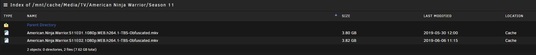

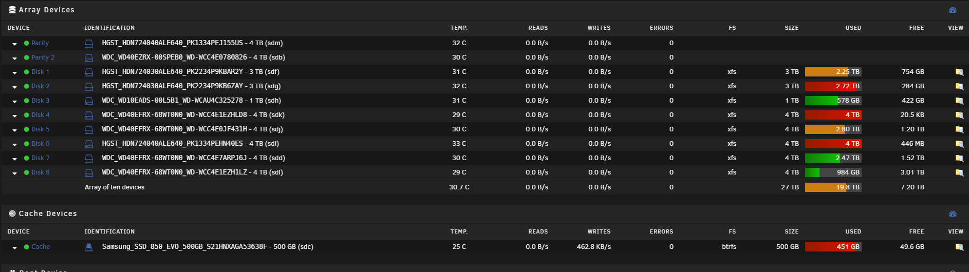

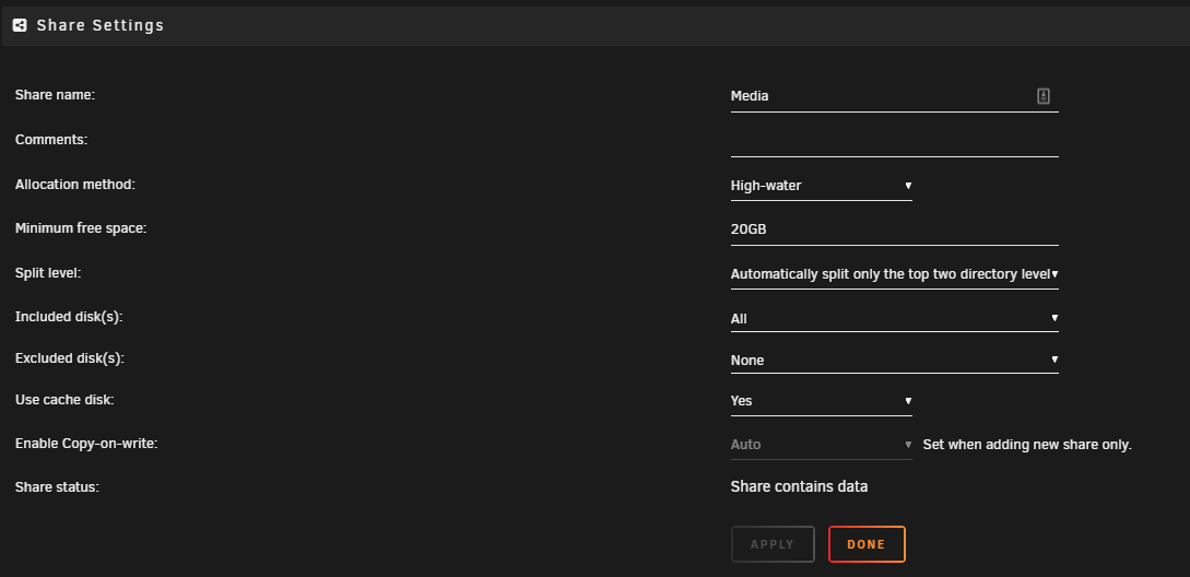

In any contention between the Allocation method and the Split Level for choosing a drive split level always wins.   You did not give the path of the file(s) in question so we can see if this likely to be the cause of your problem
Assuming that split level settings is the issue, you therefore need to either manually move some files to another drive to free up space or relax the split level criteria (or both).

For Media share, attached is 973282828_2019-06-11092215AMbraveTowerBrowse_-_Brave.thumb.png.c02cef9ca82eb51c416ed27ade7f87d3.pngthe folder structure example:

I think you're right, it's probably due to split level conflicts with movies and TV's different data structure.  Best resolution path?
With that structure TV and Movies can exist on multiple disks with your Split Level settings.   However once a folder has been created inside TV or Movies then its contents will be constrained to being on the disk where that folder is first created.
You need to decide how you want to allow Unraid to spread files across disks to decide if the current split level settings are appropriate.  There is no 'right' answer that applies to everyone as it is a personal preference.   Many people use different shares for movies and tv just so they can give them different split level settings.   As an example I personally constrain movies and tv to be on completely different dirk drives.  With your current settings for tv a series is always constrained to the disk where the series folder is first created - is that what you want?
