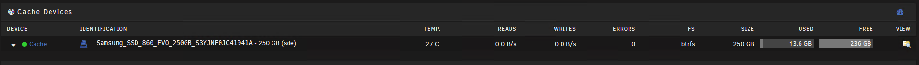

Running a single 250GB SSD as cache today, just got a new 1TB SSD to replace it as it's running on it's last leg :) From reading different posts, most people refer to this guide: https://wiki.unraid.net/index.php/Replace_A_Cache_Drive
However, a few times, people reference that his would take an insane amount of time as the Mover will check every file, and I have a huge library with hundreds of thousands of files that I'm guessing would take hours, with the array and all my dockers offline?
In a few instances, some say that just using the CA Backup/Restore plugin would be enough. I already use this on an automated setup, would it be enough to run this manually, then stop everything, unassign the Cache drive, reboot, assign the new one, then use restore from the backup I just created or will this leave me with something missing and/or needing manual configuration?
I do not use any VM, and after a search in krusader, all I can find on my Cache drive today are my appdata, an empty .trash-99 folder and an empty system folder.

Sorry for maybe naging this what I thought was a simple change, but is there any way that I can verify that my 1 cache drive is registered as a "pool"? My main page just lists the drive as before, but if I stop the array, I have selected 2 drives for cache, with slot 2 being empty. Don't really see any changes.
If it's using more than one slot it's a pool, but you can check in the syslog, cache will be mounted using the UUID instead of the device, e.g.:
not pool
emhttpd: shcmd (107): mount -t btrfs -o noatime,nodiratime /dev/nvme0n1p1 /mnt/cache
pool
emhttpd: shcmd (205): mount -t btrfs -o noatime,nodiratime -U e072aa60-33e2-4756-8496-c58cd8ba6053 /mnt/cache
