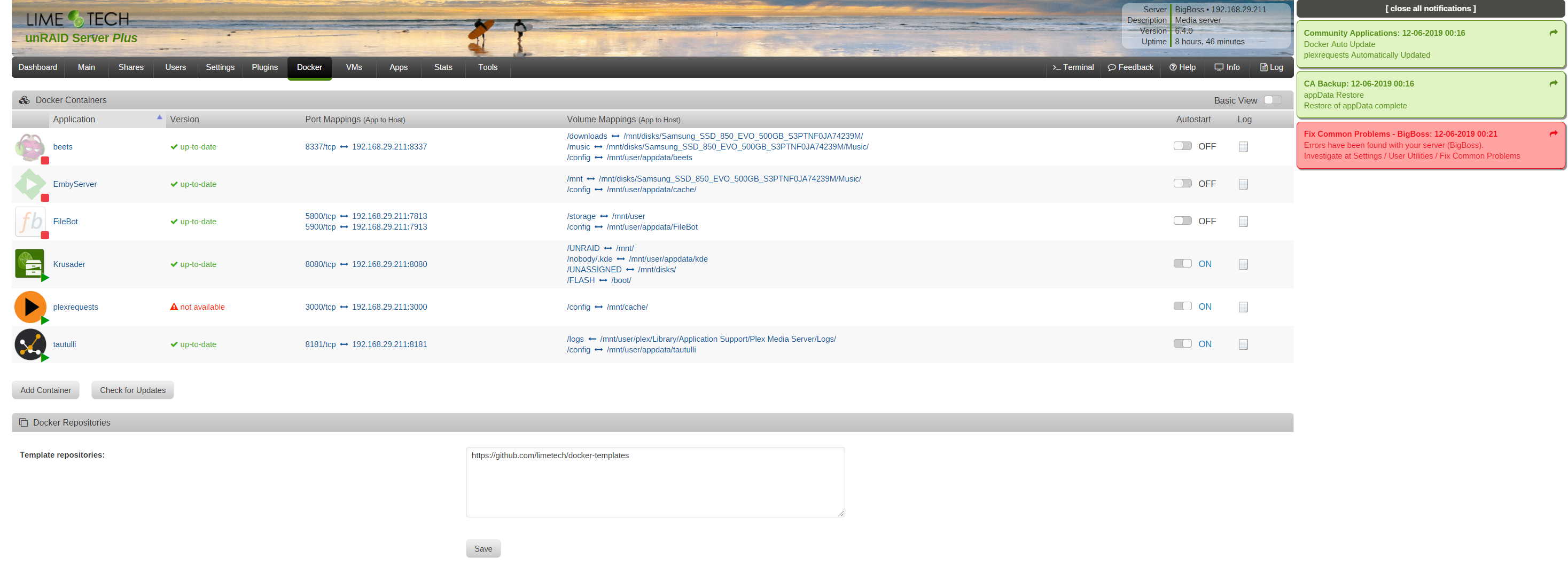

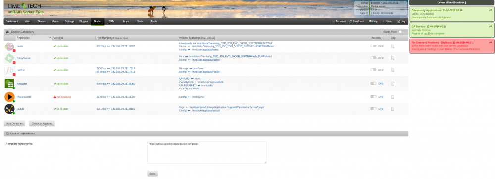

I was watching something on Plex last night before bed, when all of a sudden it stopped. I logged in to UnRaid to find that the docker for plex (and only that docker) had disappeared. All shares are fine, no data loss, unraid machine never went offline. I am totally unsure how this happened, the only changes I've recently made is to get a new router. Maybe plex tried to update and something happened? Also tried re-installing and was not able to do so. Im really lost. I've included some screen shots.

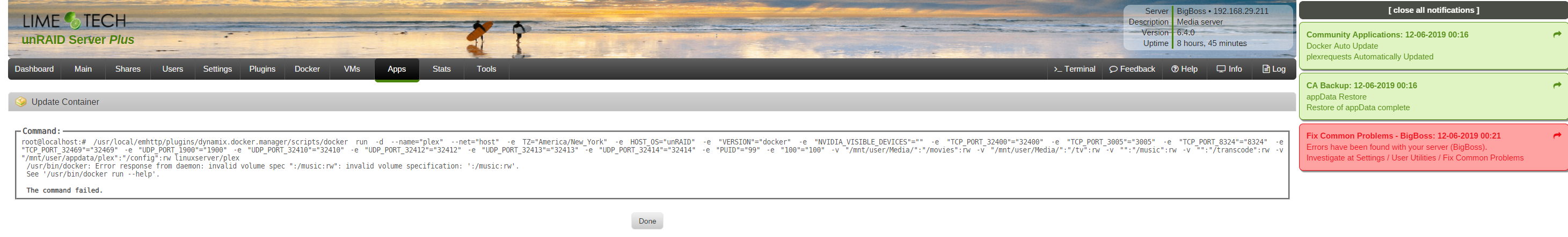

I get this error message when I try to re-install it:
root@localhost:# /usr/local/emhttp/plugins/dynamix.docker.manager/scripts/docker run -d --name="plex" --net="host" -e TZ="America/New_York" -e HOST_OS="unRAID" -e "VERSION"="docker" -e "NVIDIA_VISIBLE_DEVICES"="" -e "TCP_PORT_32400"="32400" -e "TCP_PORT_3005"="3005" -e "TCP_PORT_8324"="8324" -e "TCP_PORT_32469"="32469" -e "UDP_PORT_1900"="1900" -e "UDP_PORT_32410"="32410" -e "UDP_PORT_32412"="32412" -e "UDP_PORT_32413"="32413" -e "UDP_PORT_32414"="32414" -e "PUID"="99" -e "100"="100" -v "/mnt/user/Media/":"/movies":rw -v "/mnt/user/Media/":"/tv":rw -v "":"/music":rw -v "":"/transcode":rw -v "/mnt/user/appdata/plex":"/config":rw linuxserver/plex
/usr/bin/docker: Error response from daemon: invalid volume spec ":/music:rw": invalid volume specification: ':/music:rw'.
See '/usr/bin/docker run --help'.
The command failed.
